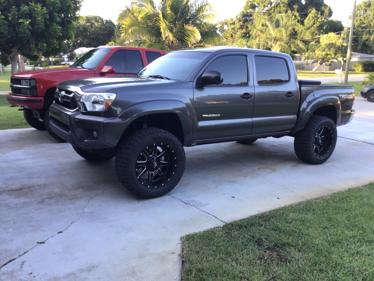

    Hey people of Tacoma world. Me and my wife are new to the Tacomas, so far we are loving this truck.
    BUT we are having a slight issue with the steering wheel when driving it. The truck has a Maxtrac 4” lift installed, all torqued to specs. Fox shocks in the rear and the stock bilsteins in the front. 33x12.50r20 with a 20x10 -24mm offset wheel and tire combo. (THE TRUCK LOOKS BADASS BTW)
    But when driving it above 45, every so often, the steering wheel slightly shakes left to right. Not terrible but noticeable. We had all the tires road forced balanced, one was out of round, got that swapped out. Now all the tires are perfectly balanced. But we still feel that shimmy when driving it. Ball joints, tie rods and wheel hubs have no play. So we are scratching our heads trying to figure this one out. Please any help y’all can give will be GREATLY appreciated!!!! We have a few friends that have 2nd and 3rd gen tacos with bigger lifts and wheels and tires and don’t have this issue. 4F522B6F-9BFF-4CC6-9266-EFCE330C3A12.jpg

    I see a lot of people saying wheel bearings. So I’m going to Change those out and go from there. It didn’t have this shake before the lift. So I am wondering if have the bigger wheels and tires are causing the problem to really show now with the new setup? Will change them out and post back when done.

    Update: I read about the “zip tie mod”. Said what the hell, ill try it. That got rid of all the shake we were experiencing. So looks like we will be changing out the intermediate shaft next weekend. to all of those who helped, THANKS
