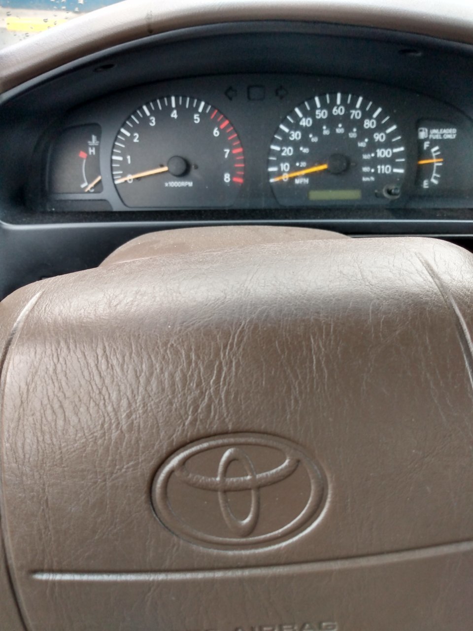

Steering wheel sits crooked when wheels are pointing straight.

    how to fix?

    Get an alignment. Whens the last time you had one?

    Your thrust angle is out of whack. As mentioned, get an alignment.

    Just bought used. Last alignment unknown.

    Sorry op. Having a little fun at your expense is not proper. It is true an alignment will solve that or you could simply drive on high shouldered roads and it will steer straight.

    With that degree of "unknown" a "process" should be performed to center all the steering components and then do an alignment.
    In a nutshell, in this order.
    Disconnect the steering column/shaft from the steering rack.
    Center the spiral cable (under the steering wheel).
    Center the steering rack in its range of travel.
    Reconnect the column/shaft, keeping it all centered.
    Install steering wheel straight.
    Do alignment, correctly.
    If steering wheel is slightly off at this point it can be centered by turning both tie rods equal amounts in the same direction. One direction or the other to bring the steering wheel to center.
