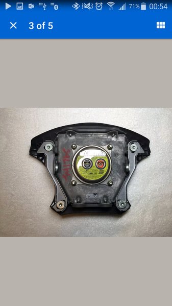

    my 06 has audio controls.... So what is the "bracket" Can you link me something? IS there more than one bracket?
    Does it have something to do with this? :
    http://www.ebay.com/itm/tacoma-tund...715736?hash=item211951db58:g:cXUAAOSwUEVYDZhr

    Also I emailed that company "oemcovers" to see if they could shed some light on the subject hoping to hear back from them by tomorrow

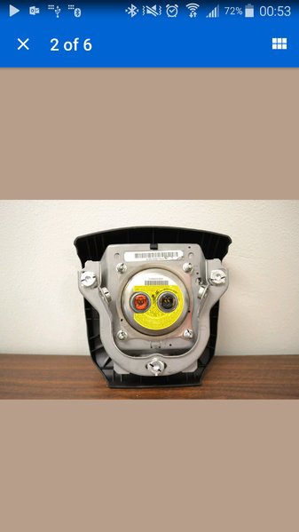

    #93

    Thanks for the pictures... to me they look like completely different airbags though? Are we certain the 05-11 airbags can be used with the 12+ wheels?

    Airbags definitely look / shaped different. The earlier is larger. Plugs are even reversed between the two photos.
    Don't believe this is the right way to go....
    Back to looking for 12-15 airbag...

    I did the swap
    $300 shipped I found a real Toyota bag I think on eBay
