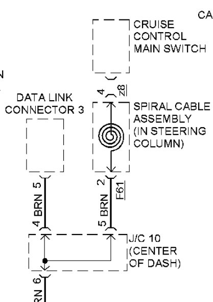

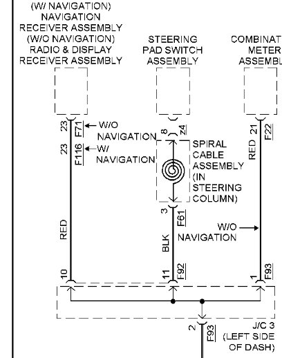

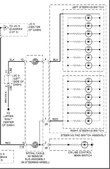

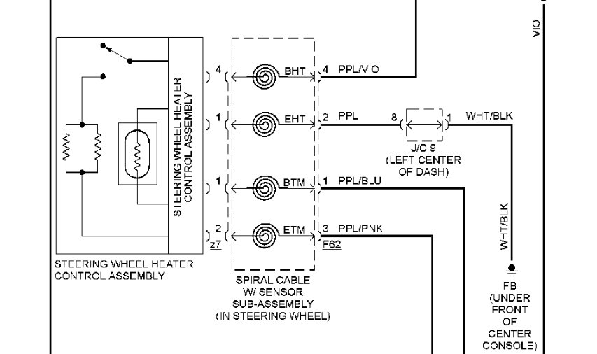

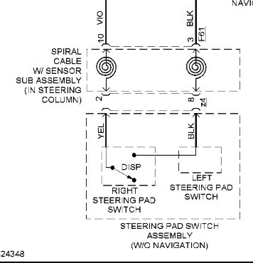

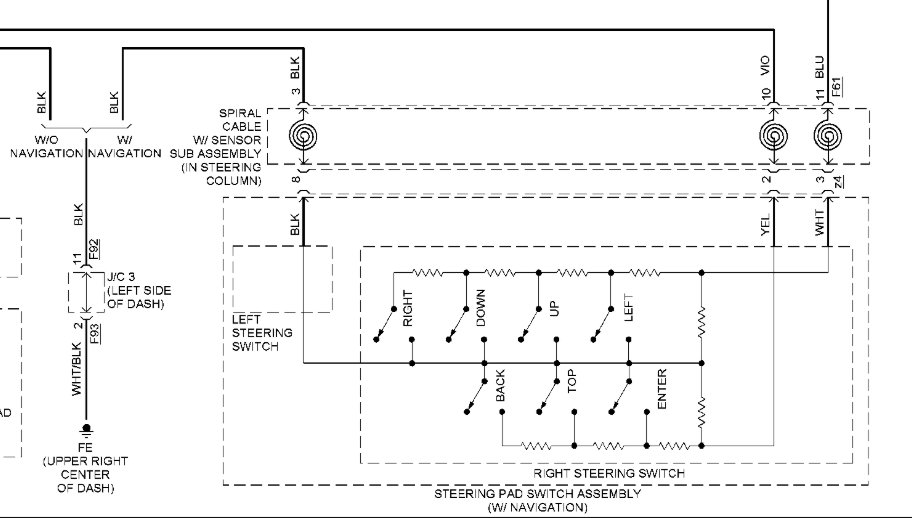

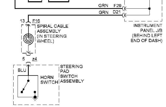

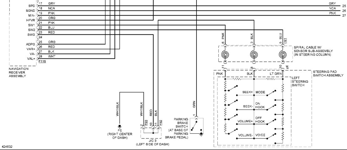

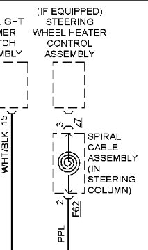

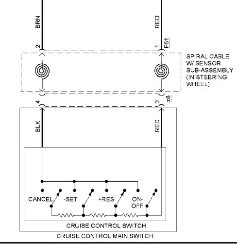

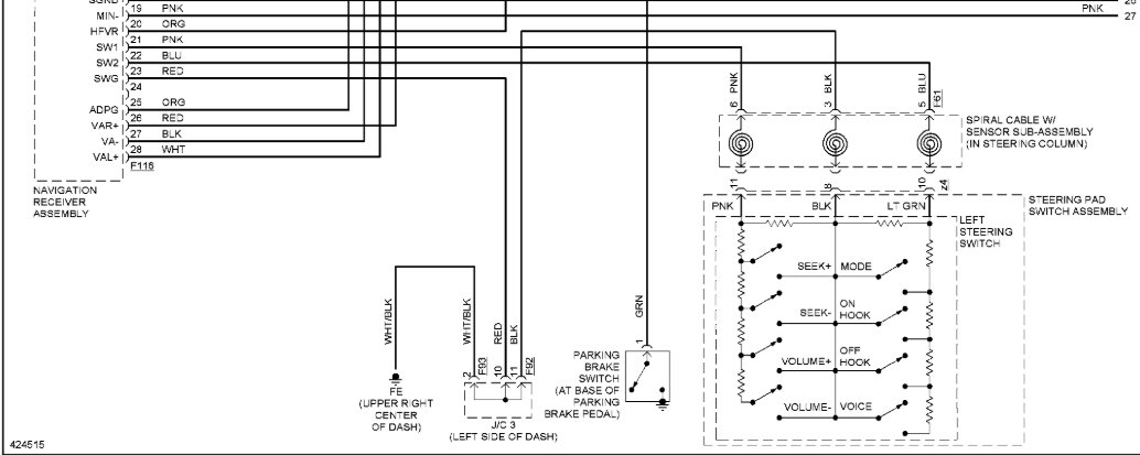

    Fits nice and I like the slightly smaller diameter (1/2"). The connector going into the clock spring is different so I'm going to have to do some re-pinning but not a big deal. If your curious, Here are the drawing for the 2015 Highlander steering wheel controls and clock spring.
    Horn
    Cruise Control Ground
    Steering Pad Ground
    SW Heater Ground
    Cruise Control
    Instrument Cluster Controls
    Steering Wheel Lights
    Navigation Controls
    Heated SW Circuit
    Audio Controls

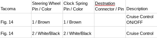

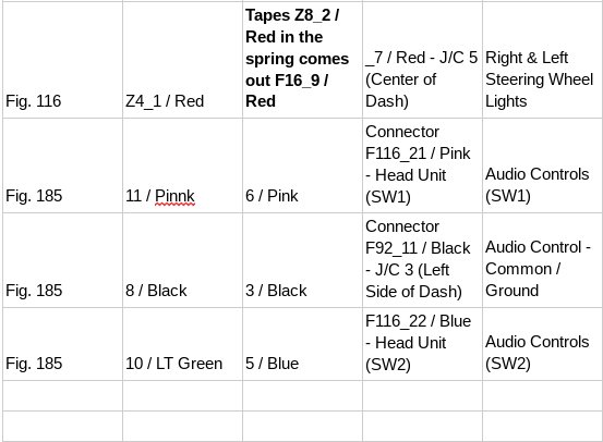

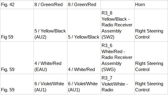

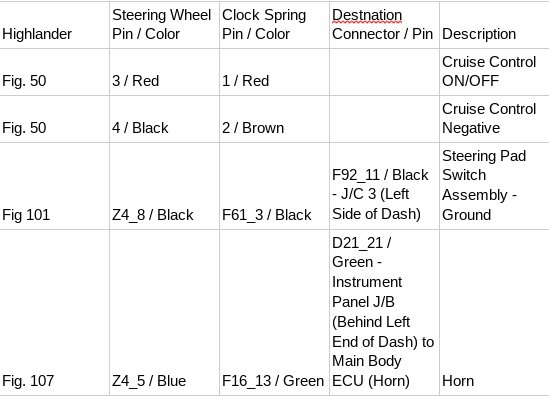

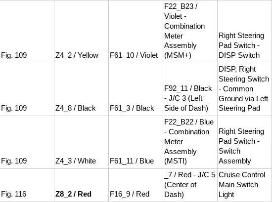

    Pinout for 2015 Highlander Steering Wheel and 2009 Toyota Tacoma
    Screenshot 2020-03-09 at 11.08.38 PM.jpg Screenshot 2020-03-09 at 11.08.58 PM.jpg Screenshot 2020-03-09 at 11.09.23 PM.jpg Screenshot 2020-03-09 at 11.09.50 PM.jpg Screenshot 2020-03-09 at 11.10.21 PM.jpg

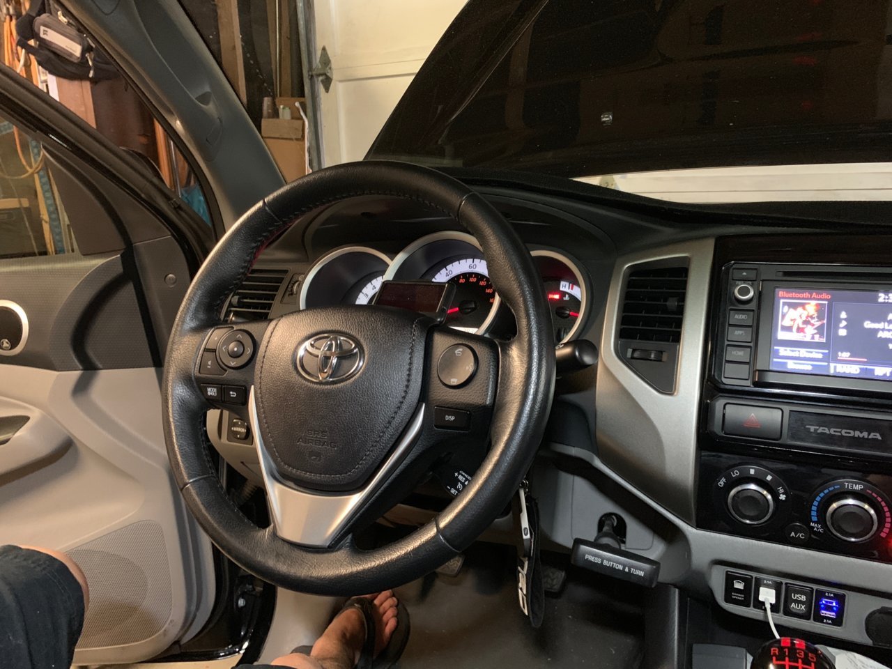

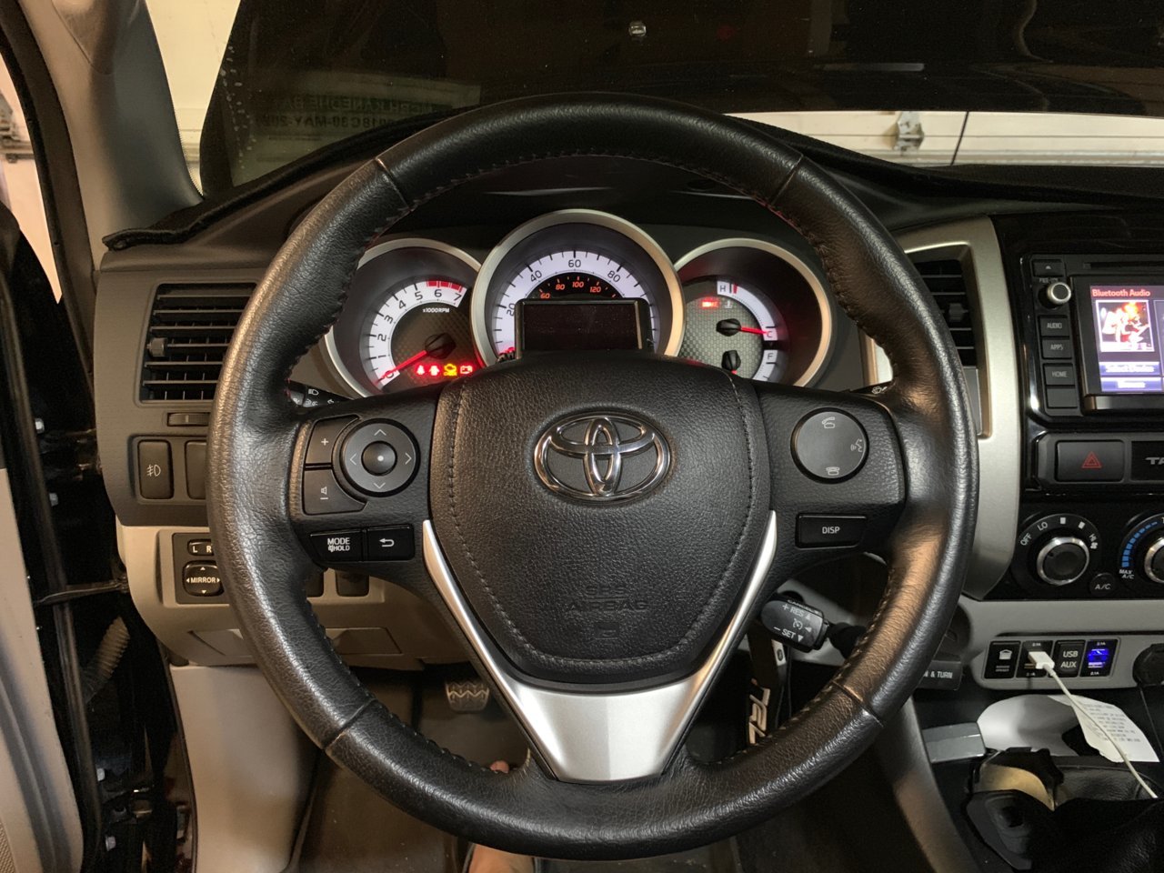

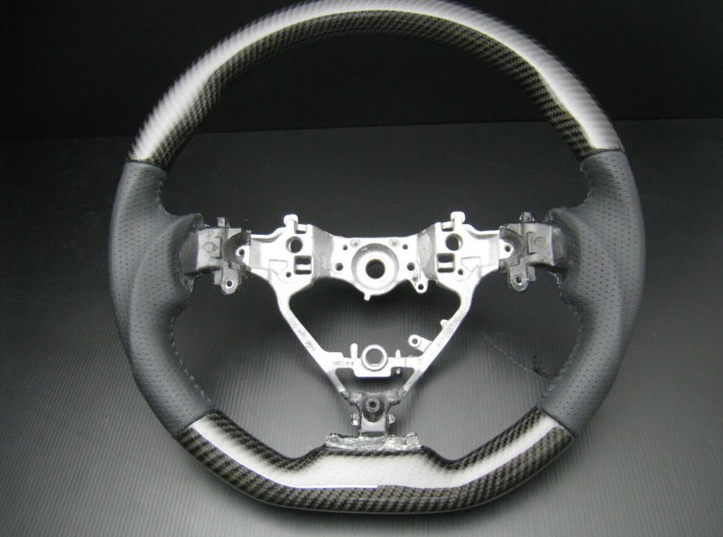

    I know you already have your new wheel but if your interested I have a 2016 corolla wheel on my 2015 and it was plug and play. All the buttons function like normal, it's also smaller than the stock wheel.

    That was custom made for you wasn't it? I can't find a wheel that nice off a Corolla at all.

    It is an aftermarket corolla wheel.
    This is the stock one.

    I started with the factory corolla wheel and air bag. This setup was plug and play for my 2015 Tacoma. I bought the wheel and airbag locally for 250.
    I then replaced the outer wheel with an aftermarket wheel from ebay for 250. This was jus the outer wheel, I transferred the factory parts over to the new carbon look wheel.
    Link to the wheel I bought,
    https://www.ebay.com/itm/MIT-Toyota-Corolla-iM-2014-2018-Carbon-Fiber-look-leather-steering-wheel-SPORTS/112890372544?fits=Model%3ACorolla
    I was impressed with the shipping, from date of purchase I had this in 3 days and I live in Hawaii.
