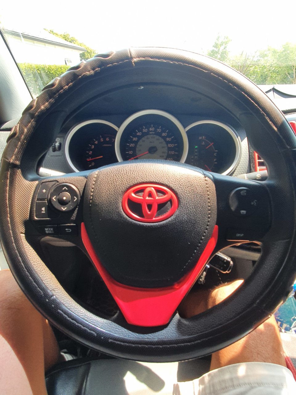

    Finally got all the parts needed and did it this morning along with red wrap

    Didn't have steering wheel controls on my 07 Tacoma

    Looks good! What is that out of? You have more red trim to match?

    I believe it's out of a........a.....................shit I don't remember. Brian did a video on it a few months back (maybe more...time all runs together the older I get lol)

    How'd the install go? Care to break down what you used, the parts needed, and any hang ups or tips you'd have? Any airbag lights?

    The steering wheel looks like it came out of a Rav4.

    Parts list, 2014-18 corolla steering wheel and air bag, 2015- 18 Toyota Tacoma clock spring & steering wheel wiring harness. Used the original Corolla steering wheel controls only had to change the harness to match the clock spring. All buttons work except for return & display buttons. Have to see if i can get the lens to light on the steering wheel. No air bag light on. Took precautions to start vehicle when installation was finished, started it with remote control which I bought from 12volt solutions.

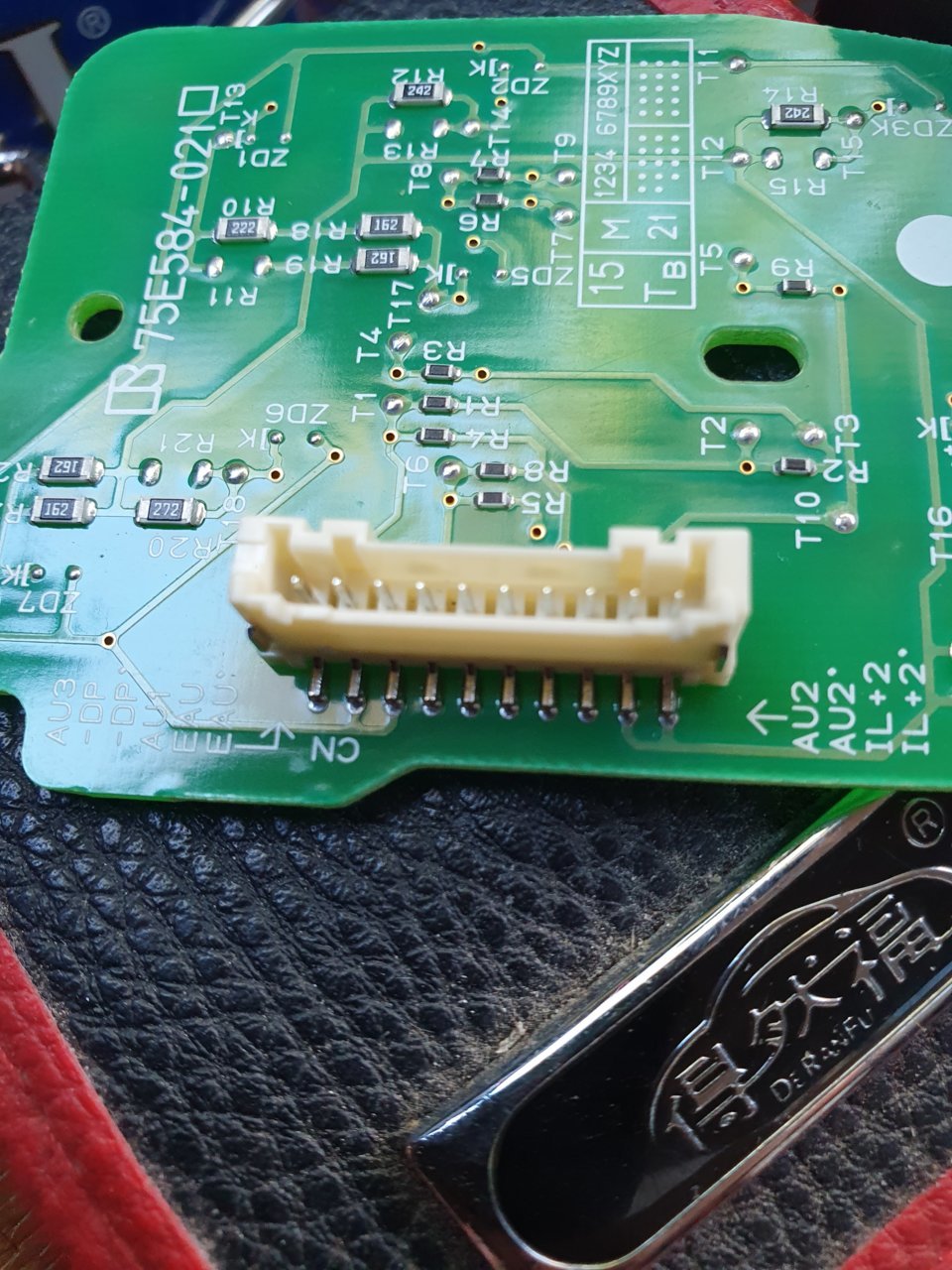

    Was able to get the steering led lights to work, had to add an extra pin. Was unable to getting work with illumination from my head unit so I connected it to acc, that way it lights up when I turn the vehicle on,it’s not that visible during the day but it supposed to be ok in the night.

    About the red wrap,i got a guy here to print the red for me which he laminated so it doesn’t fade, bought 10sq ft

    by chance you take a pic of which pin it goes into to light it up? did it to my 07 w/out controls but no light

    On the clock spring outputs to swc1 is usually ground & #4 is positive, I changed it around to match my steering wheel controls. On the clock spring input # 1input is a solid green wire which is ground, I repinned to positive & added a pin to # 4 to ground. Did all my testing with a multimeter before installation. I first opened up the swc controls and tested the illumination with a 12volt battery. The leds are polarity sensitive. You will notice that on the swc controls 2 pins are bridged, one is +illumination the other is -

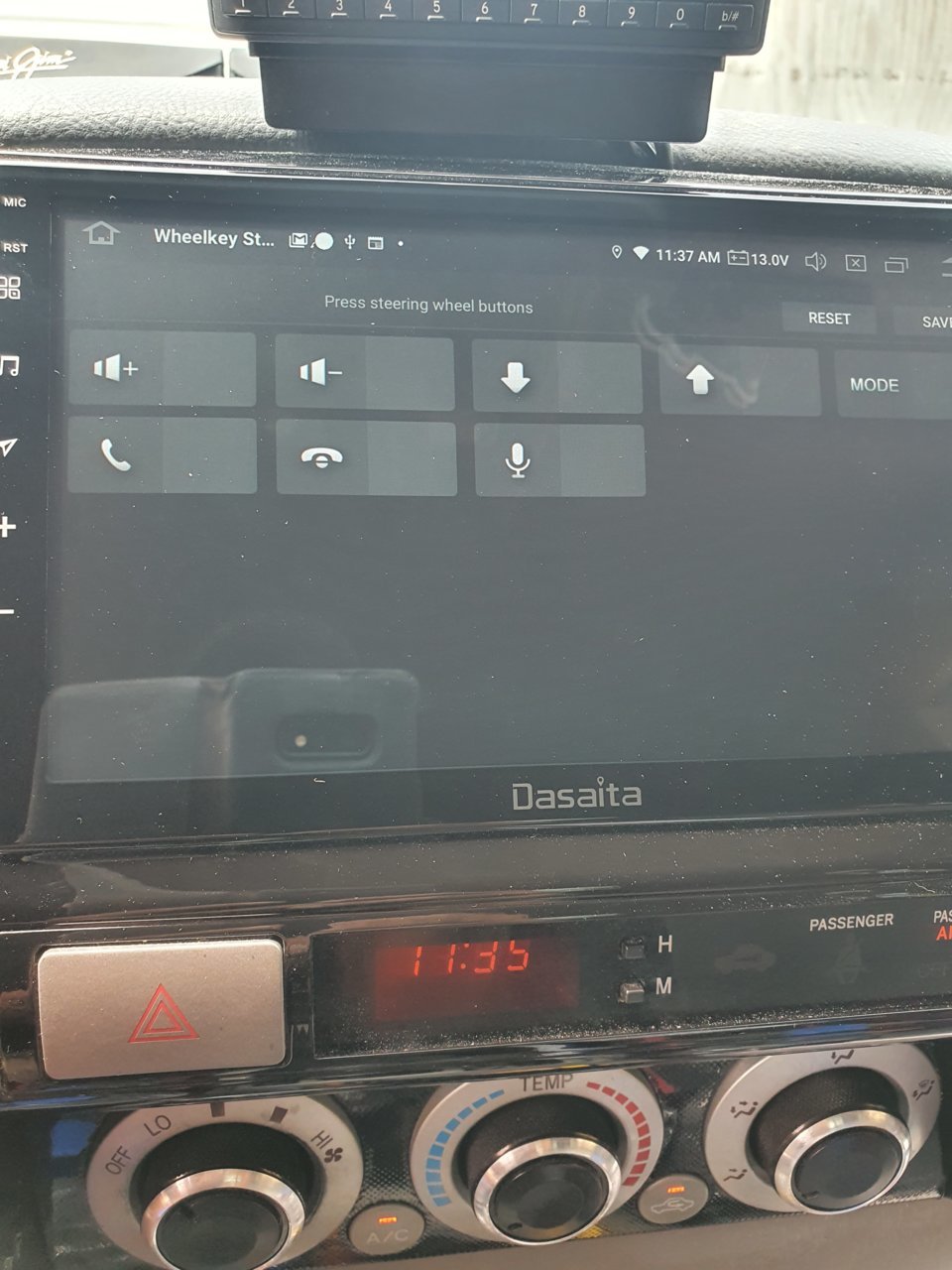

    I have a dasaita head unit and the swc controls are programed from it

    whoa...i'll just have to leave it off and remember which buttons are which at night :annoyed:

    My head unit
