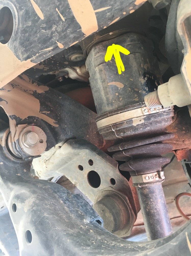

    so just crawled under to see if there was play
    There is a little play where the yellow arrow points to. Not much but a little

    ZekeR7
    ZekeR7 Well-Known Member
    Jan 19, 2018
    #241779
    1,280
    2018 TRD Off-Road 4x4 Quicksand
    Honestly, it will be hard to tell from the exterior. The only way to figure out if it was the needle bearing is to actually replace it and see if it goes away. I would just go ahead and do it if you can. The bearing normally only last around 75-100k of regular driving until it starts wearing out (with a lift and offroading it wears a lot faster). Might as well replace it now with the aftermarket bushing that doesn't have that problem.
