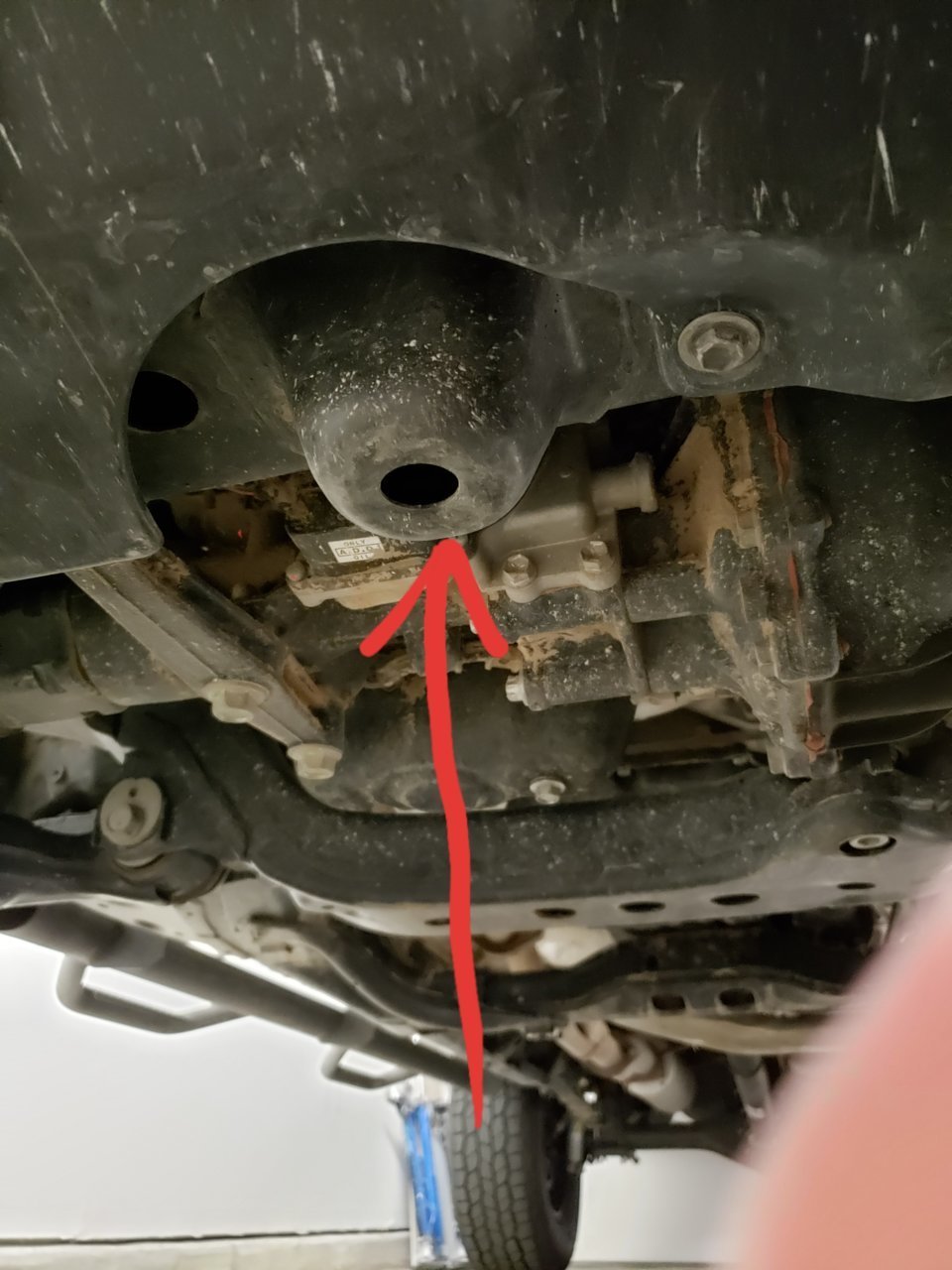

    There is a center jack point in the front if you want to lift the truck up and run the steering rack back and forth to make sure nothing is binding within the rack.
