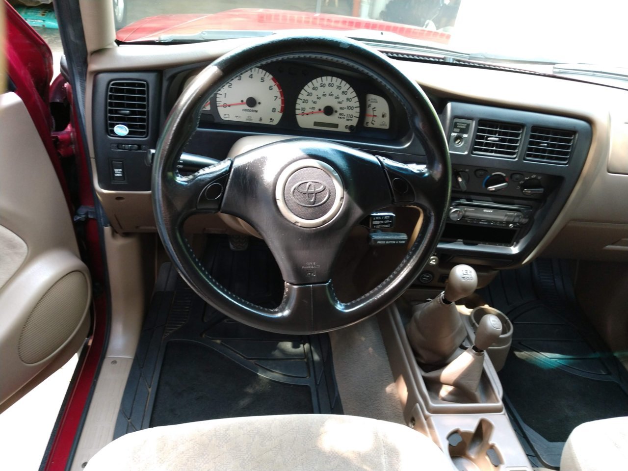

    A 01-04 Lexus IS300 will be plug and play to your 02. Horn and cruise will work fine. If you can find one out of a manual car, it wont have the button shifters. Otherwise you'll have to disguise them like I did. I used an airbag from a 2002 Rav4 so Id have a Toyota emblem, again, totally plug and play.IMG_20190728_160808626.jpg

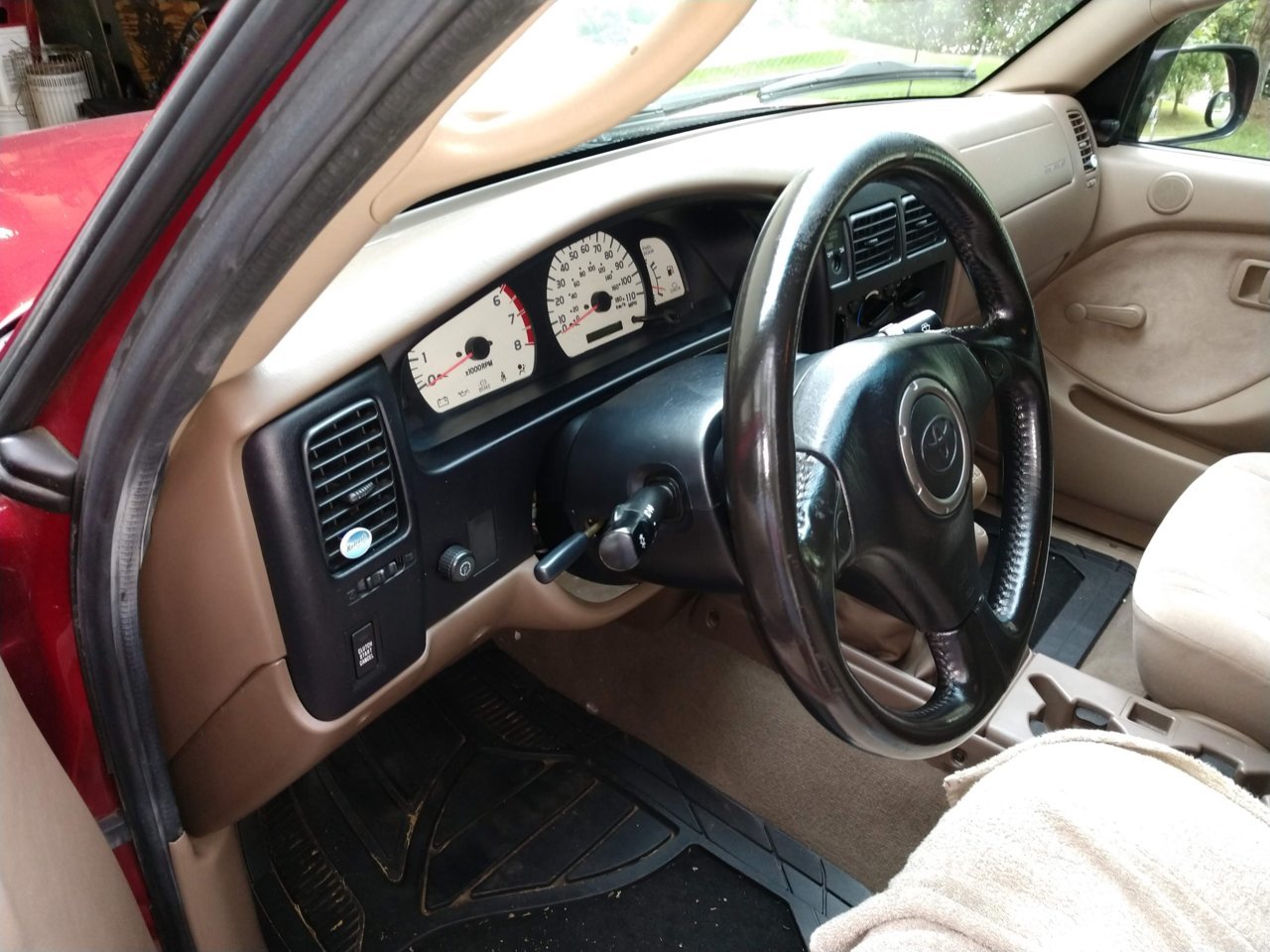

    You can use the black 4Runner column trim and it will work fine in your Taco too so that it matches the wheel.IMG_20190904_180443977.jpg

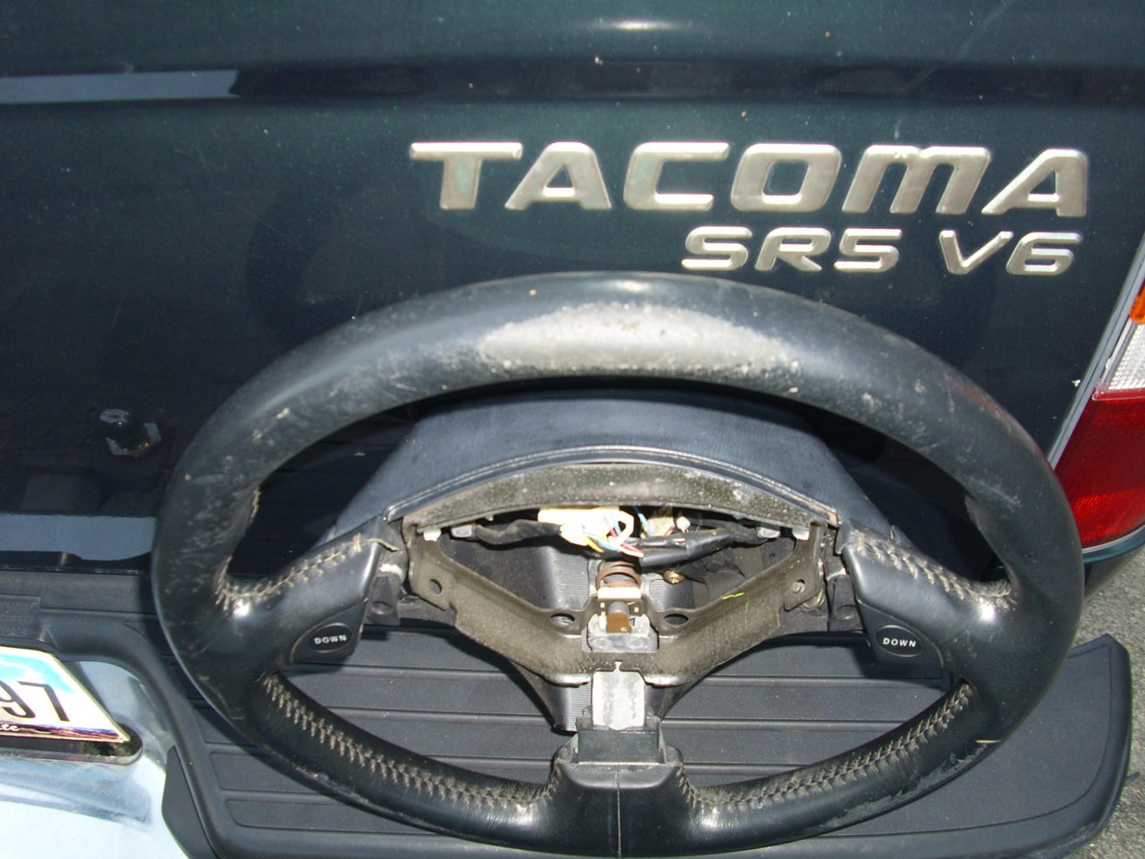

    I have a IS wheel if you want it. It's just ok shape considering it's sat for years and years now. No bag. Would need Rav4 bag....or IS if wanting Lexus badge. Much harder to find.

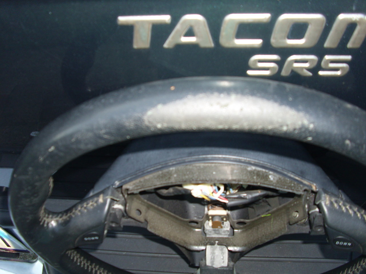

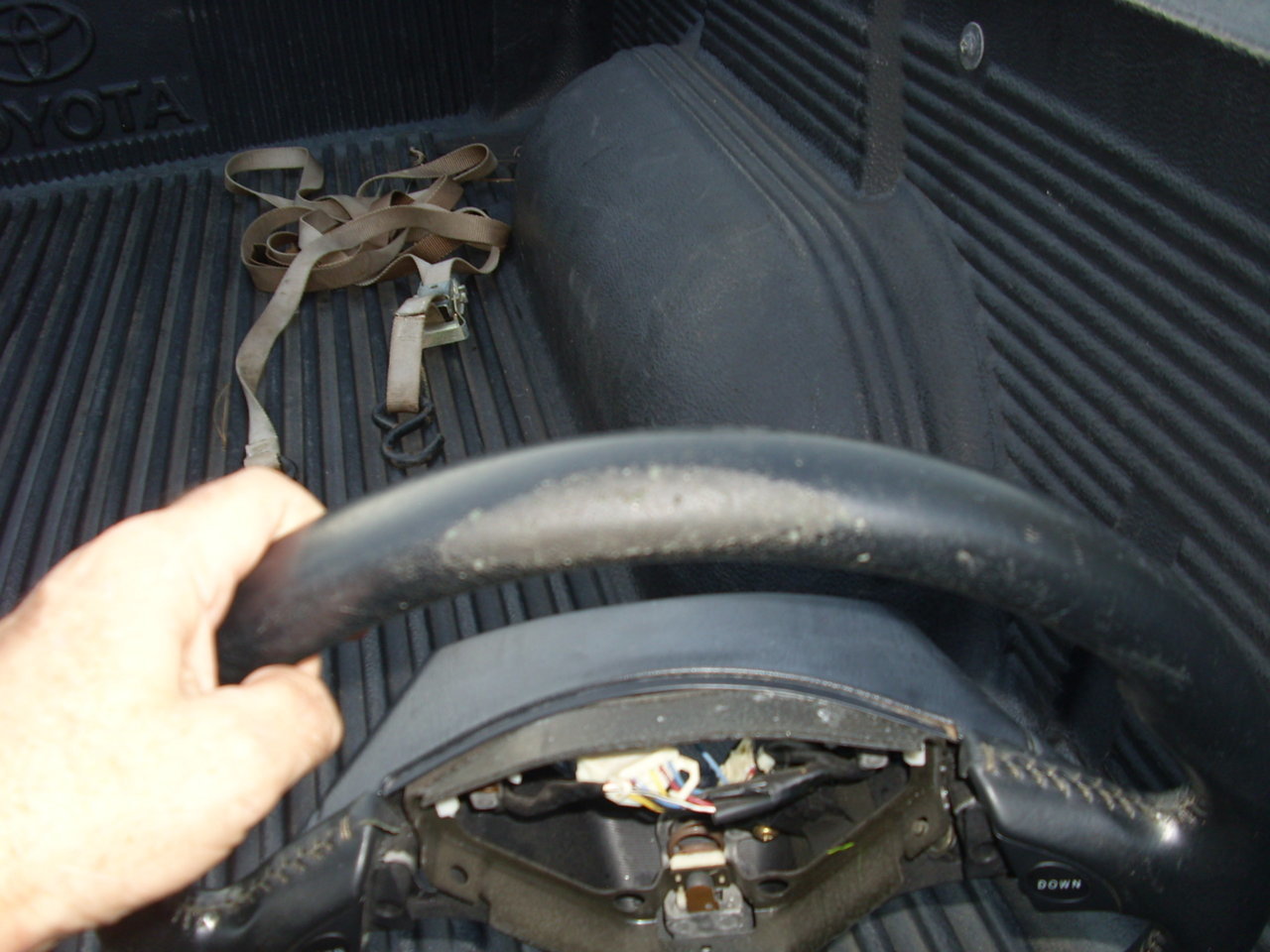

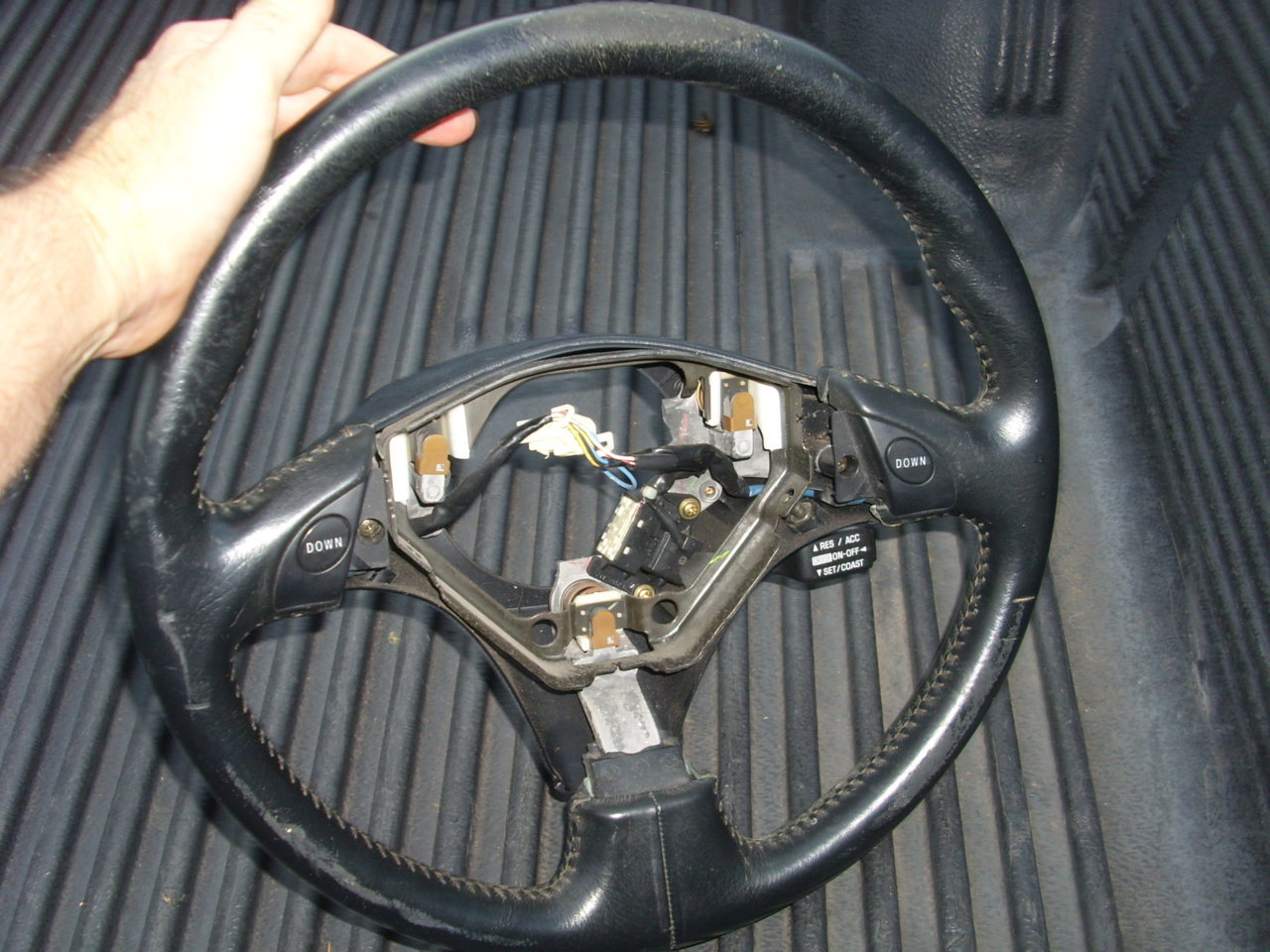

    Yep, there was a reason I had replaced it in the little IS. Worn on top. Really only good if somone had a bag/cover and wanted a free wheel. I think the Rav has covers that replace the shift buttons, they just don't (?) have a leather wheel option back in those years.
