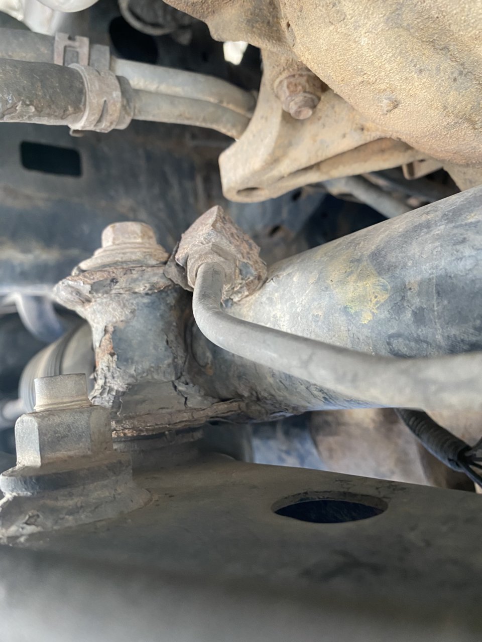

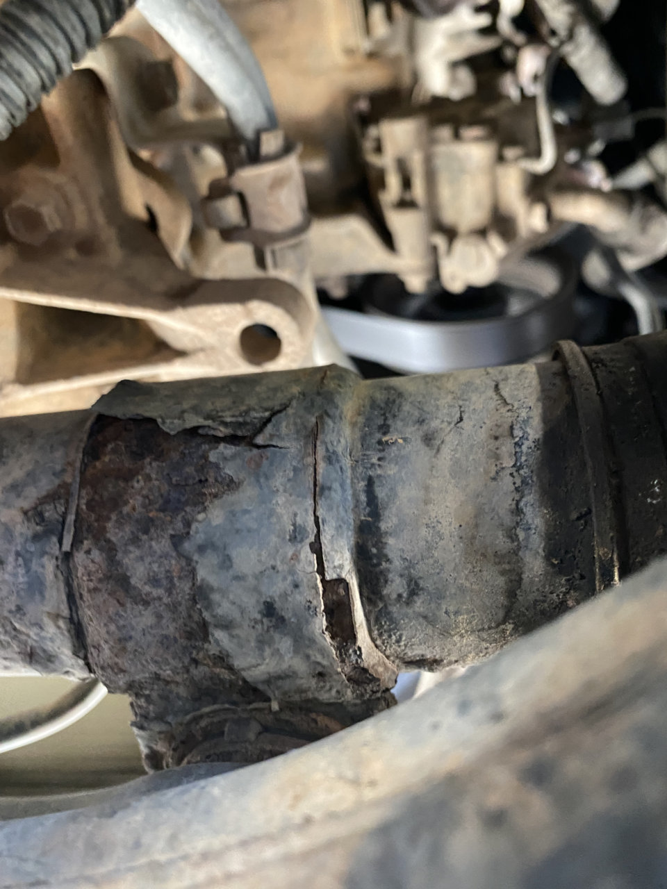

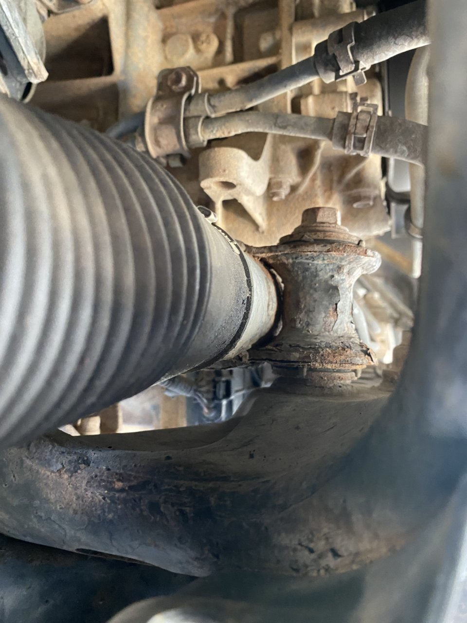

    Traced it back to the steering rack mounts. Completely rusted and flaking. The whole rack shifts as wheels are turned. As soon as I got it from the previous owner I noticed I was getting outer tire wear and started replacing parts. Would a shifting rack and pinion assembly cause outer tire wear?

    Good catch with the rack bushings, OP. What shocks are on it?

    You may want to give the mounts a small bang with a hammer to check their integrity. The rack itself may be good, but those bushings are documented shit, even in brand new form from the factory.
