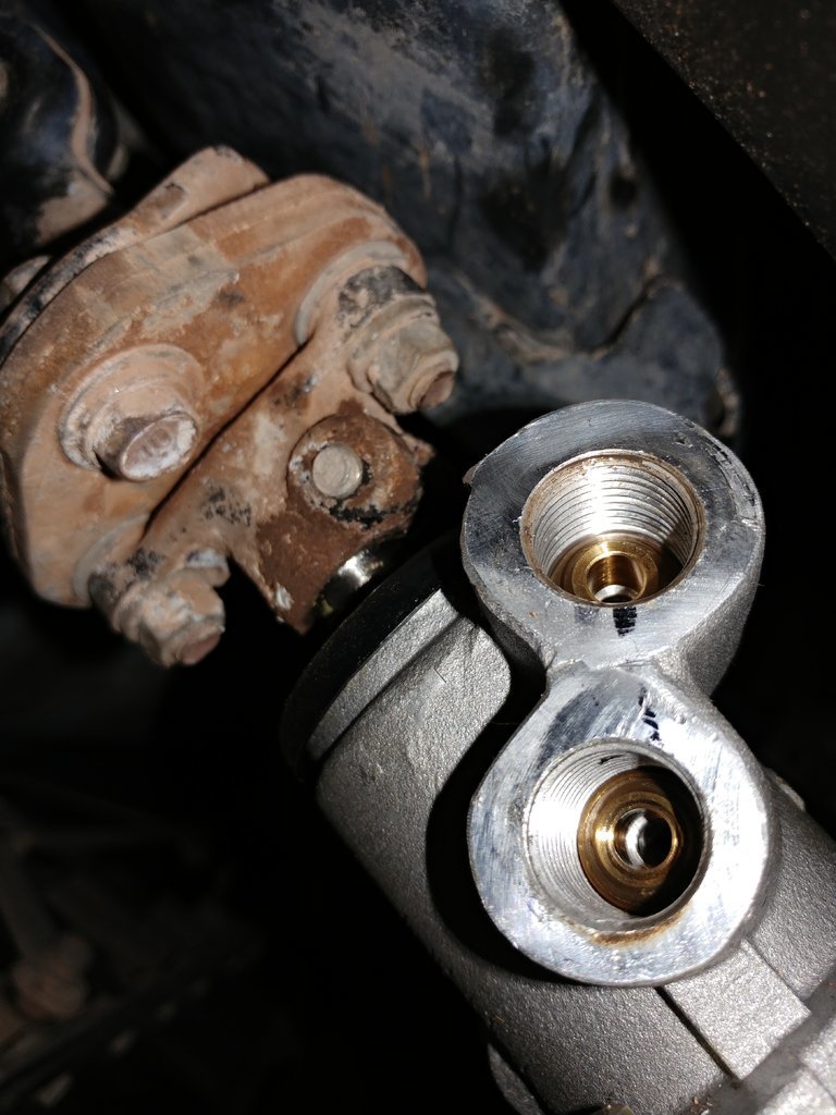

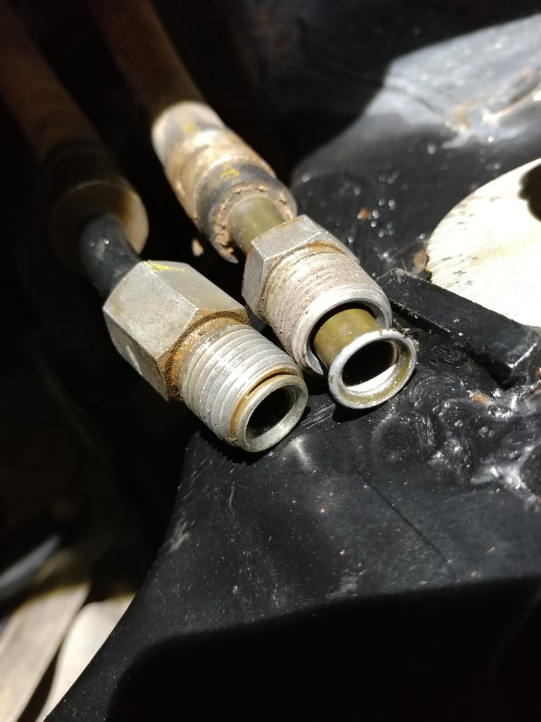

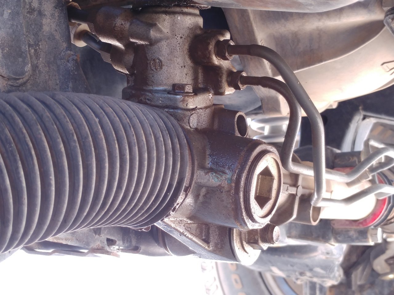

    Does anyone know if theres supposed to be any small o rings on the rack fittings? The new rack was supplied with a small baggie that had cotter pins for the TRE's and 2 little o rings. There wasnt any on the lines/fittings/old rack...

    Wasn't any right on the tip of the line?
  8. Sep 1, 2017 at 8:07 PM
    #28
    NightProwler
    NightProwler [OP] Well-Known Member
    Nov 12, 2013
    #116470
    3,447
    Harlan
    Maricopa, Az
    '01 Prerunner, '16 trd4x4, '09 R1, '03 cbr954rr, '03 rc51
    Nope. The two lines that go into the rack right? Nada. Not even any debris. Odd because they werent leaking..

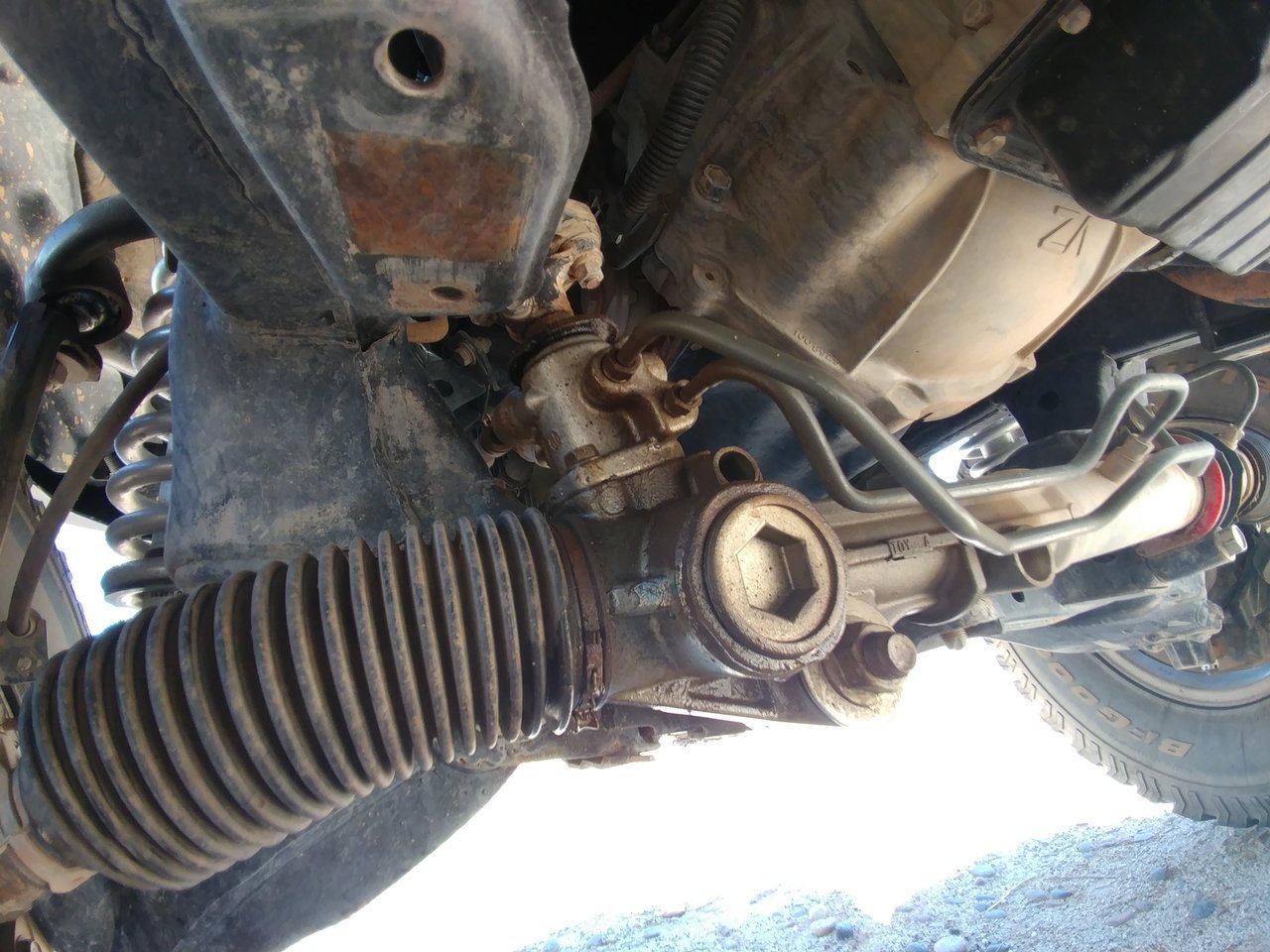

    So they go on the tips of the fitting?? Or set them inside the inlets of the rack ports then plug the line in? They look like they're too small or would just fall out if put on the tip of the fitting.. Or do they get wrapped around the flange of the lines?

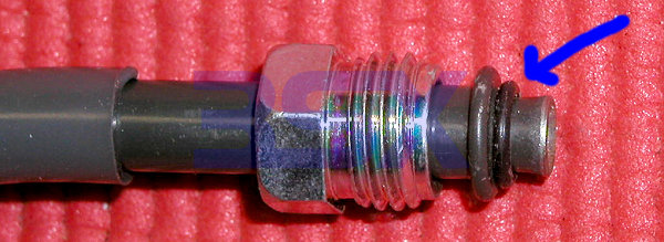

  9. Sep 1, 2017 at 8:42 PM
    #29
    mechanicjon
    mechanicjon They call me "Jonny Stubs"
    Dec 2, 2016
    #203828
    10,141
    Jon
    Scottsdale Arizona
    04 Taco SC 4dr SR5 TRD Prerunner
    Supercharged, AEM FIC/6, Meth Inj, ION Alloy's, Radio & Phone steering Wheel controls,Fabtech AAL, Billie's wrapped with 880's , Tundra big brake conversion, bully bars and Pioneer DDin Stereo/dvd with exterrnal usb ports. 290K and going strong.
    steering-rack-lines-on-rack-stock-18-600l.jpg Thinking something like this.
  10. Sep 1, 2017 at 9:10 PM
    #30
    NightProwler
    Nov 12, 2013
    #116470
    3,447
    Harlan
    Maricopa, Az
    Ah ok yeah thats what I was thinking. Thanks m8.

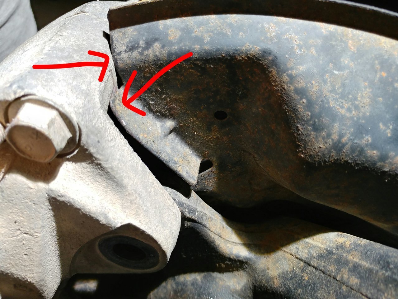

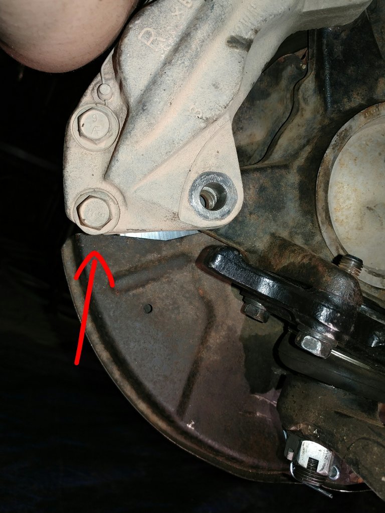

  14. Sep 5, 2017 at 2:25 AM
    #34
    NightProwler
    Nov 12, 2013
    #116470
    3,447
    Harlan
    Maricopa, Az

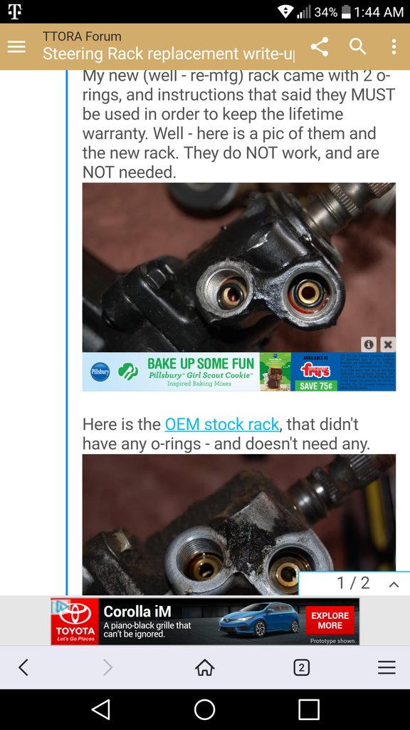

    Jeesh. I should just rename this thread to front end rebuild. Basically what I've done.. So just another update, as I got around to working on her some more.
    I did a little research on the rack fittings and it looks like the o rings are in fact not used, as the rack/fittings use the flange type fittings. Found a ttora thread that confirmed that too. Just because I wasn't sure if the new rack was supposed to have maybe an updated o ring type and need adapters. I didn't think to compare the two fittings or anything before I took the core in. So just a little fyi in case someone's learning these things as ya go, like me. Ha.
    Annnnnd. Yet another set back. With the 4 runner spindle.. Was about to button her all up and put the wheels back on.. When the rotor and the caliper wouldn't slip on far enough. Turns out the dust shield is ever so slightly different. Guess I should've had them swap the shields too. Just didn't think about it. I did briefly compare the two and they looked the same. Just some very slight differences. Sigh.... Oh well. Nothin a lil bending and cutting can't fix I guess. I had to bend/hammer one part in slightly that the rotor was grinding on . Then tomorrow ill have to cut off the outer most edges of the shield as well to clear the caliper. Bleh. Should have it done tomorrow. Just gotta fill and bleed the rack after that. Then alignment. And maybe right back for a second balance after I test drive it and that vibe is still there. Which means it will certainly have to be a balance issue at that point. Because literally everything is new/rebuilt up front. Unless it is in fact a rotor that got tweaked. But from what others said, doesnt sound like it'd be enough to warp it permanently. Only when it's first torqued down improperly/imbalanced. And should correct itself after a retorque. (Is what I gathered from that anyways).

  17. Sep 5, 2017 at 9:36 AM
    #37
    nzbrock
    nzbrock Well-Known Member
    Jan 6, 2013
    #94572
    3,234
    Noah
    San Marcos, TX
    99 TRD Prerunner 3RZ
    SAW 2.0 Coilovers Wheeler's 5 Leaf + 3 AAL Bilstein 5100s LCE long tube header Flowmaster Delta 50 Muffler FJ Trail Team Wheels 4Runner overhead sunglass console 4Runner leather seats All LED lights Red/Clear Tail Light Tundra Brakes HID Projector Retrofits 4Runner Auto Up/Down Windows Bullet Liner Cargo tie down system E-locker axle swap w/4.56 Gears ARE MX Cap Prinsu Toprac Custom heated turn signal/puddle light mirrors Volant Intake Tube
    Yea those look like inverted flare fittings. I believe toyota uses those on all types of hydraulic lines. They should seal without anything extra, just make sure the flare is clean.
