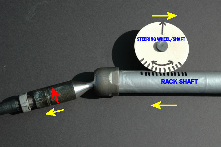

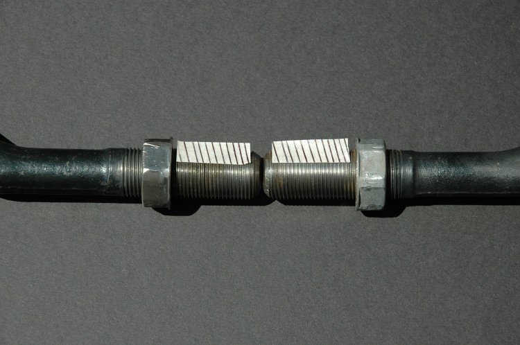

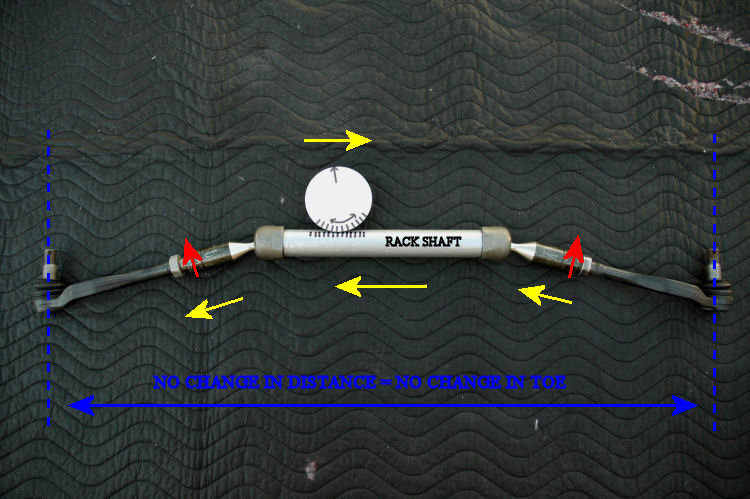

  4. Sep 8, 2017 at 9:05 AM
    #44
    Dirty Pool
    Dirty Pool FLIES ON THE FRIES, KETCHUPS WATERED DOWN
    Mar 24, 2013
    #100471
    2,311
    59.4 Miles, 56.67° NE Of Moab
    99 XCAB V6 MT TRD
    Dirty Pool rear bumper/air tank with integrated spare CV shaft storage, DP customized TJM front bumper, 8000 lb Ramsey/Technora rope, E-locked, Extended breathers with front diff catch can, PCV catch can, SAWs with DP heim joint seals, DP custom 6 leaf rear springs/Billies, DP custom skids, 2lo, Gray wire, Cap, Bed Rug, Black steelies, 01 Center console, Map lights, Disraeli gears
    With an unknown history or major component replacement, center the steering column/wheel/spiral cable (cable first), center the rack, connect rack to column, set toe and fine tune steering wheel position with ITRs.
    Fun facts.
    Rack (control valve shaft) has 36 splines, each spline = 10 deg of steering wheel position, any of the 36 positions can be used.
    ITRs should be equal, with in one thread of each other. Not always possible if there are slightly bent parts/frame or aftermarket components.
    One full turn of both ITRs in the same direction will change steering wheel position around an inch/12 degrees at the circumference without changing toe. 1/6 turn (one flat of the hex) will noticeably move the wheel.

  5. Sep 8, 2017 at 9:44 PM
    #45
    NightProwler
    NightProwler [OP] Well-Known Member
    Nov 12, 2013
    #116470
    3,447
    Harlan
    Maricopa, Az
    '01 Prerunner, '16 trd4x4, '09 R1, '03 cbr954rr, '03 rc51
    Cool thats about what I thought.
    But what about centering the rack? If outer tie rod ends were put back on in same position/same thread lengths, then the rack should be easy to center while on vehicle right? Just turn the wheels and rack together to center, then adjust steering wheel and attach to input shaft right?
    But if its off center by a lot, then the tie rod ends can be removed and rack centered. The entire Rack doesnt need to be removed right? Just mark the shaft and count the turns? Or can you just measure the lengths of each side and center?

  13. Sep 9, 2017 at 2:33 PM
    #53
    Dirty Pool
    Mar 24, 2013
    #100471
    2,311
    99 XCAB V6 MT TRD
    Expanded version. This is a "process" from start to finish. Altering the process at any point "could" screw up the final result.
    Assuming caster/camber is correct and where you want it.
    Center the rack exactly between lock to lock. Do this while disconnected from the column and spindles by turning the control valve shaft with a nice white mark on one of the splines as a visual aid. It will be a "hard" lock when the big end of the ITR hits the rack body. If the boots are in place they will be tightly compressed just before the "hard" lock is felt. You could slide the boots back away from the rack for a better "feel" and less chance of springing back a bit from lock, messing up your turn count. Leave rack disconnected.
    Center spiral cable in its range. It will allow around 5 total turns of the steering wheel before it starts to bind. Be careful and turn only until very slight resistance is felt. You can easily damage/stress the ribbon wire with excessive force and the steering wheel provides a lot more leverage than the factory procedure below. Also keep in mind that the u-joints at the bottom of the column are going to be flopping around. If the steering wheel has never been off or the spiral cable replaced, the steering wheel should be straight within a couple degrees. If it's not, pop it off and and put it back on straight. But first while it's off you can double check the centering of the spiral cable by checking it's "centering marks". These marks allow for exact centering. Forget the last bit below about matchmarks on the wheel and shaft. To be really safe, you could start with the steering wheel off. Your call there.
    Now turn the ITRs so equal threads are showing on the OTRs. In a perfect world, Toyota wants them (OE) to be within 1.5mm of each other. 1.5mm just happens to be equal to one thread. Make the total length from OTR "end to end" enough to allow the OTR studs to drop into the steering arms on the LBJs with the wheels as straight ahead as possible. Do this by turning the ITRs in opposite directions equally while holding the outers or turn the outers while holding the inners (Left Twix Right Twix). Set toe angle by your favorite means then fine tune steering wheel position by turning both ITRs the same direction (one way or the other) to center the wheel.
    Give her a test drive and fine tune the steering wheel position again, usually needed in a DIY scenario to get it perfect.
    Keep in mind that when all buttoned up and on the road, things like caster/camber settings, control arm bushing condition and bent things can effect when each side reaches lock. On a lifted truck, cargo/occupants weight and weight distribution can effect steering wheel position and all alignment angles much more than at stockish height.
    Reward yourself with a refreshing beverage.
