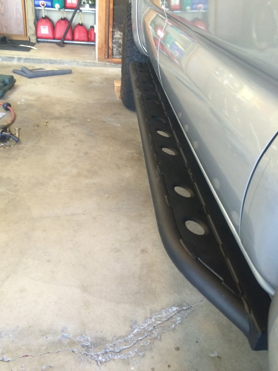

    I have the AllPro ones you mentioned. I've had them on both trucks and find the company very upstanding. I had mine powdercoated matte black. Saves me from door dings.

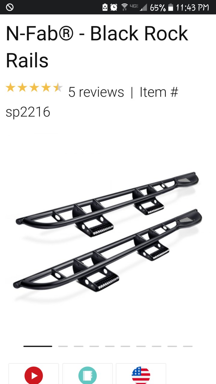

    No These!

    Same thing. They bolt to the factory step mounts, not the frame. I’m sure they are great for stepping into the truck.

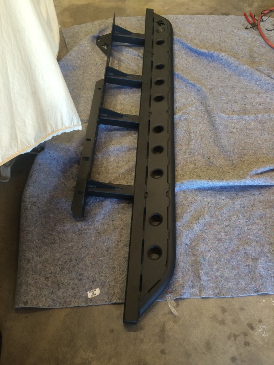

    Relentless fab on mine and really pleased. Bolt in option along with doing kick out or not, filler plates and angle option in relation to the frame- most range from 0-20 degrees. Steps will always and only be steps but sliders can be both. Go with sliders!B774196D-25DB-4AA6-982D-D4051757F601.jpg

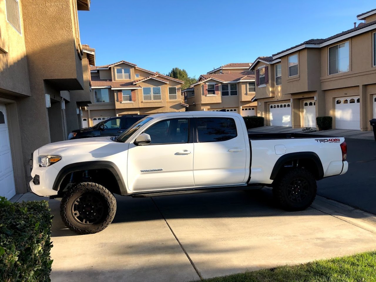

    I bought this guy's sliders.

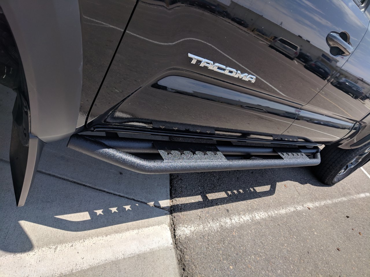

    I got the Tygers and I like em for the price. But what you'll notice is in addition to not holding as much as true sliders, you'll also lose an extra 2-3 inches of clearance because of the second bar under there. True sliders won't lose as much clearance.
    They were free for me when I inherited the truck, and like you I need it for parking lot protection ATM. When I get ready for serious offroading though I'm definitely going to have to swap them out.
