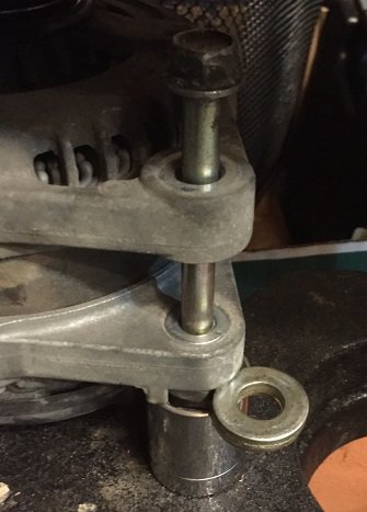

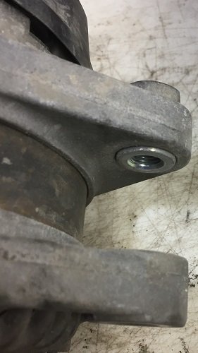

    The two mounting bolts are the same length. I installed the upper first, then wiggled the alternator until the bottom holes lined up. If you were re-installing the same alternator I can see you having trouble lining up the alt into place because the lower mounting tab on the alt has a sliding nut. Before installing the alt, the nut needs to be pushed out to give you a little breathing room; you only need a mm. I ran out to my old alt and pushed it out before I forget. Took some pics for you. Pushing it out was a PIA; had to use a 1-inch socket with some washers for stability; then threaded a bolt and used my press. Most alts have a sliding nut like this. It closes up when you torque the bolt.
