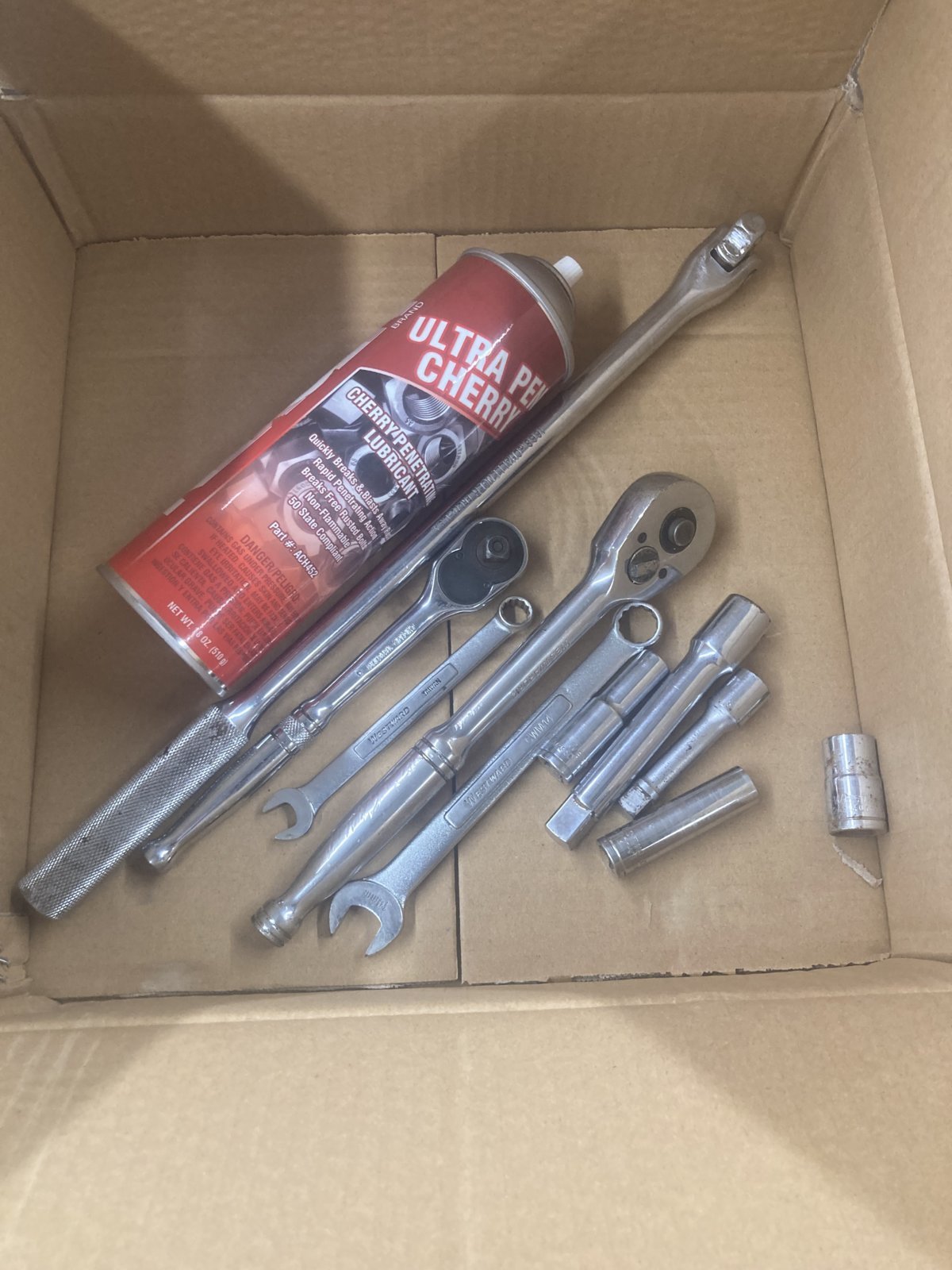

    On the picture you had of items you’ll be left with you failed to show the bloody hands and the bar of soap used to wash your mouth out from all the swear words uttered.
    I know. I did one several months ago. I used a full bar!

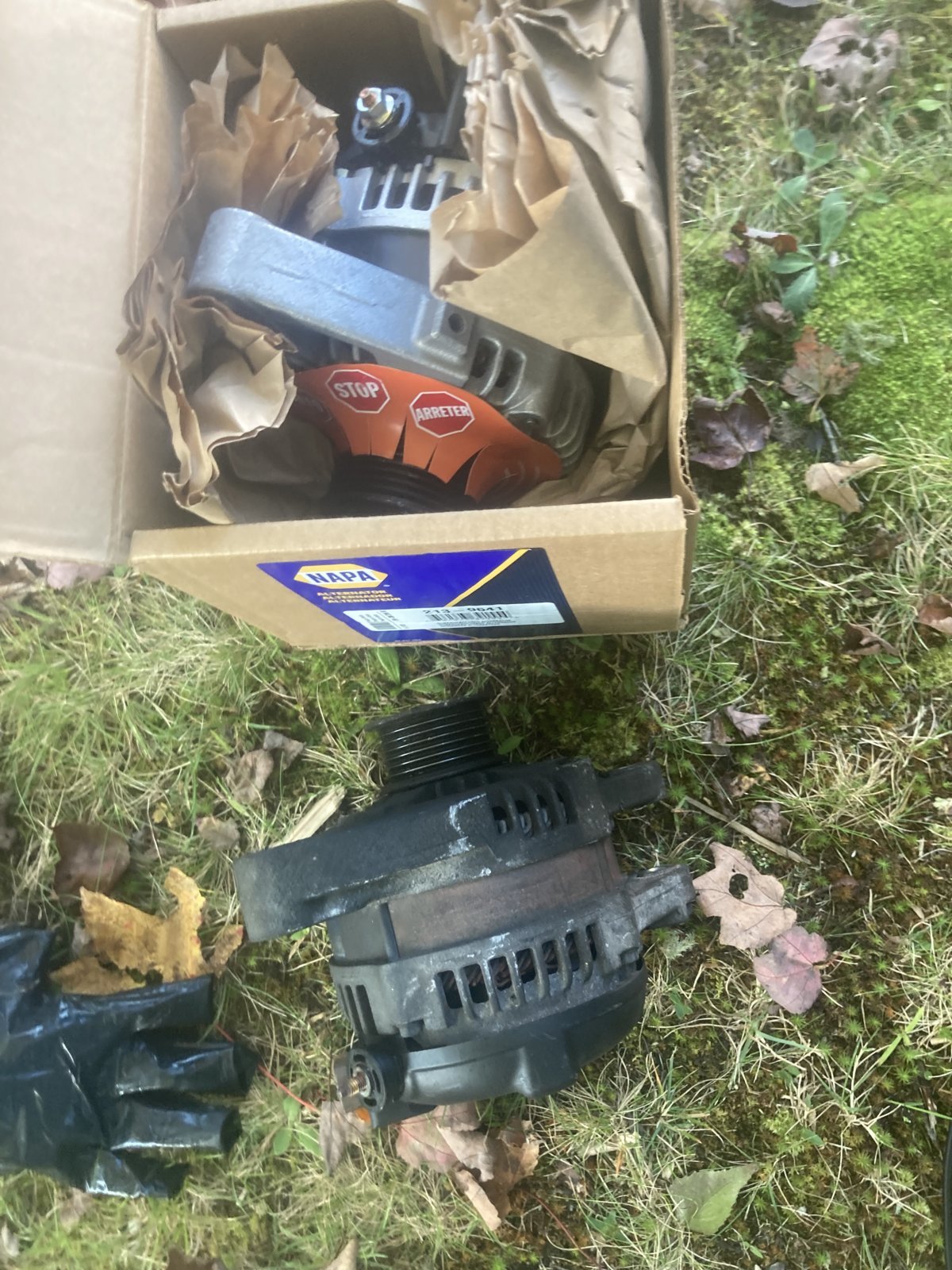

    Hey OP, I used this post to replace my dead alternator in the work parking lot yesterday, much thanks!
