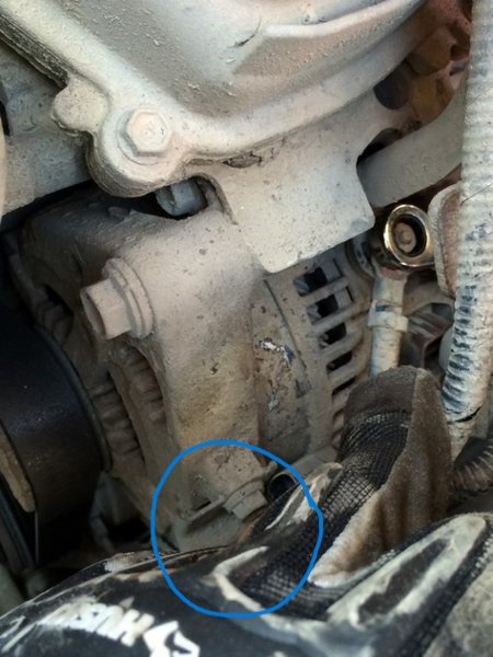

    cshinn89
    cshinn89 Active Member
    Sep 1, 2012
    #86022
    36
    PA
    23 Tacoma Off Road 6 speed MT 05 Tacoma Off Road 6 speed MT
    does anyone have a PN for the bracket on the side of the alternator, i'm replacing my alternator and that bracket that holds the wiring harness disintegrated and i cant find it in any of the parts diagrams.
    image of bracket below

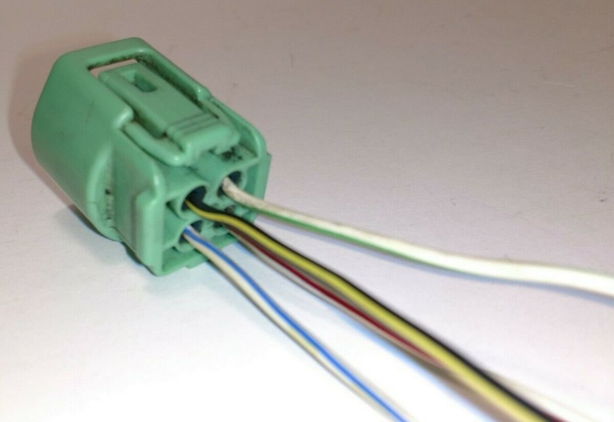

    One more note: I’m new to working on Tacomas, and struggled a bit with the wire connection until I took a closer look and saw the clip on the right side of the connector.
    Popped it right off once I found that. Glad I didn’t snap the connector when I was trying to muscle it off.
    press the tab and it slides right off.

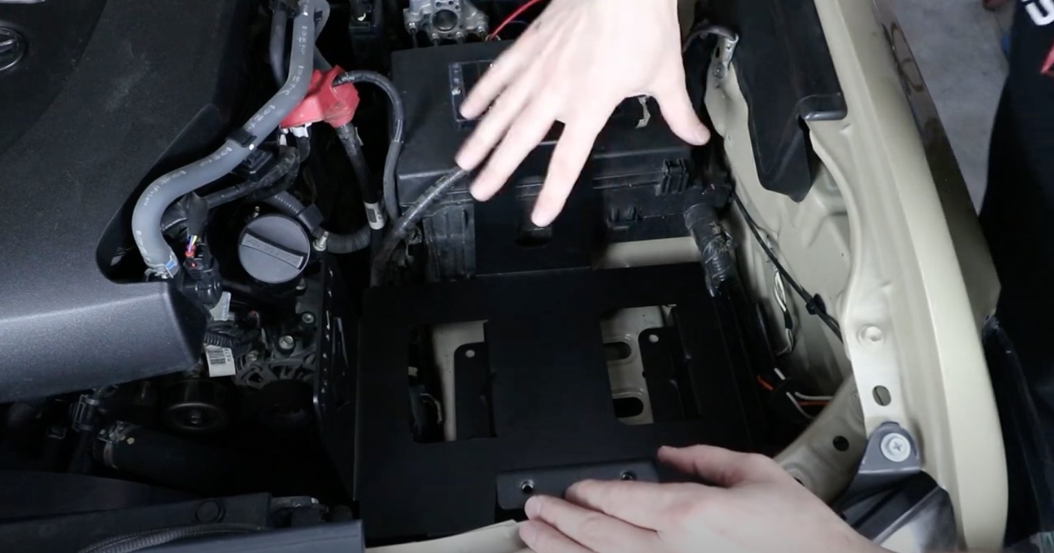

    Anyone able to comment about removal with Genesis Off Road battery kit? Clearly the batteries need to come out but if I have to remove that dual battery tray, I’m gonna lose my shit. They way I have it reinforced with some 1/8” steel plates was a bitch.

    Looking at the battery kit install video Genesis put out, definitely needs to come out. That lefthand side is entirely blocking your access.
