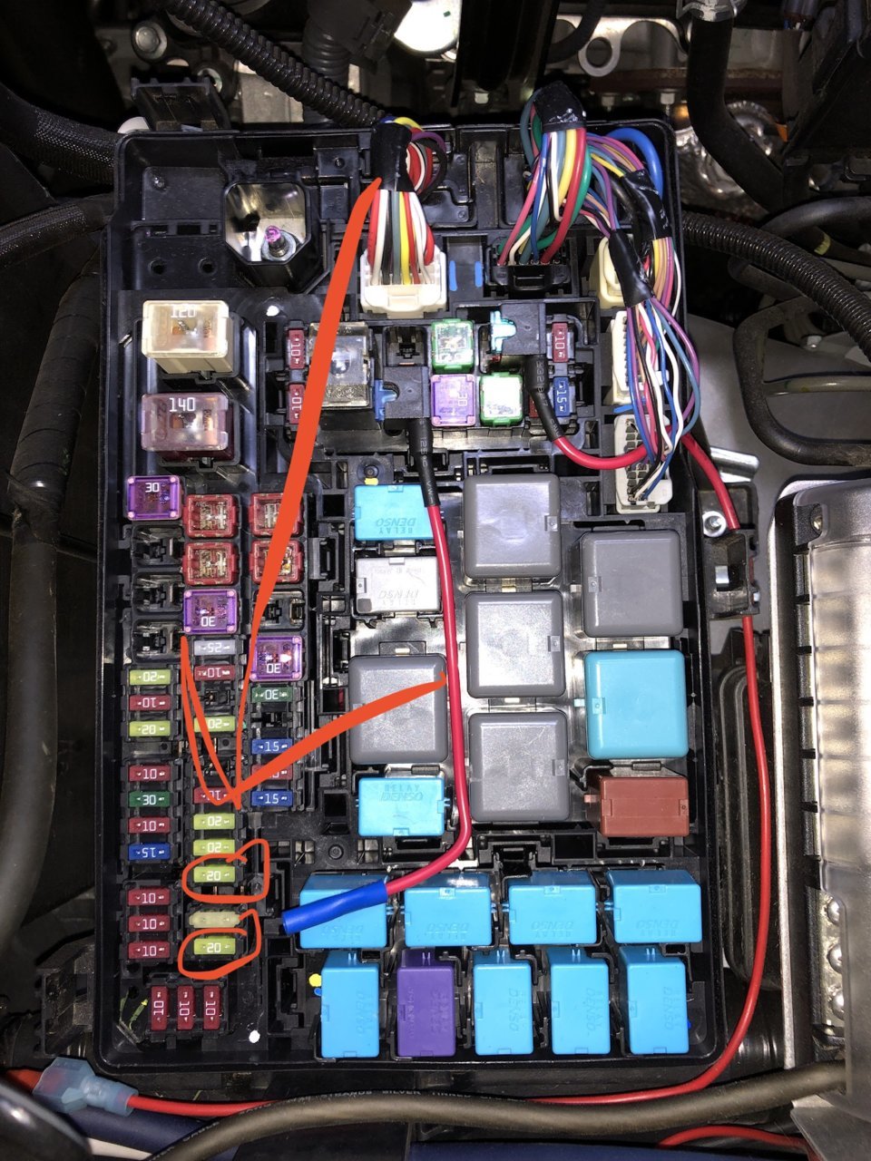

    Go to the battery fuse box and pull the radio fuses
    (These two)
    give it a minute or two, then put them back and turn the truck back on. If it still doesn’t work right, the radio is shot. Your options would be replacement from Toyota (I think they quote something like $2300) or a replacement used from a member here or eBay or similar (much less than Toyota) or go aftermarket
