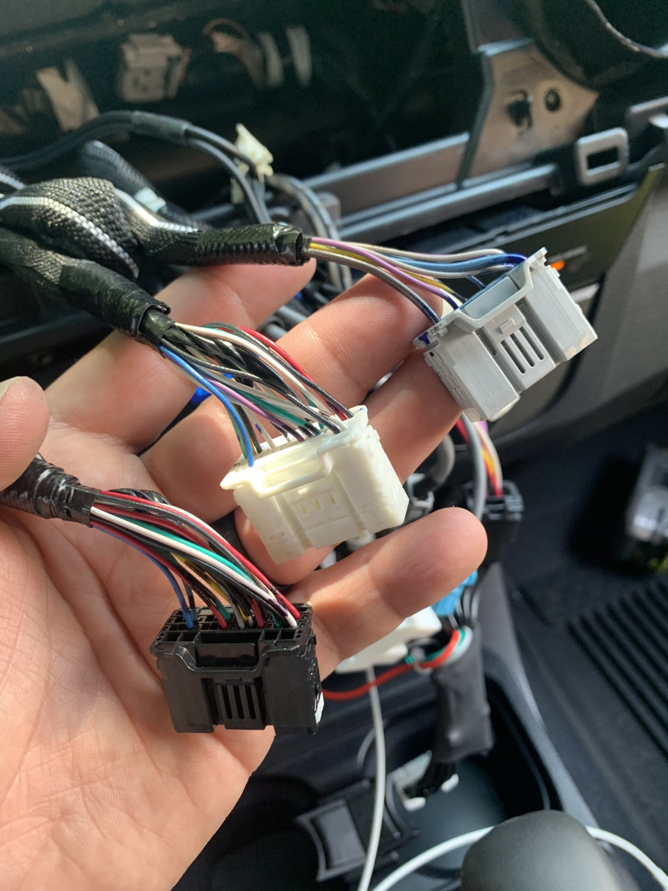

    2021 non jbl, adding a sub and amp to factory radio, plugged in add a amp behind factory deck and stereo no longer turns on. Unplugged add a amp and still no stereo. Checked all fuses as well. Any ideas? Anything I’m missing? Thanks team!

    Does stereo turn on without the add-an-amp plugged in?

    Do you have a multi meter? You’ll need to do some troubleshooting

    You want to go ahead and check for constant power in your main harness (the thicker white wire in the 10-pin connector)
    Then check for accy power (the really thin grey wire)

    And as simple and dumb as it sounds, make sure the connectors are plugged in all the way. Sometimes the Toyota connectors can be very stiff going into the back of the radio and it might feel like things are in, but they may not be fully set

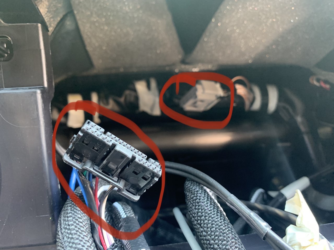

    Also, these two plugs don’t seem to have a home that I can find. Not sure if I accidentally unplugged one of them from somewhere

    The one way in the back is a ground junction. It’s taped up tight for a reason. The other one is definitely going to the radio, but it should affect actually turning on.

    That’s weird, there is nowhere to plug that in and it is kinda taped looped back to another harness out of the way.

    If it’s intentionally taped back out of the way, you may not have it. By the Looks of it, it’s either backup cam or aux, but I’m not sure off the top of my head

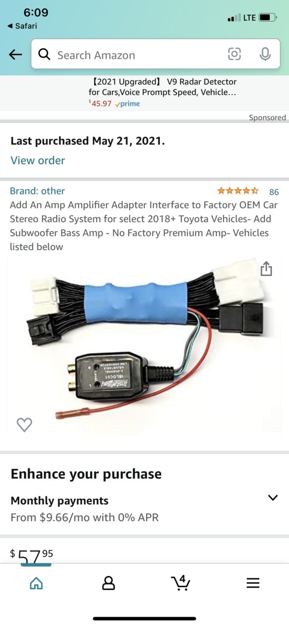

    I was using one of these, I can only think it was worded wrong and fried the radio maybe? Is there a better, safer way to add a amp that you can recommend? Thank you again for all your help!
