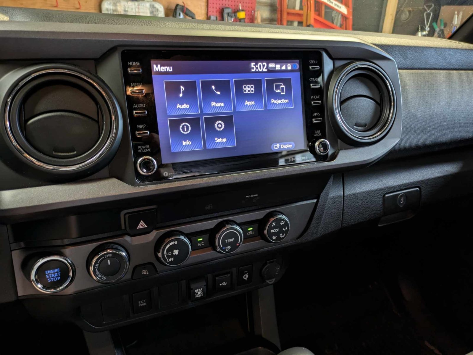

    There are three grades of stereo on the 3rd gen.
    Small screen - typically seen in SR trims. Silver knobs on top of HU.
    "Premium" - large screen, black knobs on bottom, side buttons are star-trek touch interface. Not JBL. I know it says JBL in red. It isn't.
    JBL - large screen, silver knobs on bottom, side buttons are also actual buttons. Comes with subwoofer. Not very desirable amongst stereo enthusiasts despite being the top trim. The weird resistance on the output makes it difficult to mod.

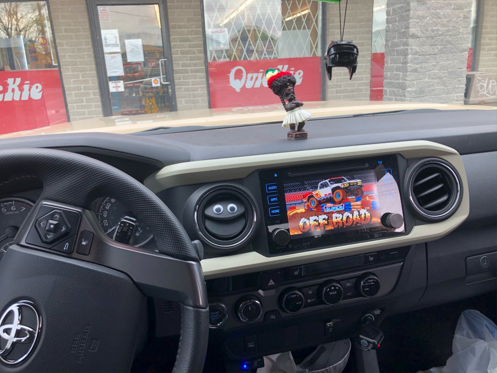

    Awesome. Thank you so much. 448729591_1212546819974598_6912858637085_764baa27000df365713e49ef9a7985b7b13633b4.jpg

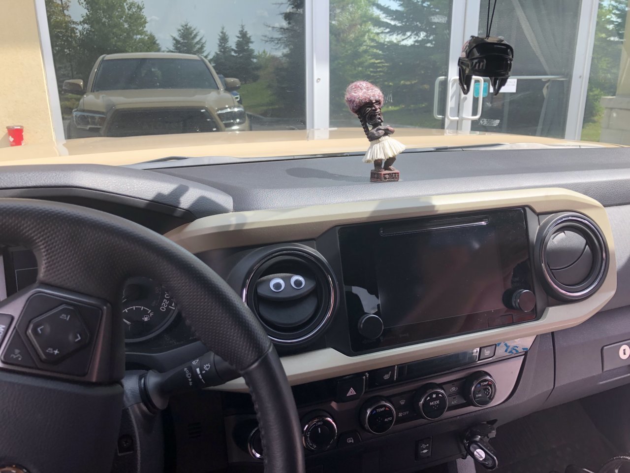

    Here's my '17 Off road stock screen
    It has touchscreen with navigation that comes along with the premium audio, It's not JBL
