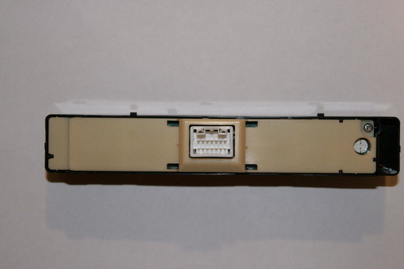

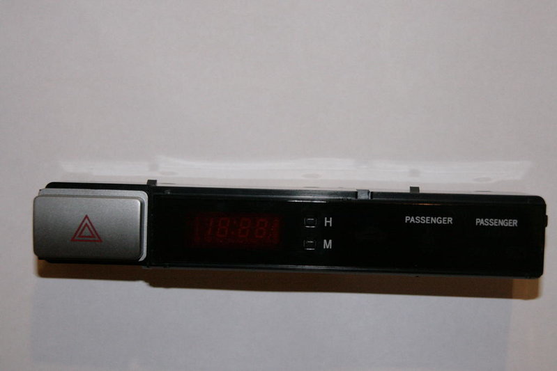

    I had a bitch of a time getting the hazard switch out.
    There are four clips that hold it in. 2 on top and two on the bottom. In the first two pictures you can see the "bumps" that snap into the holes on the console.(pic #3)
    Hope fully the pictures will help someone.
    Cheers
    J.O.

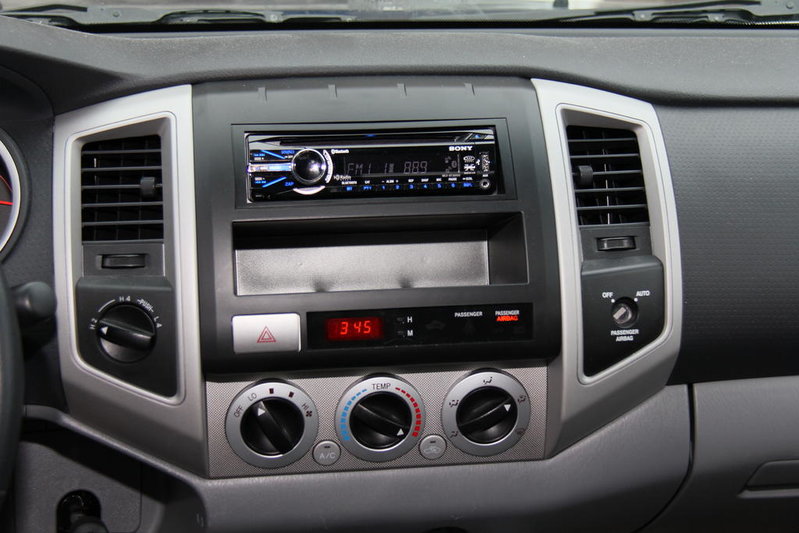

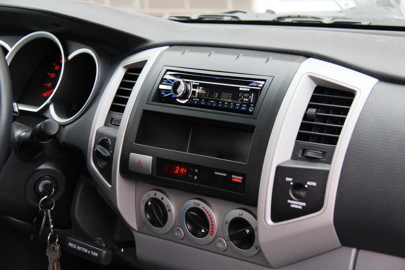

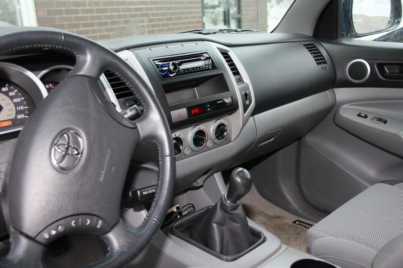

    Here are some pics of the finished product....in case anyone was interested.
    Enjoy.
