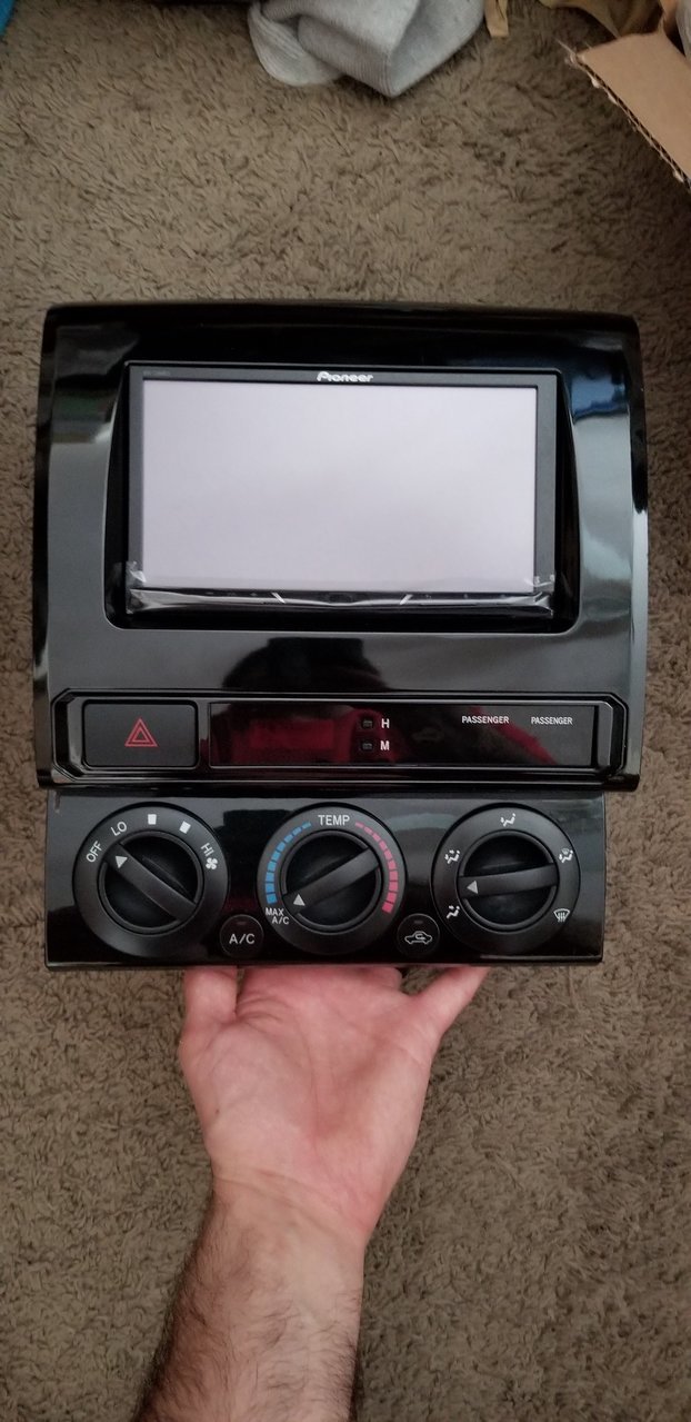

    Almost ready to install in my 07. Got all of the parts to change to black. Metra kit is garbage, would have to cut it, I do like the matte black around the hazard on the metra but the Scosche kit fits the pioneer perfectly for anyone looking.

    Yeah, I did the same thing... I thought I done something wrong initially, however I couldn't get the Metra thing to look even half decent for my level of OCD...

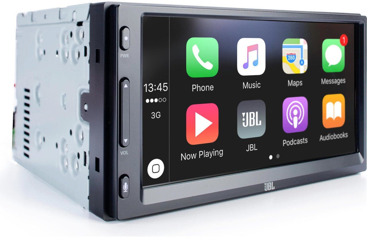

    For a low $$ impact I like the JBL CP100 pic attached if you dont need a CD drive.
    If you do I like the Pioneer AVH-2300NEX which I have and it works well. Be sure to get a Scosche kit. and BTW the steering wheel control kit comes with connectors so no need to buy them if you have steering wheel controls.
