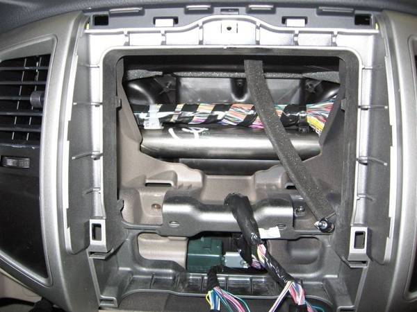

    Ok, here are the other pictures that I was going to show you.
    This is what the 2nd Gen. Tacoma's dash looks like with the stereo removed. This dash has plenty of room for a full size, double DIN, head unit with DVD and Navigation capabilities. However, I am only installing a single DIN size JVC head unit and an iPod adapter interface so I can listen to and control my iPod from my stereo.

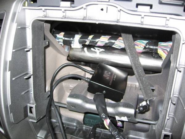

    This is where I mounted the JVC iPod adapter inside the dash below where the stereo will go. Fortunately there is a little shelf that is made out of the forming plastic that is in the dash. I just sat the adapter on this shelf and secured it using the double sided tape provided by JVC.

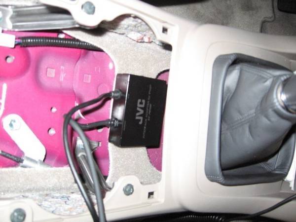

    I had another option when I was putting the JVC iPod adapter in place. I could have put it in the center console just aft of the gear shift. This would have allowed me to run the cable back to the console compartment. I decided not to go this route because it would require me drilling a hole into the compartment so the cable could come in. I did not want to put ANY holes in my new truck.
    LdyTaco05 - I hope this answers your questions. The iPod adapter connects at one end to the stereo (CD Changer control slot) and at the other end to the iPod.
