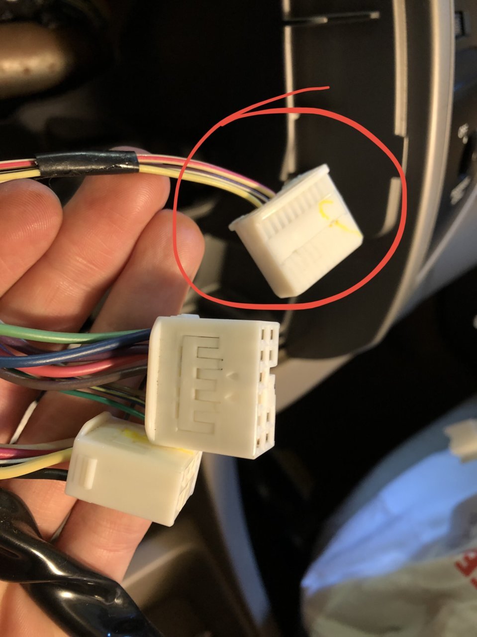

    Hey y'all - I figured this might be a good thread to post this question.
    I'm in the process of replacing the head unit on my 06 access cab and was surprised to find 3 harnesses plugged into the back of the stock head unit rather than two. The 3rd mystery harness is circled below:
    The other two connectors are all accounted for with my aftermarket harness adapter. But I have no idea what this third one is.
    Anyone know what this harness is for? It has three wires coming out of it - all which seem to be taking signal from the head unit, I didn't get any voltage on them when checking with a multi-meter (lights on/off, reverse, etc.)
    I've hooked up the aftermarket head unit and things seem to be working fine so I'm guessing I can just leave this guy disconnected. But I'm still curious what it's for lol

    I left it unplugged and I don't have any issues. But if someone knows what it is for that would be cool to know.

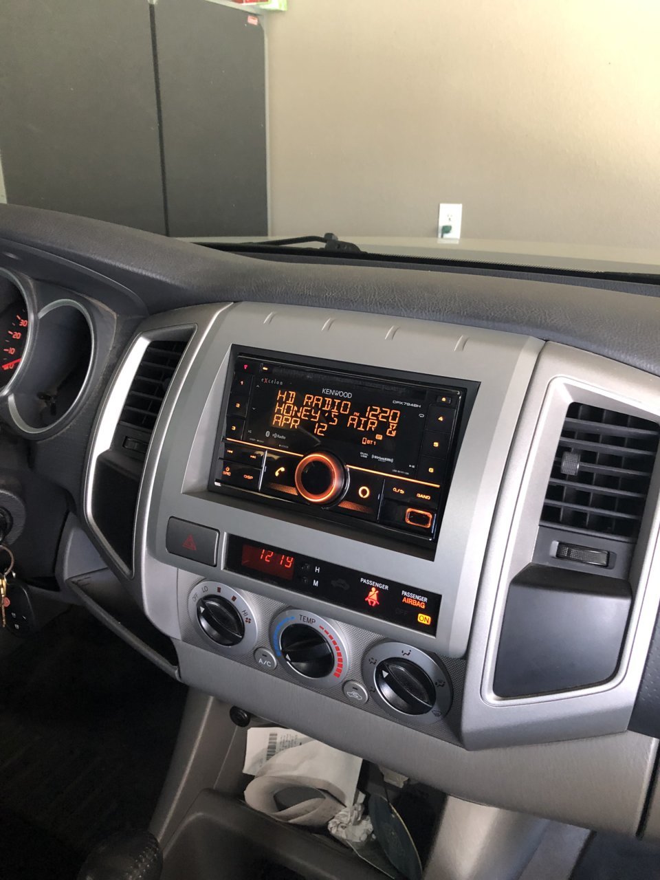

    Installed this past weekend. I really should have done this years ago.IMG-1408.jpg
    Capt Jrod, PzTank and Kolter45 like this.

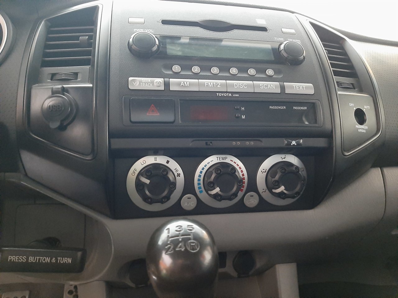

    08 RC Prerunner SR5
    My basic oem upgrade was GROM audio usb/aux/ipod unit off cd1 and rostra bluetooth pnp to add fon functions. Swapped to 6 cd oem unit from single disc and put black face with gray buttons on it. Mixed and matched oem HUs. Running 2012 black vol/tuning knobs. Lower profile with geared shape and lit circle in center. Did same clor swap with my cc panel...black face with gray buttons. Would like to swap to some high efficiency aftermarket component speakers that would work well with oem HU output....RC so just door setup. I like having oem because not too many people care about stealing oem HUs that I ever hear about.
    usb under left AC vent, aux behind shifter in center of lower dash panel, ipod cable in glove box & fon answering button left of st wheel on dash....

    I am pretty sure those are the 3 wires that run steering wheel audio controls. Look at your steering column plug that plugs into your spiral cable and I bet those same color wires are there. I am on mission to harvest both ends of that harness off similar toyotas in junkyard and make me a harness to go from oem HU to my spiral cable...which has the pins to run the audio controls on the 2013 wheel. Regular cabs do not come wired for this function so I have to add it myself. Did same thing on my 2004 xB with 2006 wheel that had the controls and made a harness to go from spiral to stereo.

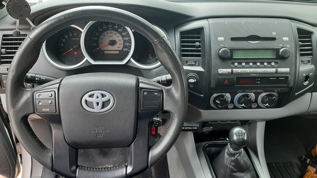

    Here's current pic with steering wheel audio controls painted black and waiting on me to make the 3 wire harness to go from spiral cable to stereo. That will be my last stereo upgrade wish.
    Also tiny 32gb thumb drive in usb slot to right of st whl. I cut little slot door in usb rubber cap for it to fit thru.
