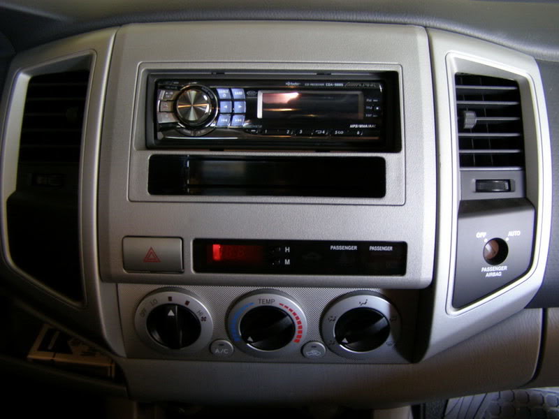

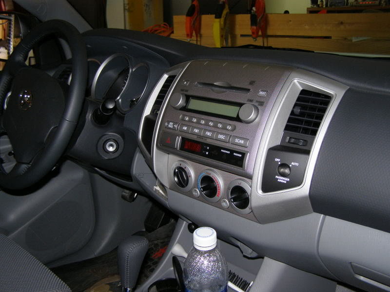

    Thank you. Pics helped alot.. New ALPINE CDA-9885 installed and sounding sweet! No other changes... WOW what a differance. OEM speakers actualy have life in them..:D

    It looks great! Congrats. :D
