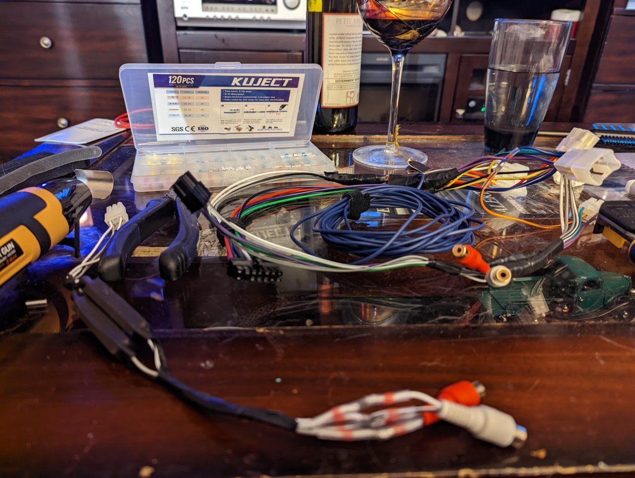

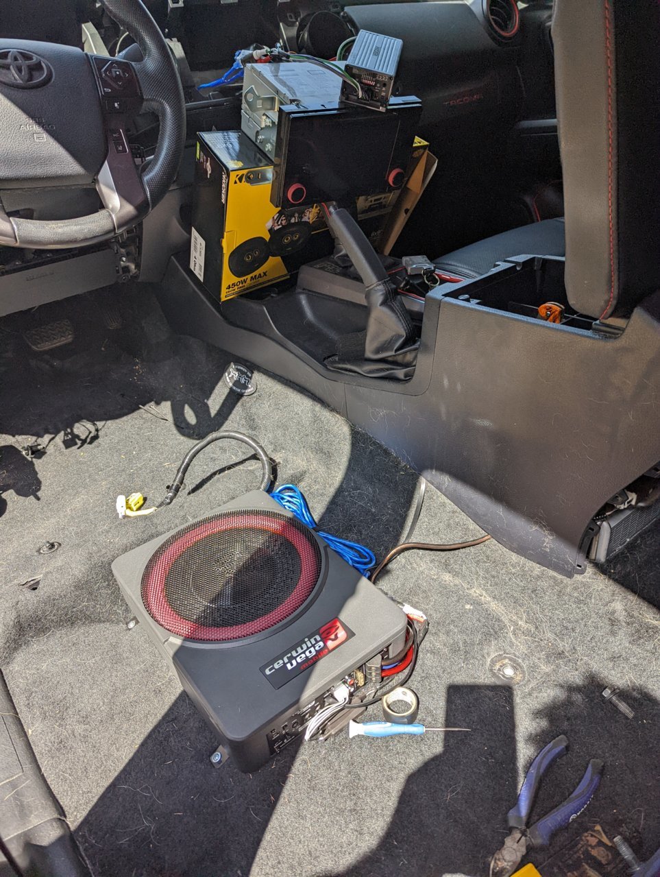

    Same exact setup here, except I amped with the kicker key (50Wx4 RMS), and stuffed it behind the dash. Made my own harness to tap between the HU and existing speaker wire. It was the easiest part of the audio install.
    It sits right at your max budget, though I got mine as part of a set from a member who had second thoughts on their install.

    The mic is part of the amps calibration process. You put it on the headrest, leave the car, and let it go through it's close-encounters-of-the-3rd-kind test tones. After it's done you unplug the mic and store it elsewhere.
    Mine powers all 6 speakers. I have it plugged into the factory wiring which means the front channels are going through the factory inline crossovers. Is it the best setup in the world? No. Is it easy? Yes.
    Of all things to DIY, I'd definitely recommend DIY-ing the amp. Why? Most shops will cut and splice your factory wiring, making a huge unreliable mess of it. If you do it yourself you can control how it's wired. It was very easy, there are guides all over TW depending on what model year you have (16-19 or 20+). I simply sat on my couch with a couple of Metra connectors, a self soldiering kit, and a bottle of wine, and made my own harness. Then when it came time to break into the dash it was a plug and play affair. The actual amp install took less than 20 minutes, 30 if you include calibration. Easier than the speakers.
    The only tricky bit on mine was that I also wired in a line for the underseat sub to tap into. That was a time consumer. But the amp is fully wired and sitting on top of the HU in this pic.
    And yes, much easier than the doors. :cookiemonster:
