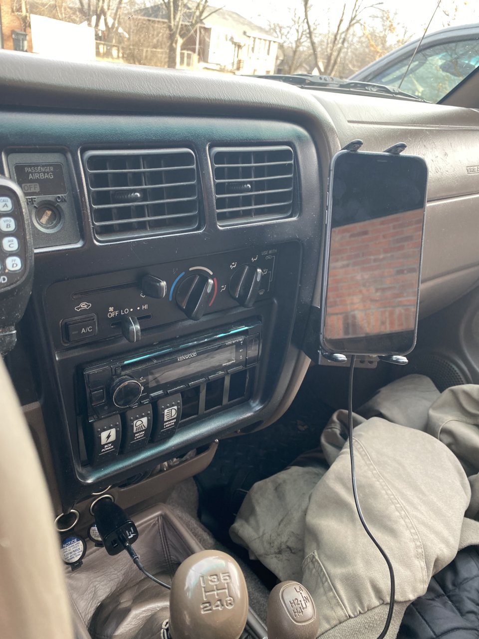

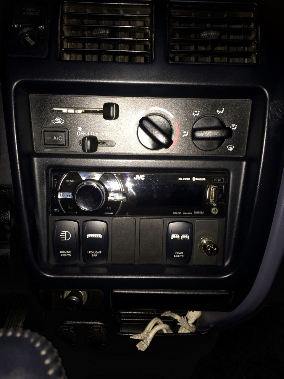

  9. May 2, 2023 at 8:01 AM
    Madjik_Man
    Madjik_Man The Rembrandt of Rattle Can
    Dec 2, 2009
    #26893
    19,723
    Colorado Front Range
    1998 Ext Cab 3.4 4x4 TRD 5MT, 2004 DC 3.4 4x4 TRD
    Similar set up in my 98
    Area51Runner likes this.
    My 98 has a single DIN media player. Love it. Also love the fact I have a switch panel below it.
    My 04 came with a double DIN touch screen. I hate everything about it.
