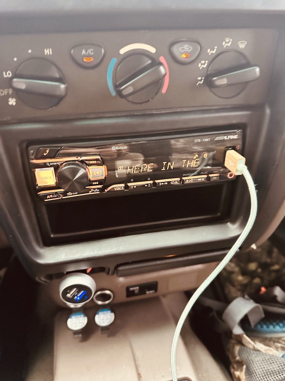

    I installed the alpine head unit Monday. Everything went well with the exception of the trim. I can’t get it to fit back in place flush. I’ll work on it some more later but it got too hot outside to stay out there any longer. If anyone has experience with the trim not fitting back properly and advise please let me know. As soon as I push the bottom I’m the top pops out and vice versa. It’s almost like the size is just off by the tiniest bit.

    You can see the gap between the pocket and the trim if you look closely. Sorry I hadn’t posted or replied earlier. I’ve been working some long hours.
