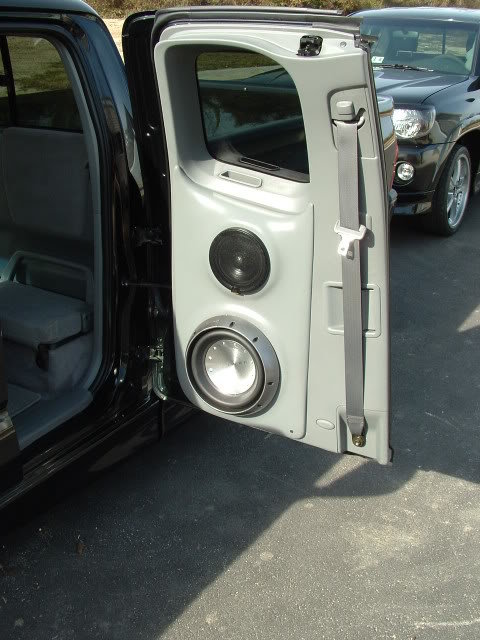

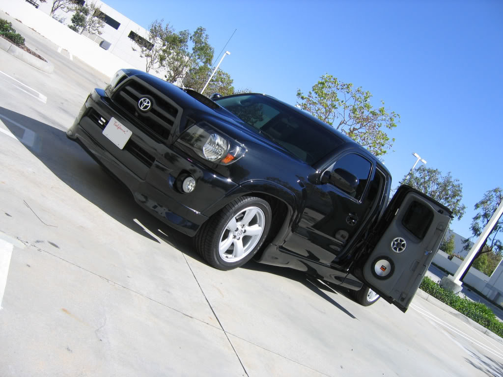

    10" subs in an Access Cab without losing space. MUHAHAHAHAHA!!!!
    http://www.xtremekreations.com/fabrication.html
    From the guys at www.xr-underground.com and used without permission:
    XDsm's ride:
    ntinhri's ride:
    I have a set of the panels at home ready to go into my truck. They are solid and look way better than I was expecting. I can't wait until I'm ready for this part of the project!! :cool:

    Wow, those are awesome. Not ready for that price yet though. Where are you putting the amp(s)?

    I'm bolting it to the steel under the rear window and cutting an opening the plastic for ventilation. My truck is rather ripped apart and will never have anyone where the back seat once way so it leaves me with some options. :D
