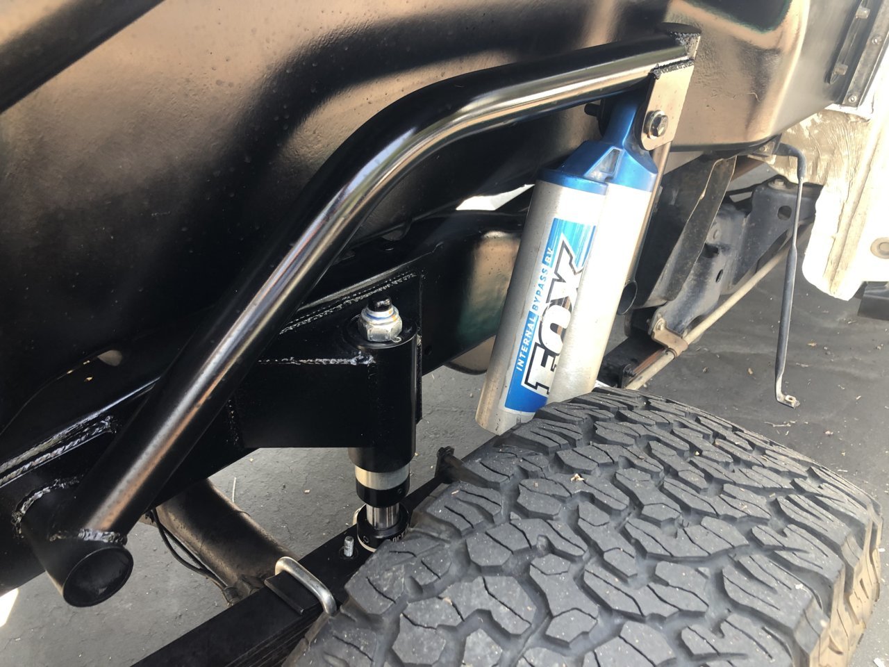

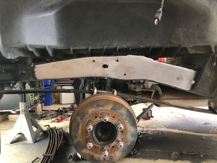

    Had a super cool dude named Nick Valentine (NV Fab) build me some tube inner fenders, along with straightening the core support as best he could. Remounted all components in Oem location.
    Very pleased with the work, price, and responsiveness of his shop, would 100% recommend him to anyone in SLO county.
    Damaged pictures from Pismo 10/9/18:
    7012E6E9-2EFC-483E-B270-7D24DDAF5DDB.jpg EFE7B208-C5C4-4E75-876B-C074F2B2BFA2.jpg 6B40C913-6309-4756-83EE-6DDAAED97A93.jpg C59C5CFE-4C3D-4658-B77B-2C71A2517D5D.jpg
    Rebuilt photos:
    With Oem stuff, the UCA’s were slamming into the sheet metal inner fenders, now there is PLENTY of room for those and larger tires...
    C6000192-3774-419A-BDAB-509EC90F6506.jpg F82EA621-D84F-4E44-B263-F42C302EA708.jpg CA83D5D1-4356-4F1E-953E-AC3B1E523F99.jpg F5911B38-A681-4FB5-8CF3-58BE168961B9.jpg
    Next up on the list is getting some thermoplastic and moulding some sheets to protect the fuse boxes and VSC module. And going to bedline the bottoms 1/2 of the washer fluid reservoir.

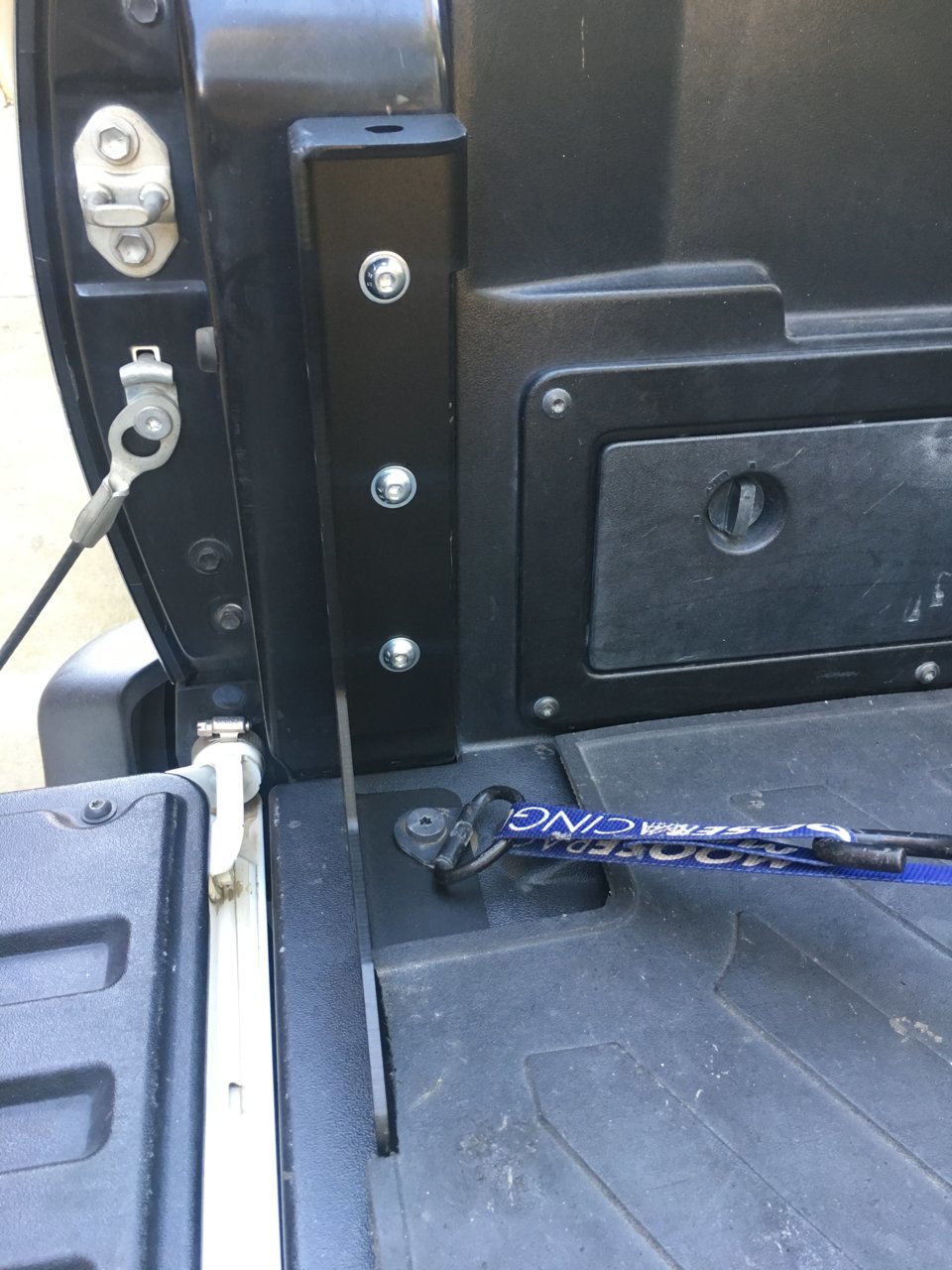

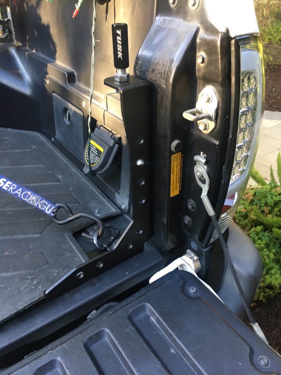

    Got some caliraised bed supports a couple weeks ago, and finally got a moment to install them. Easy install, great fit, and only had to trip the bed mat a hair.
    Always good to have more tie down points, straightened up my bed a tad bit, and now I actually have a decent mount for my quick release flag mount (passenger) and pending CB antenna (driver).

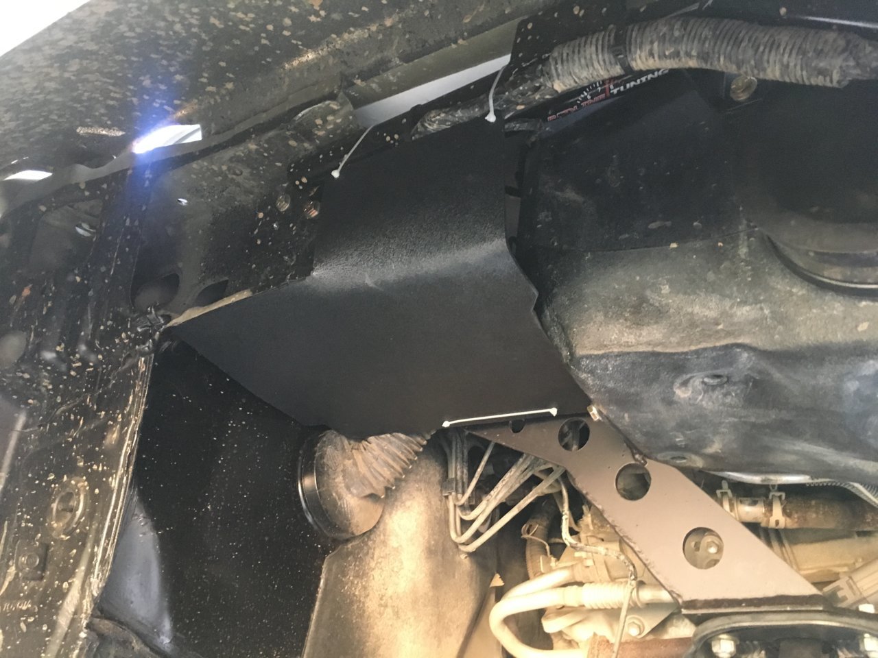

    Also finished the passenger side protective cover for the vsc module. Thermo-moulded from 0.118” thick ABS plastic, and trimmed to size.
    Peace of mind in case of rocks.

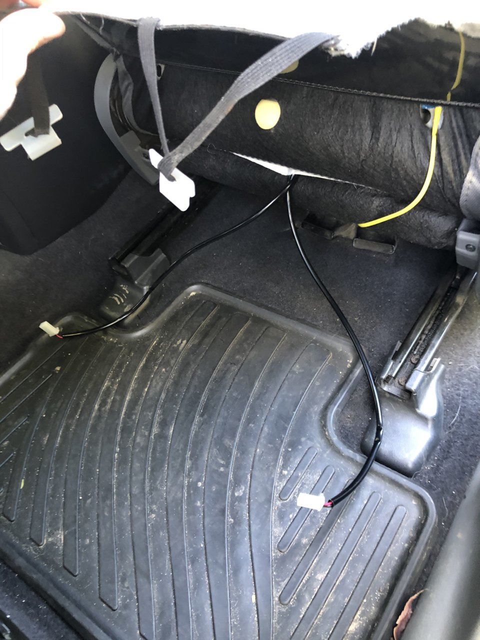

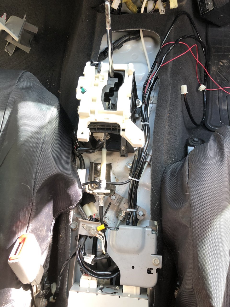

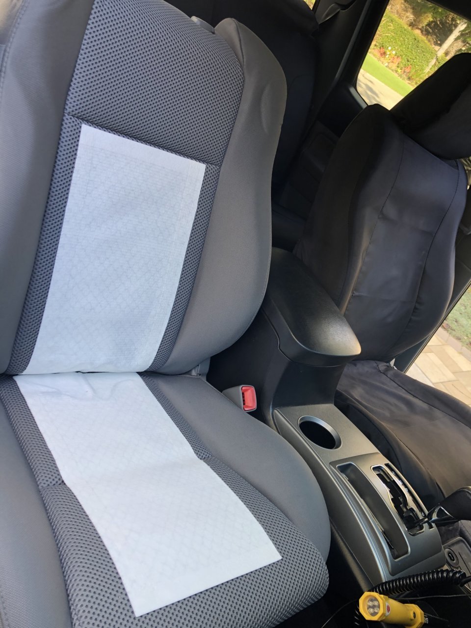

    Installed some heated seats from Clazzio, kit number 1.
    896344EA-CDA7-4277-9F27-D360BD9E1AE0.jpg B246C012-FC48-4929-B8A7-23DD66C27AEC.jpg D3EAFC23-F87D-4CE4-A004-CBC3B560C3DF.jpg AE761A7A-1354-41BA-9EE1-685071473F35.jpg
    Clazzio switches Drilled into oem blanks, ideally I’d like to find oem or oem-like switches like these rav4 ones:

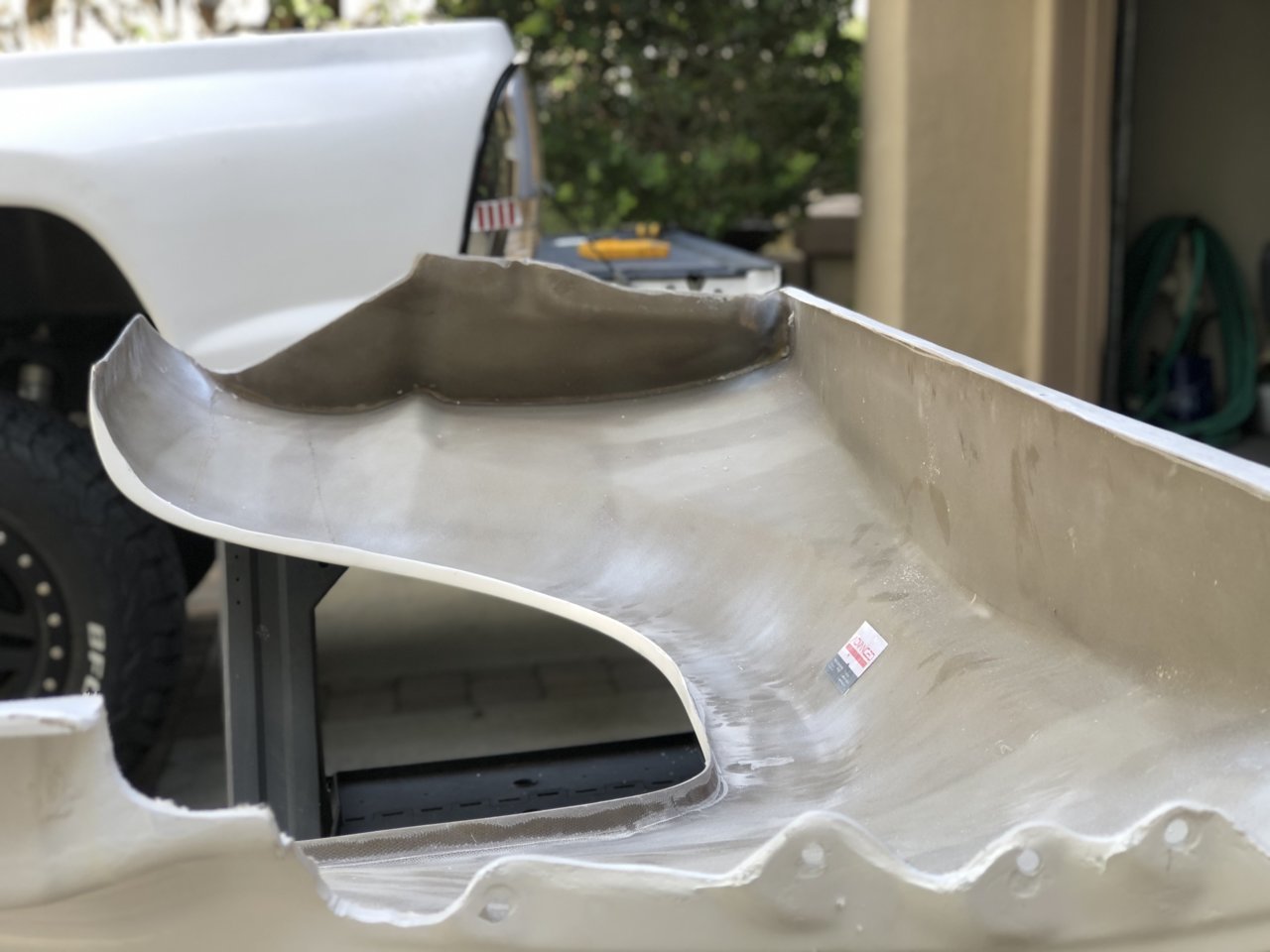

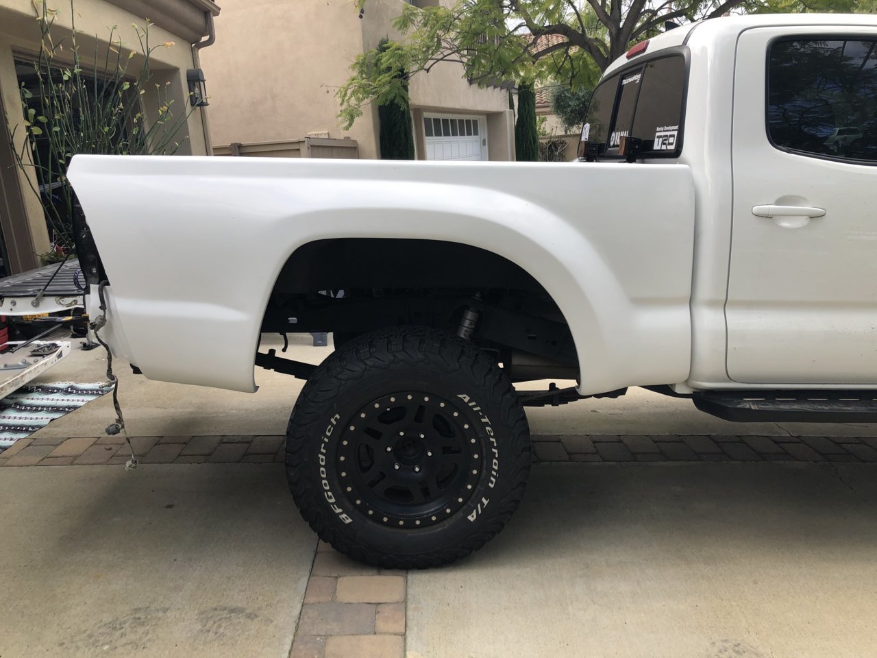

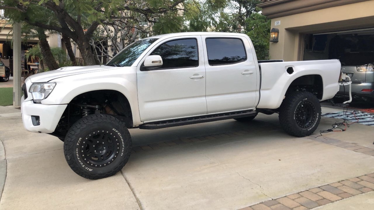

    And a pair of ADV Fiberglass bedsides from Black Friday sales.
    Pants-less:
    One side done...
    Making the poor 33’s look small:(
    Almost done, just bolting everything back up.

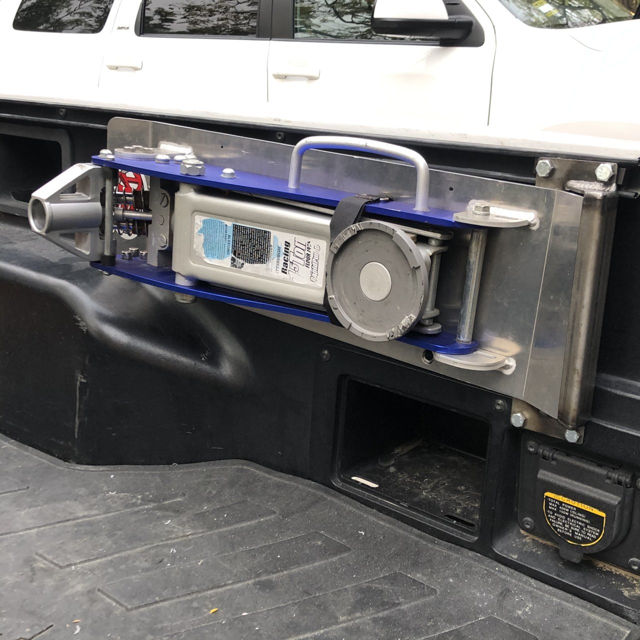

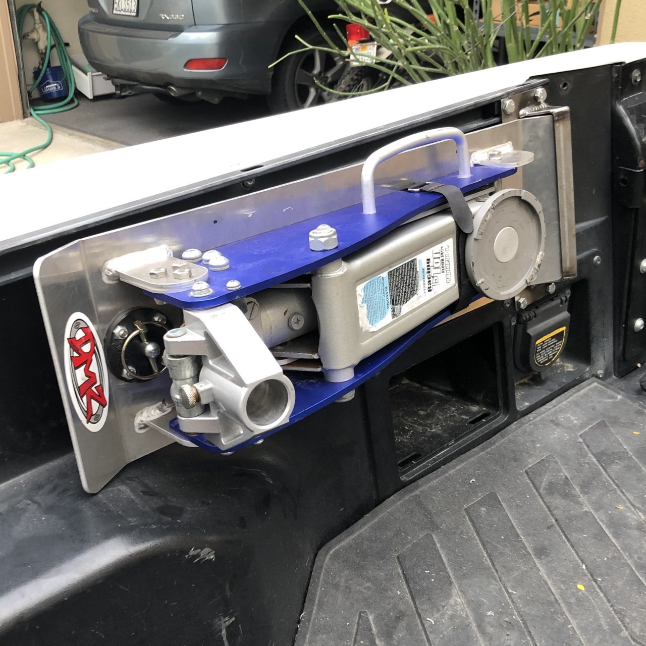

    New jack setup; finally able to actually get the truck off the ground away on a trail or even just driving about.
    • Harbor Freight 1.5t Racing Jack
    • DMZ aluminum skid
    • DMZ front and rear pin mount
    • & the handle quick-fisted to the other side of the bed
    FC757122-E7ED-479B-97C3-8C85F93277EF.jpg 0F2CC183-E303-44BC-80C9-A907AFE4600F.jpg
    A Pro Eagle jack pad has been swapped onto the HF jack, along with their 13” extension that is kept in the cab where the oem screw jack was kept.

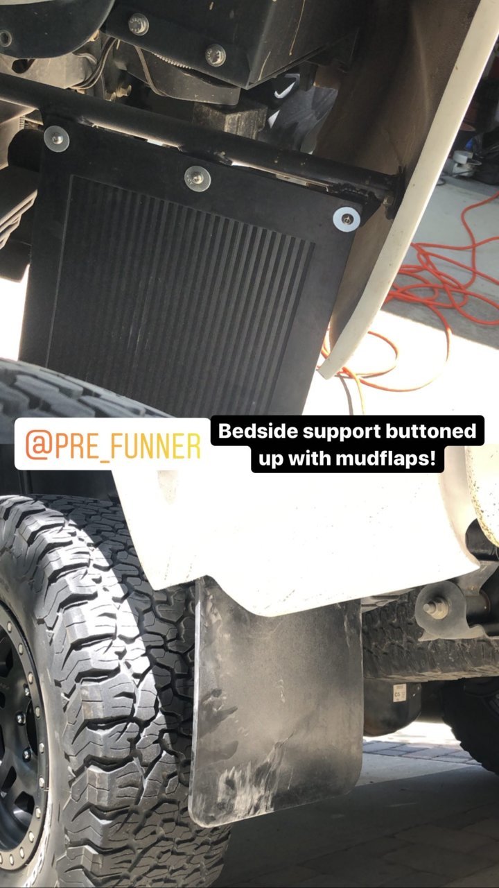

    Finally Bedlined the inside of the rear ADV bedsides like the fronts, looks much better!
    Also made a little bedside support for them that doubles as a mudflap mount as well.

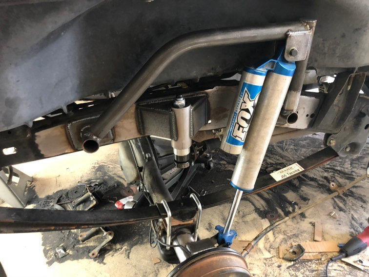

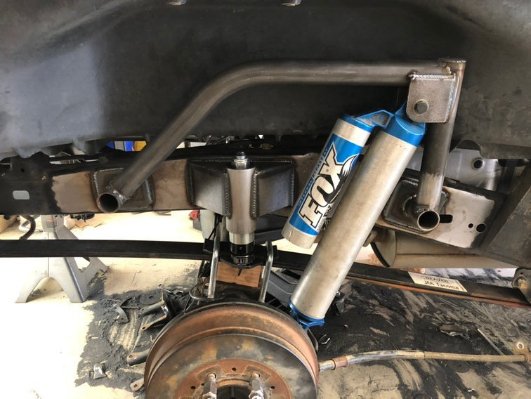

    Decided that links will have to wait for another year or two, so in the meantime I decided to go for a budget midtravel setup.
    Bought some lightly used 2nd gen Ford Raptor bypass shocks, they cycle 12". I also had a pair of Locked Offroad 2.0 x 2" pin bumpstops laying around, so a buddy and I threw those on as well !

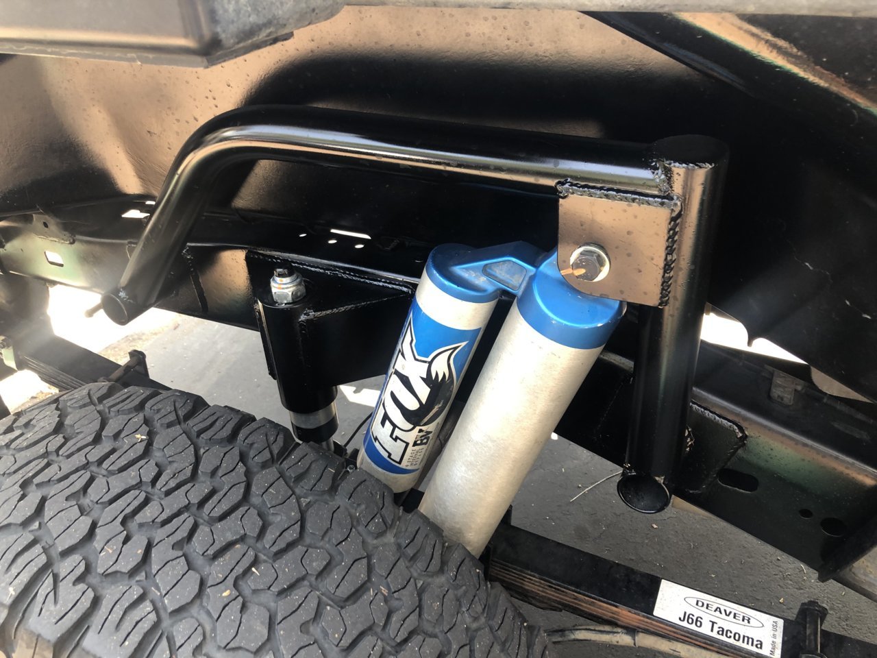

    Old Toyota mounts grinded off and the springs set at bump.
    Simple shock hoop and a beefy bump mound - everything clears and it in its final place!
    Drooped out. The shocks still have more shaft left to extend, as wasn't able to get as much bump travel out of the springs as I was hoping for.
    A few more pretty shots after everything was painted and bolted back up.
    Next this warrants a set of new rear shackles and hangars to get the last few inches of droop out of the shocks.
    Archive Garage, BAMF, TopFab ?
    I don't care as much for strength, as I won't be rock crawling or slamming these on boulders. Mostly looking for increased droop.
    Anyone have thoughts as to a shackle flip or keep the oem style?
    Jowett and ChadsPride like this.
