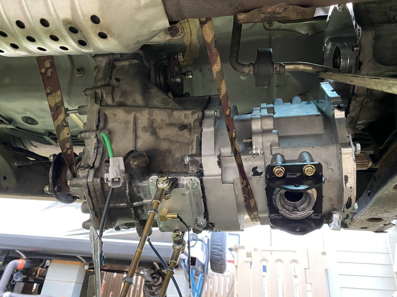

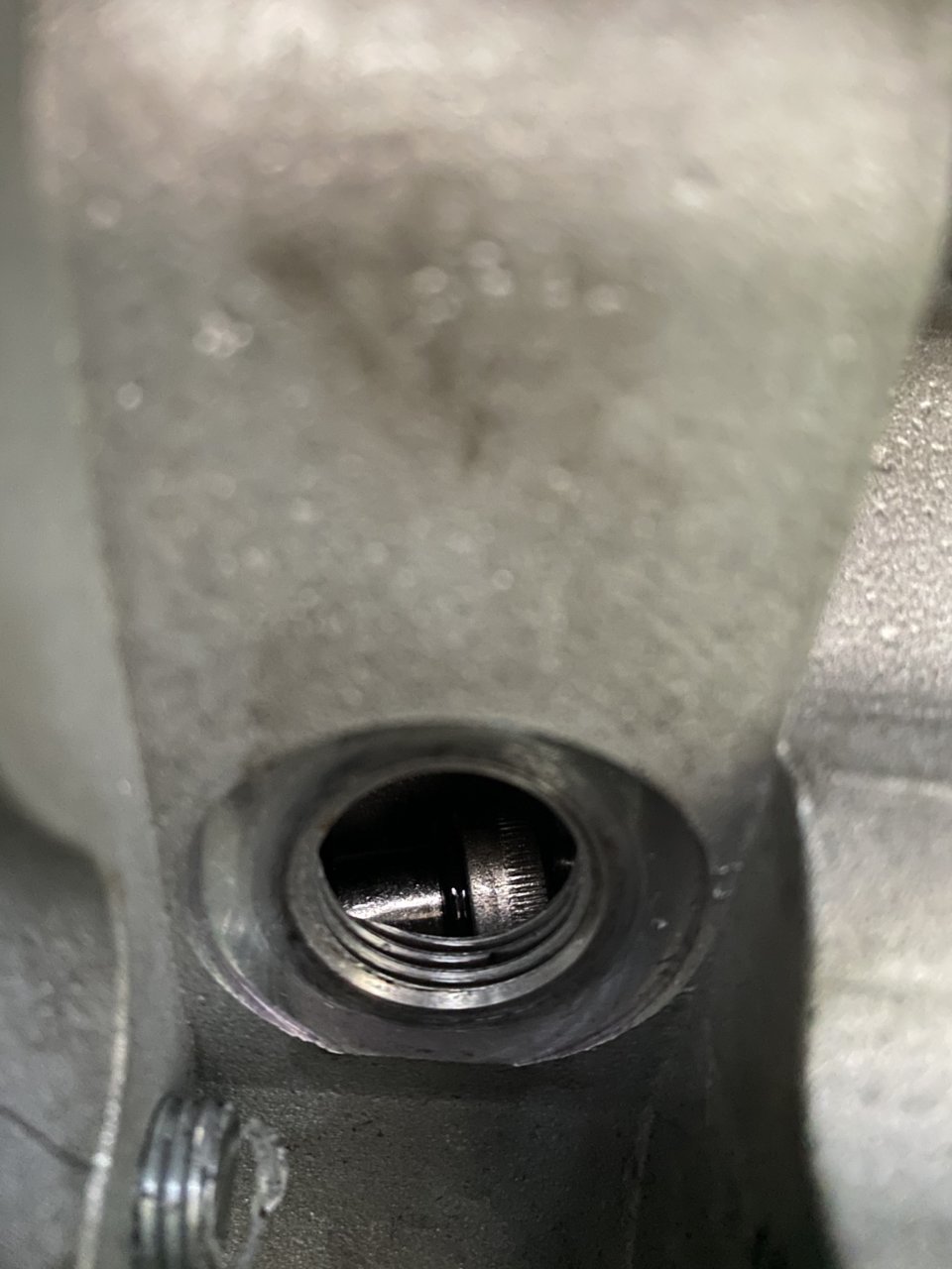

    Well, finally got out to start working the triple sticks.. making a couple templates so to speak, went to hook up the linkage on the third shifter to see where it needs to move... and dropped a bolt into the crawl box, I really was trying to be careful, but was in an awkward position and my arm couldn’t really bend anymore, I think the lack of maneuverability is what made me loose hold of the bolt :facepalm:
    my little magnetic pick up tool is pretty wrecked and comes apart easily, so I don’t feel comfortable jamming that in there and trying to get down to the bottom around the gears where I’m sure the bolt is resting, and I can’t put a magnet on a string either as it’ll just grab whatever the second it’s lowered in.. the drain plug doesn’t is under a different section of the box and I’m pretty sure there is a wall between where the bolt and the drain plugs cavity is..
    Any genius ideas for the village idiot over here? SO DUMB!

    Could pickup a boroscope (think they have some at home depot) and use it to look around from the shifter hole to try and see where it fell to in the case. Then use a good quality magnetic pickup to try and fish it out.
    Otherwise I think you're only left with having to pull it apart....

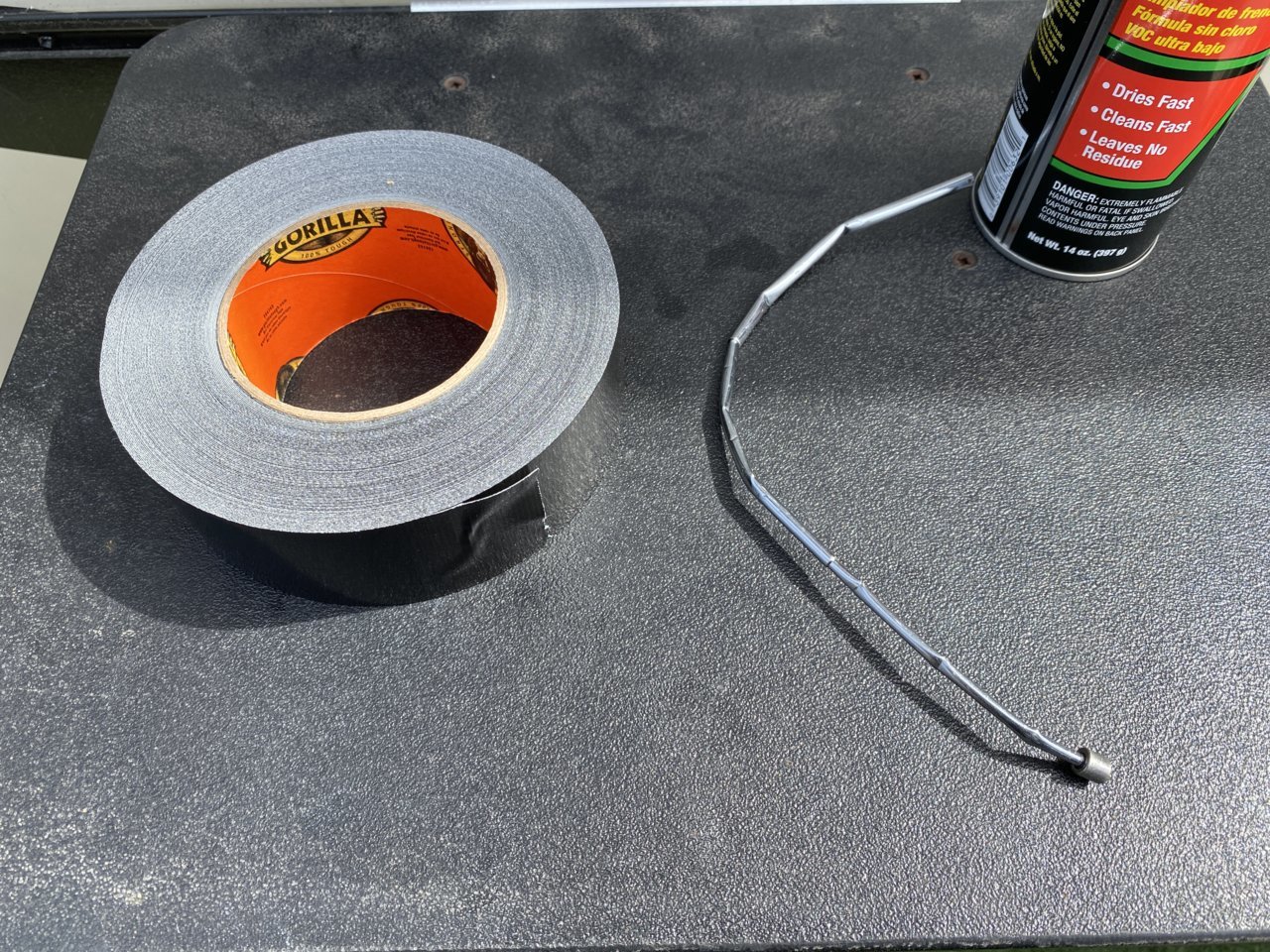

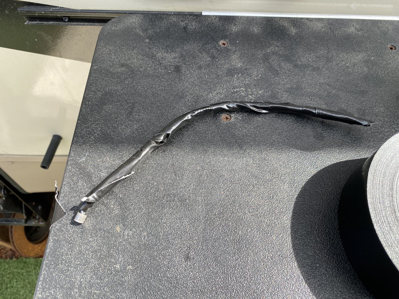

    I’ve got an idea!!!...
    I’m gonna break my already crappy little magnetic pickup tool into little sections so that’s its flexible enough to make but still has hopefully enough rigidity to push and pull on, and then wrap it in gorilla tape so it doesn’t come apart, and go fishing!image.jpg
    time to go see if I get a bite :fingerscrossed:

    Pretty sure I was making contact with it, but it wasn’t coming along.. grabbed the other identical bolt..not magnetic!!! must be fucking aluminum.. GOT to be kidding me!!!

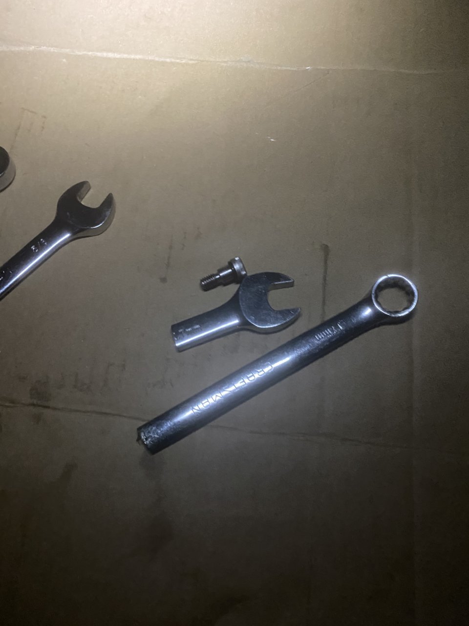

    Thanks man, today was definitely a bummer lol. Ranks pretty high in my “did that really just happen” moments.. maybe even higher than accidentally shaving my eyebrow off..
    :rofl:
    I needed a good laugh, thanks @theesotericone ! And that leads me to this threads first pro tip:
    DON’T DROP SHIT INTO CLOSED SPACES
    Was able to retrieve the damn non-magnetic bolt by rotating the dual cases until it clinked into a spot near an exit point.
    I am out of FIPG and don’t have any other gasket maker so I wasn’t able to bolt things back up, but everything is cleaned up and ready to go back together as soon as a store opens up and I can get more sealant.
    And just to add insult to injury, I sacrificed my 17mm wrench in an attempted shortcut that failed.. today was not a good wrenching day lol.
    One positive note, there were no leaks from the cases while they were upside down apart from the giant hole in the crawl box shift plate and the vent in the Tcase shift plate. Not a real world test, since the oil wasn’t hot or foamed, but I’m going with that as a positive take away from todays adventure in dropping shit into a crawl box.
