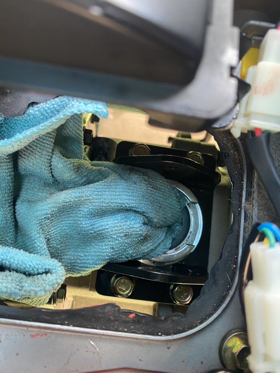

    Painters tape over all the holes!! You will have to adjust those linkages as well after you drive it around just as a heads up. Also put some blue loctite on the threads of the rods, mine used to back off until I did that.

    This. Go ahead and make a removable panel that is actually big enough to get your hand AND the tool you need. Makes fine tuning, tightening up and running electrical/breather hose much easier.

    Like a lunch box with hinges and the snap-close-thingy and some door jab edge protector so you don't slit your wrists with the sharp ass edges...

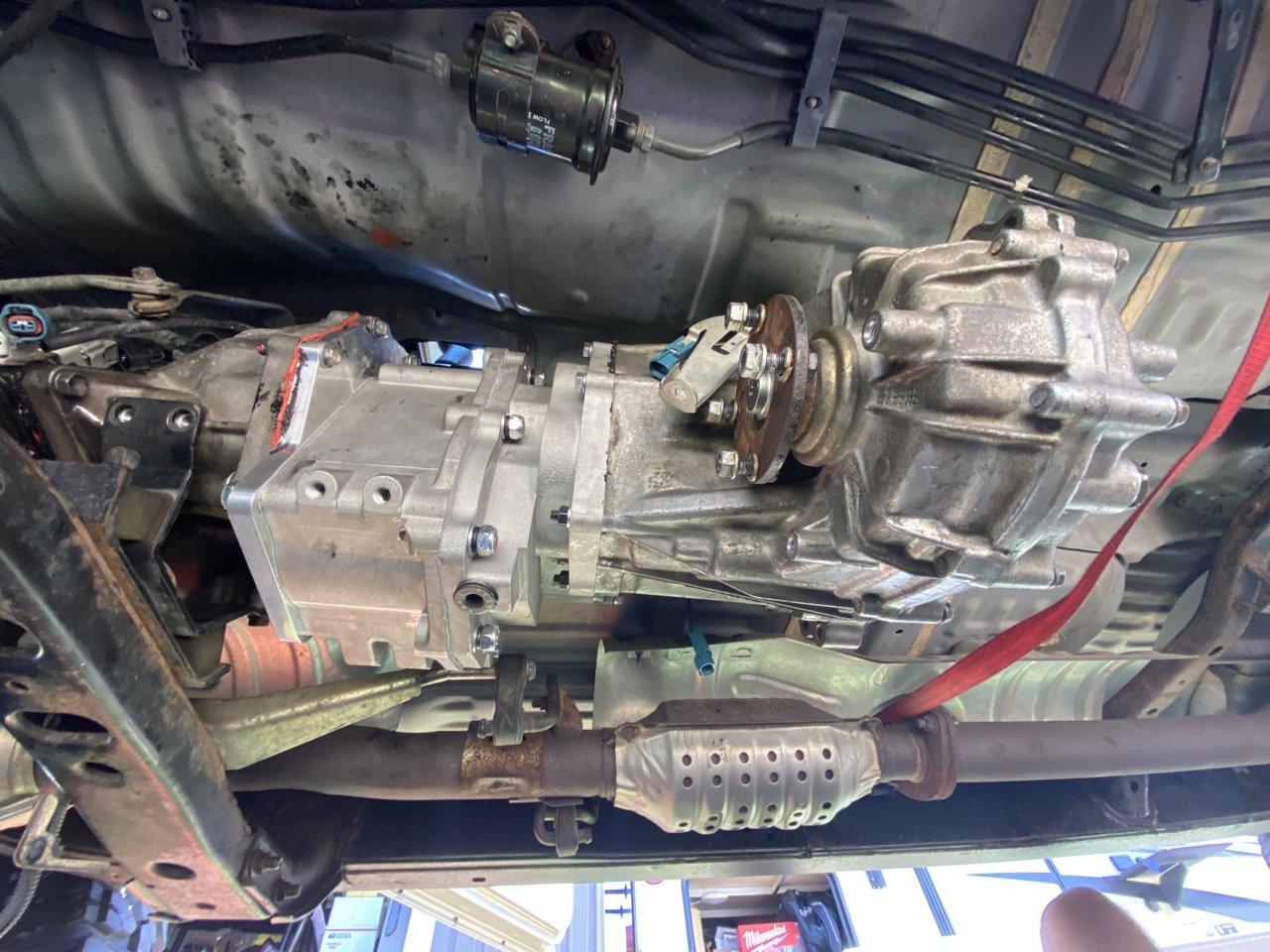

    Finally got out to the truck.. rigged up my ratchet straps to start lifting the cases back up to the transmission.. and BOTH of the ratchets broke. Can’t catch a break over here lol.

    Grab a trans jack before you break the cases or yourself hoisting that up. I don't even like doing it on a trans jack, much less a couple of ratchet straps while I lay under it and wrestle it onto the trans!

    Just called a few nearby auto shops, no one has one at their store :( I’ve got it pretty close via bottle jack a pump or two and some regular pull straps to hold it.. lift a little, tighten strap, lift a little, tighten strap, repeat 967372968 times for front and back. It’s close enough now I’m just going to apply the sealant and manhandle it the rest of the way. Need to get back to the shifters!

    Wrenching friends are invaluable, haven’t had any for a few years now. Hopefully I’ll find a few in my neck of the woods down here. I’ve meet up with some cool folks from TW but they’re all still like an hour or so away, so I’m not about to put out an SOS for that.
    anyways. It’s up again, and now I can pick up where I left off yesterday before everything got screwed, woot!

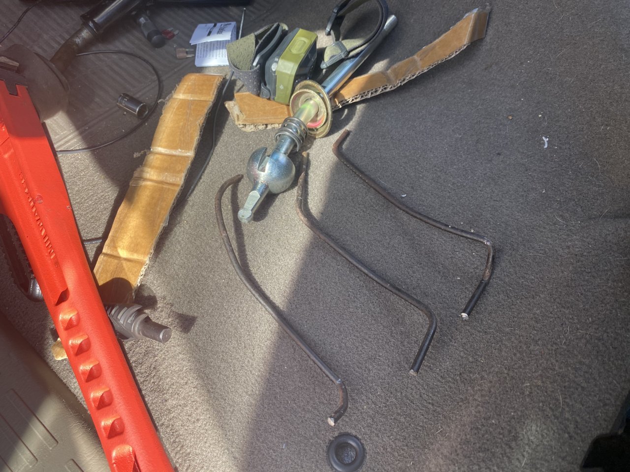

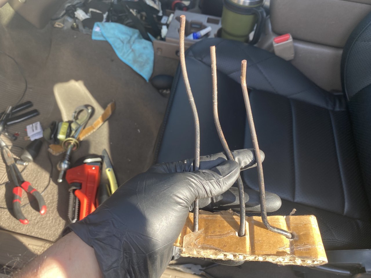

    EXTREMELY rough mock up :rofl:
    92D42089-FC81-407E-922C-523282D31507.jpg F880CD6E-49CF-4C78-8B8B-283755905928.jpg
    There is no doubt in my mind that I won’t be able to actually make these things without a solid bench and vice to bend and hammer the shifters into shape, so now I’m at an impasse.

    This is probably a really stupid question to those that have any experience with metal working.. but I have zero so I’m gonna ask it anyways lol.
    Since I don’t have a vice or a bench to buy one and put it on, and I do have a welder and all the fixings.. could I shape these solely through welding (and cutting/grinding)?
    I think the answer is yes but before I set up my welder and start going ham I’d like to verify with those more experienced.

    Yea you totally could. Just cut where you want the bend, then re-weld the two pieces at the angle you want. Repeat until you have the desired shape you want.

    Thanks @betterbuckleup , that’s what my minds’ eye envisioned, but I wanted to verify before I started hacking these things up.
    Another question for ya.. I have a pretty poor work space, no bench or anything, the area I’d be able to weld at is my concrete slab of a driveway. Is it feasible to just sort of sit down and do this, or should I try to find some sort of robust metal folding table or try to rig something to work on? I usually use my tailgate for bench/table type things, but I don’t want to screw up my bed or the paint welding on it (flux core).
    Edit: I could pick up one of those plastic folding tables at Home Depot, would that be ok to work on seeing as it is plastic?

    If you have a welder and a grinder, anything is possible lol.
    You don't really need a table, just really any kind of work surface. Albeit not as easy as on a table, but definitely doable. I've welded plenty of things on the concrete floor of a garage.
    I'd recommend some sort of clamps or magnets if you don't already have any, so that you can hold the pieces that you're trying to weld together. That or a second set of hands to hold the other piece.
    I definitely wouldn't trust any kind of plastic table for welding. You want as much metal as you can get. Things WILL get hot and will no doubt melt anything plastic. I would think that home depot would offer some sort of metal table or work surface.
    Harbor freight also has a cheap fold-up welding table that I have that works well for things like that. Don't know if you have one near you though.
