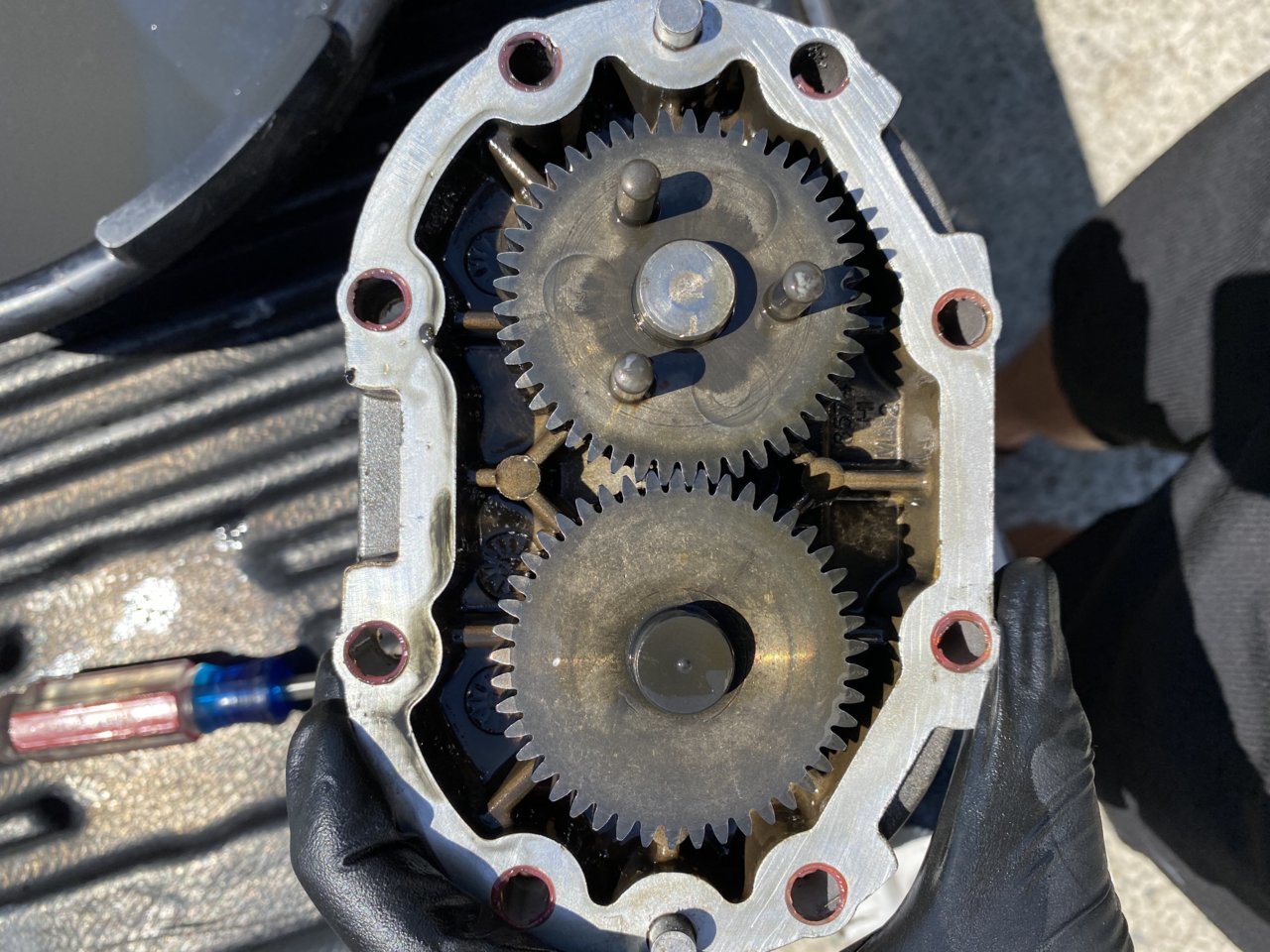

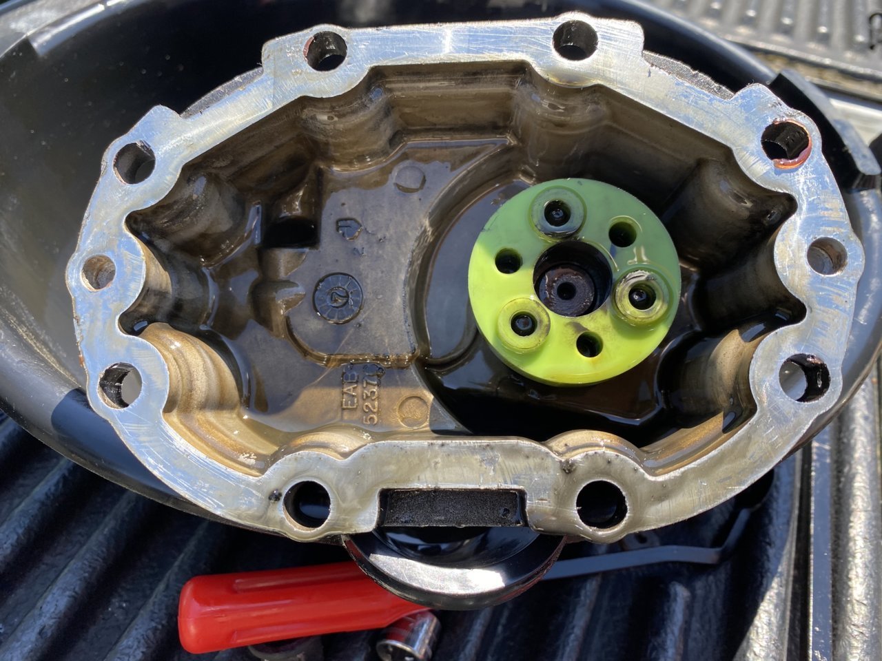

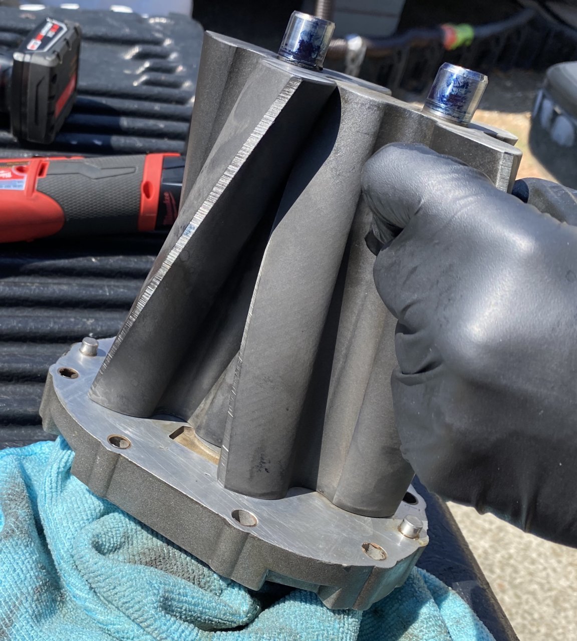

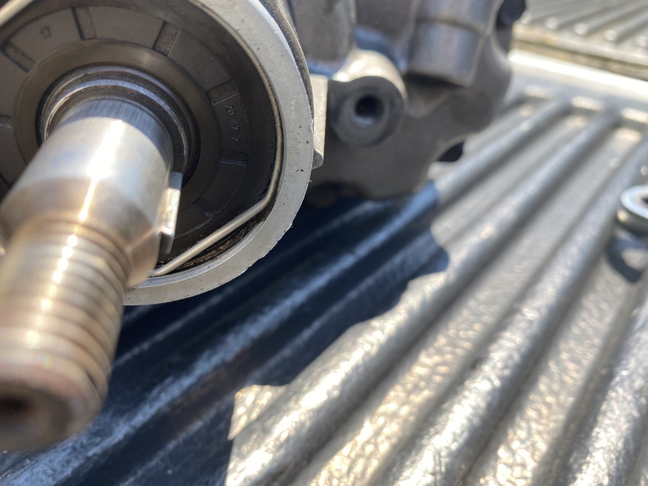

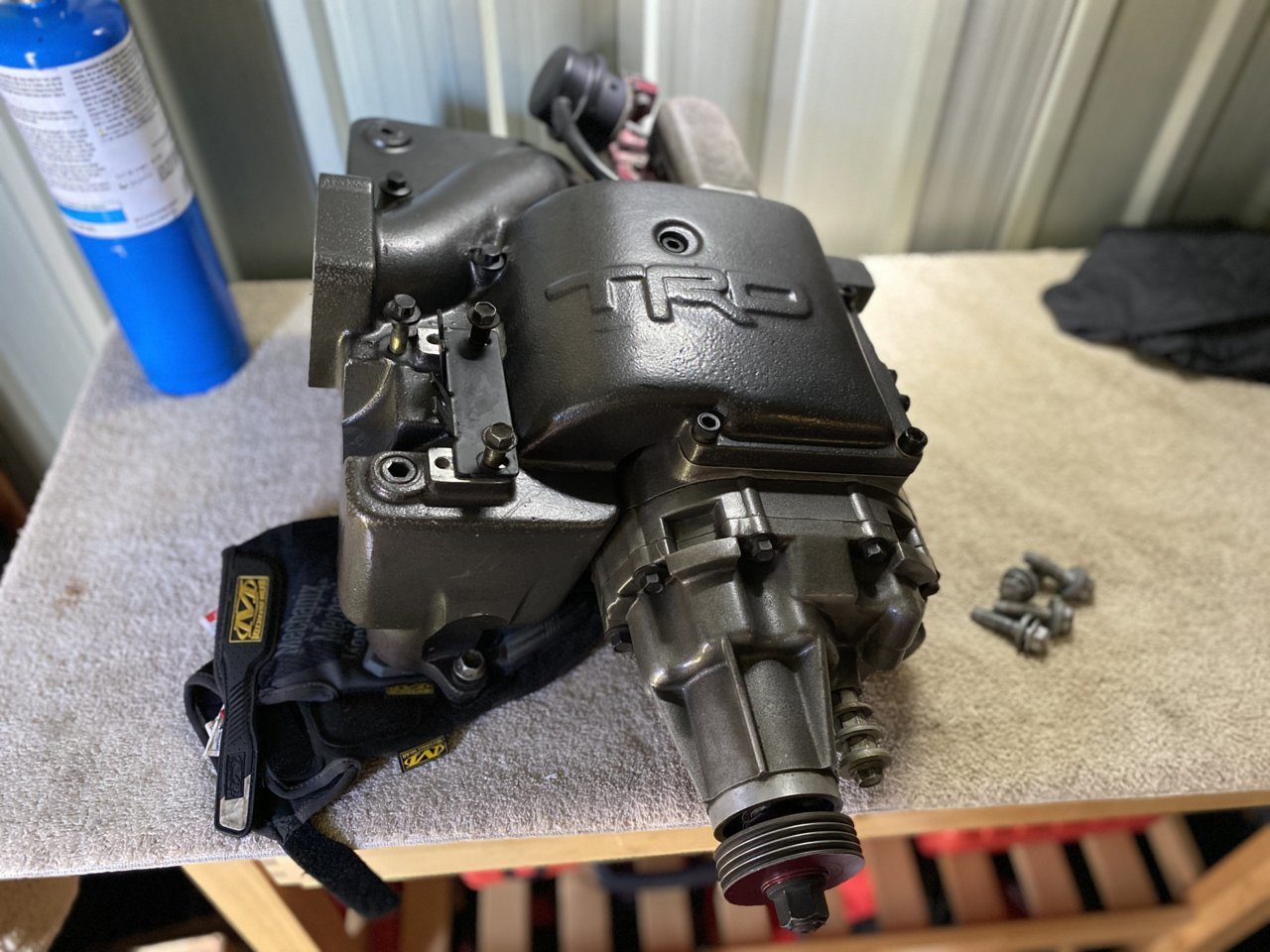

    Well my morning errands ran a bit later than I thought they would, ended up running across the bay for a good deal on an Ultra Gauge from @Dan8906. Decided instead of starting all my cutting and tubbing today I’d inspect my supercharger and try to determine a few things.

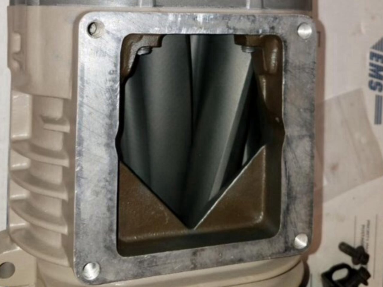

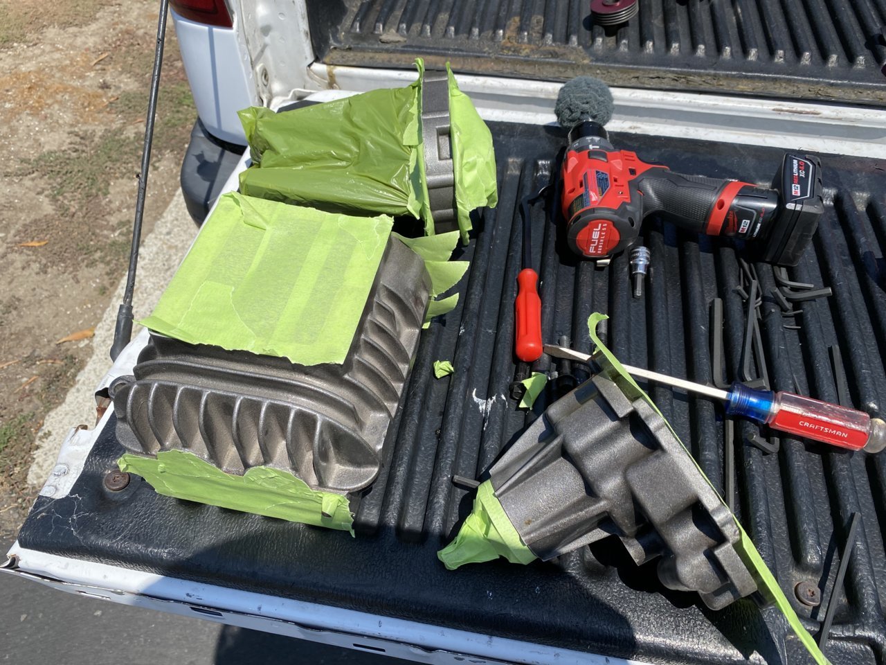

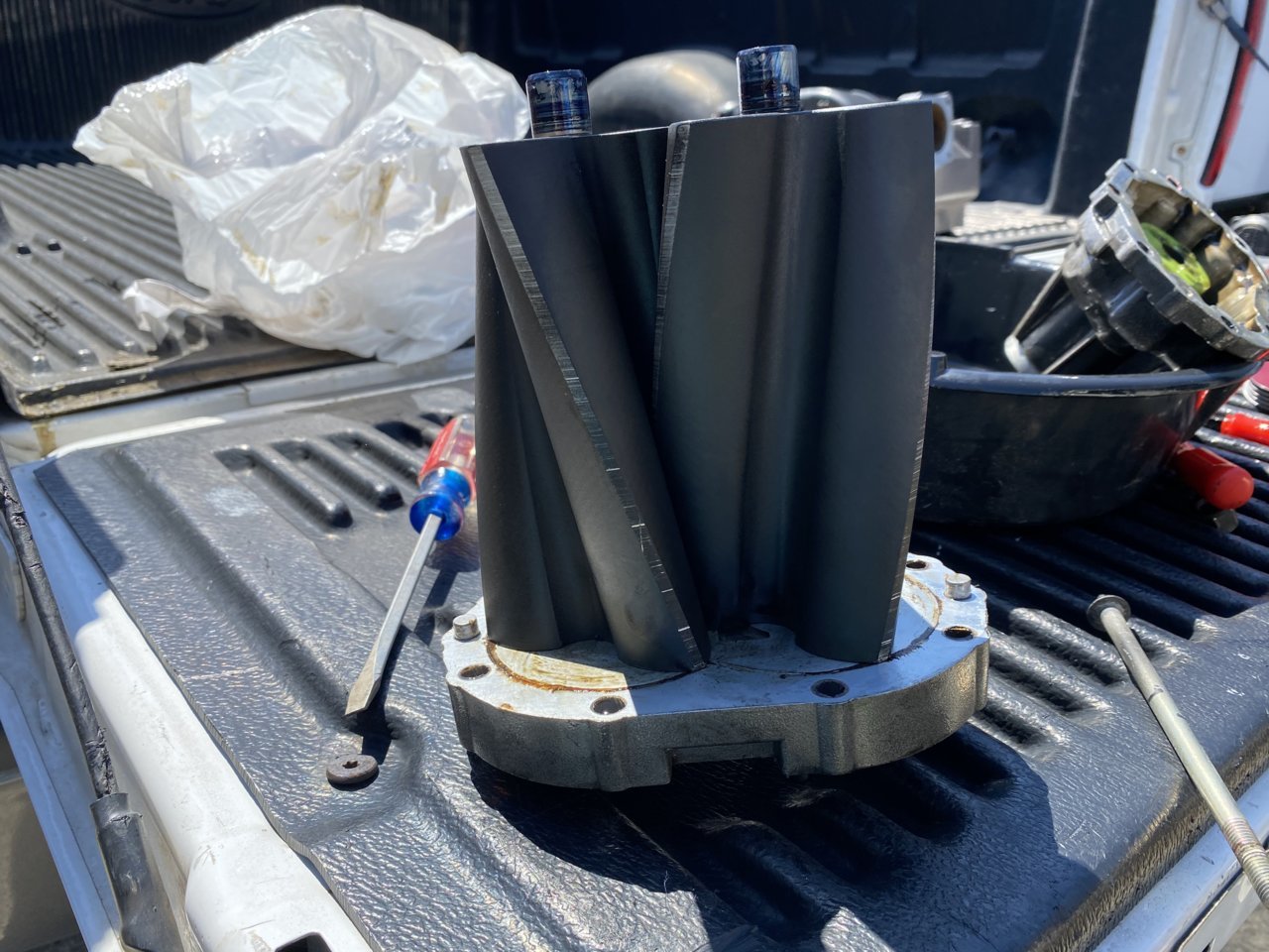

    I posted this in the supercharger thread as well hoping it’ll get some experienced thoughts, but I figured I’d post it here as well since it is build related lol.
    My recently acquired Gen 1 supercharger supposedly was rebuilt and only has about 25 miles on it. Here are my findings.
    Let me know what you all think in regards to condition and whether or not you would run it or send it off for a rebuild.
    I first started by looking closer at the pulley, when I did I noticed there was some oil build up from a slight seep around the seal. I stupidly didn’t take a photo before I gave it a wipe down, but here is what the seal looked like. It appears to be the updated seal, which tells me it HAS had a rebuild, but tells me little more than that..
    Then I took the nosecone section off and got eyes on the oil. One would suspect if it only had 25 miles on it that the oil would be pristine. It was not. It wasn’t terrible, but it was definitely brown, and had a bit of metallic flickering going on. Certainly didn’t look like just 25 miles on it to me. (Take the pan shot with a grain of salt, I’ve done quite a few fluid changes lately, it was wiped out, but not completely cleaned with solvent or anything).
    I then pulled the rotor pack out. I was happy to find a good solid coating still covering the rotors, which further confused me on whether or not this unit did indeed have a fresh rebuild.
    Then I cleaned everything up so I could get a better look at surfaces. I must admit, I don’t really know what constitutes acceptable or not; hopefully some of your eyes can guide me here.
    I put it all back together just hand tight and with no oil, sat it down level and spun it a bit slowly, nothing seemed out of order to me, spun freely without any inconsistencies.
    So in summary. Seal, newer type, but slightly seeping. Oil, not fresh. Rotors good and coated. Surfaces ???. I’m no closer to knowing how fresh this rebuild is other than thinking it was NOT done 25 miles ago (would the oil look like that if it was simply sitting for a long time?).
    What do you all think? Is there something else I should look at in there and get pictures of that would help make a better decision to run this or send it off? Would you run it, or would you send it in?

    Id copy this into the what you have done to your tacoma today in the first gen section, you will get some good response there I’m sure.

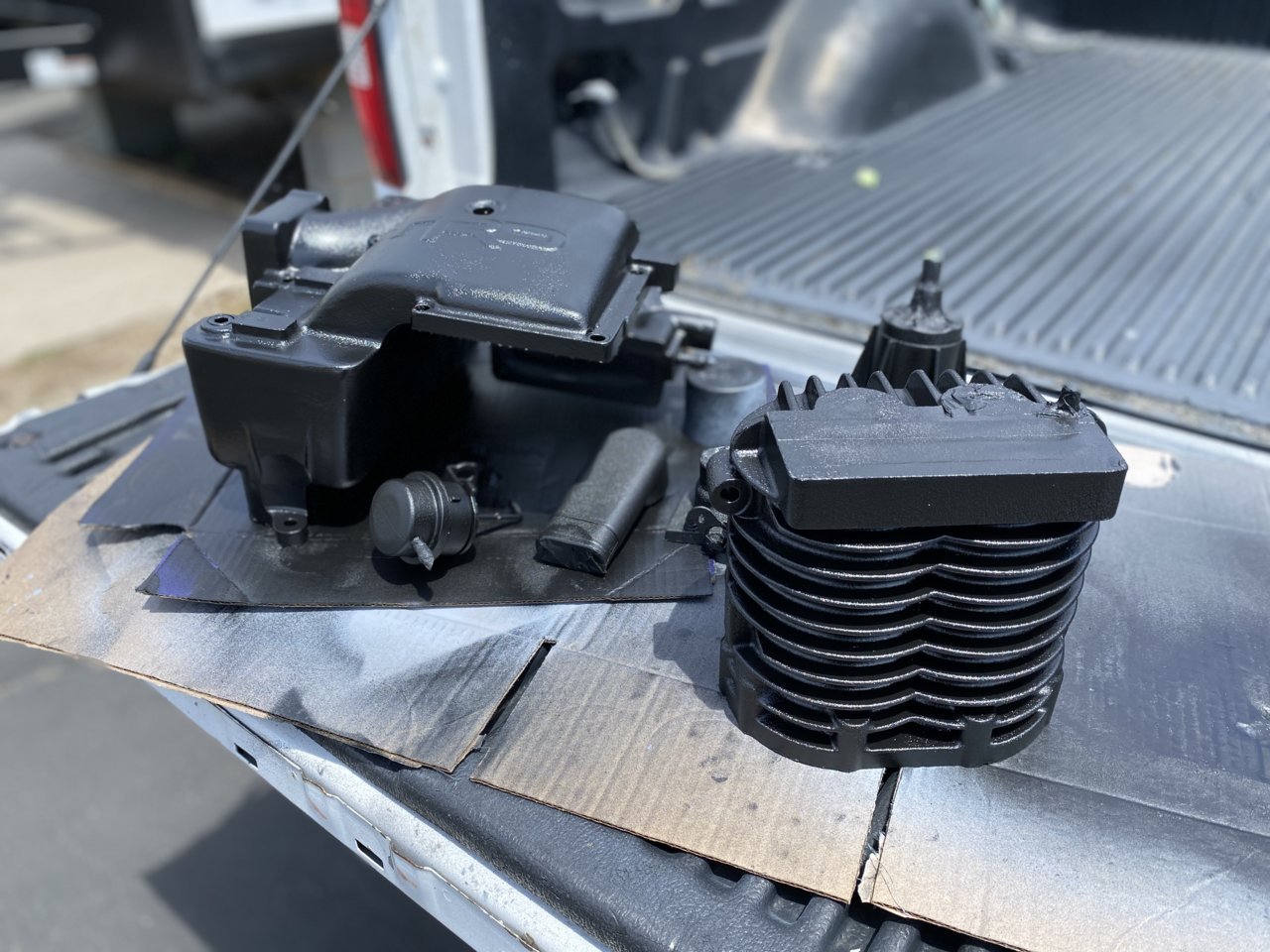

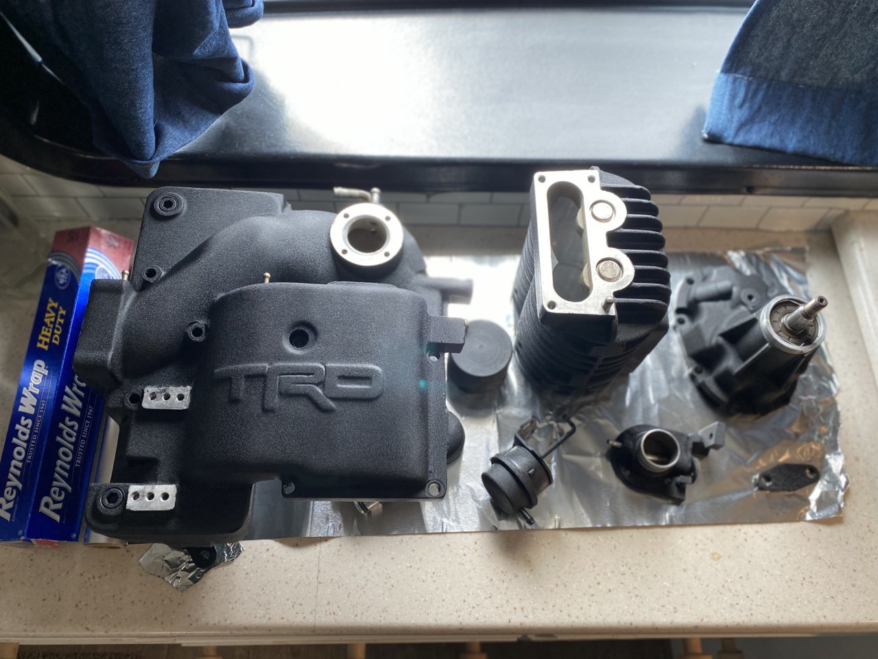

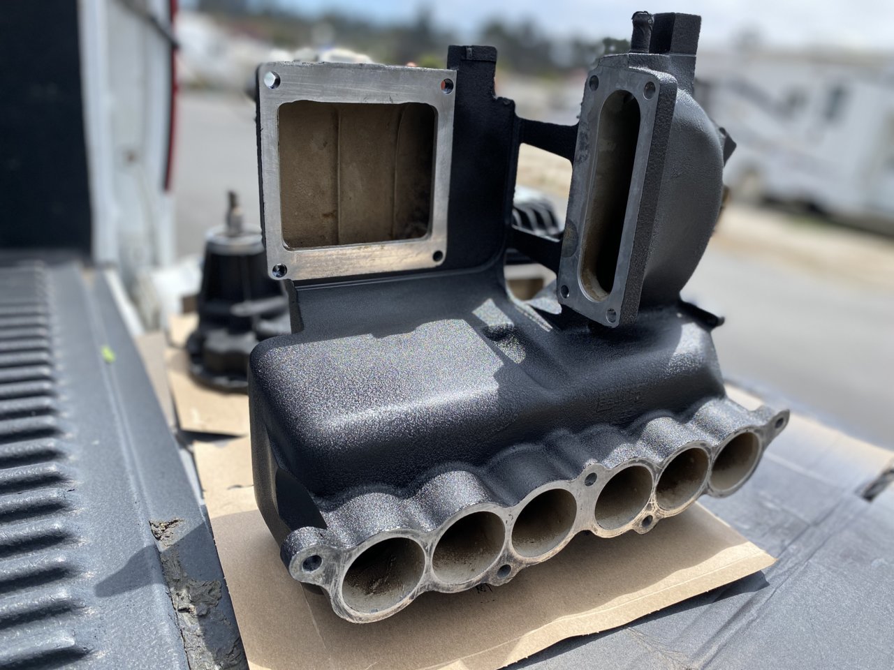

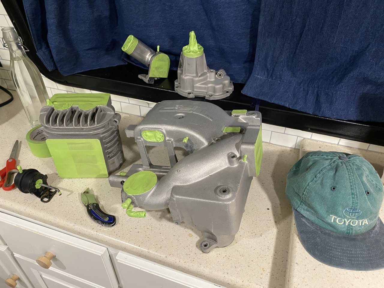

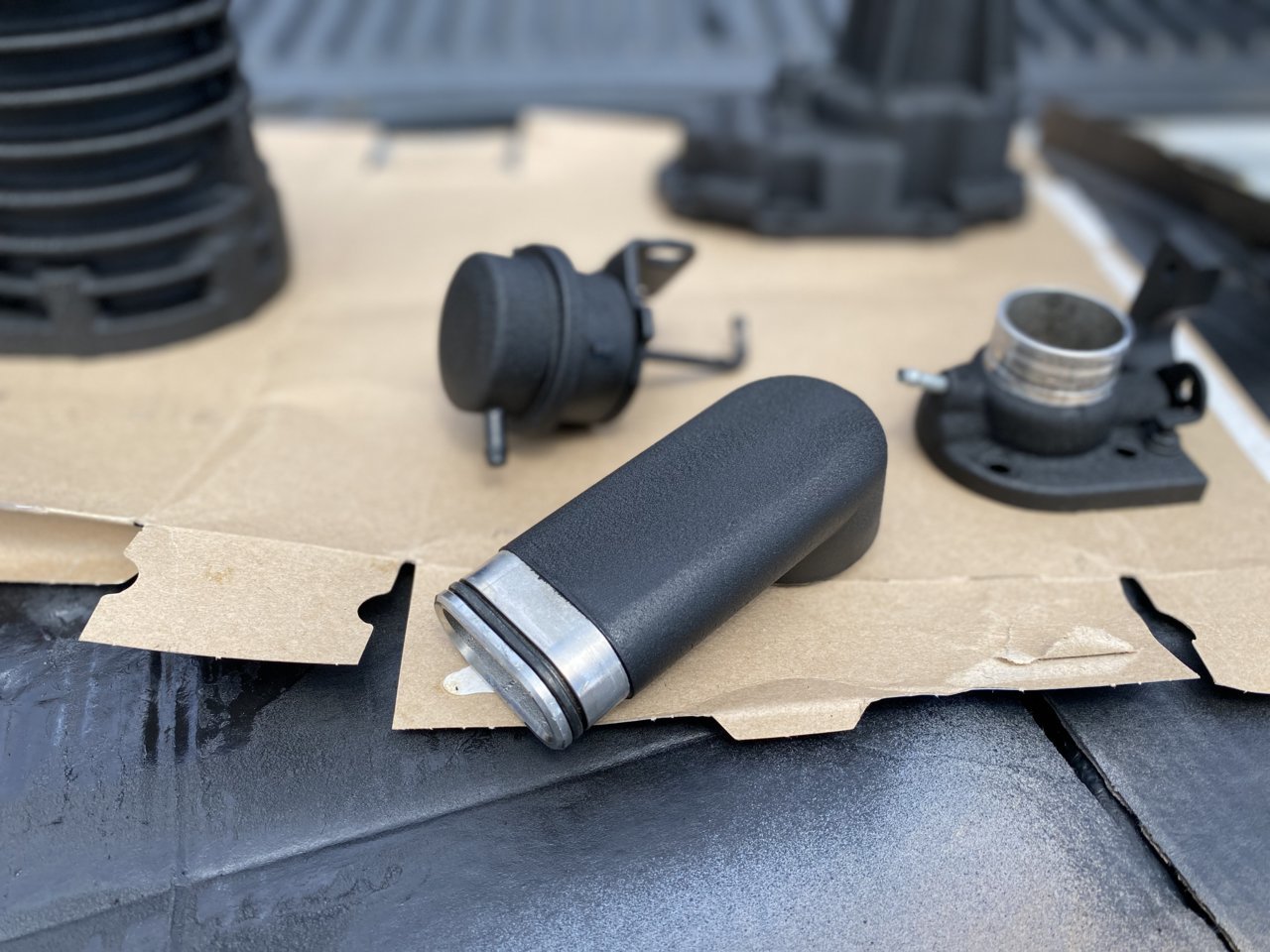

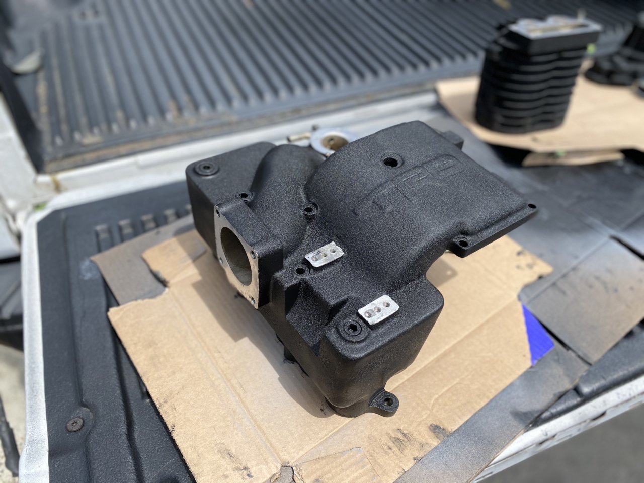

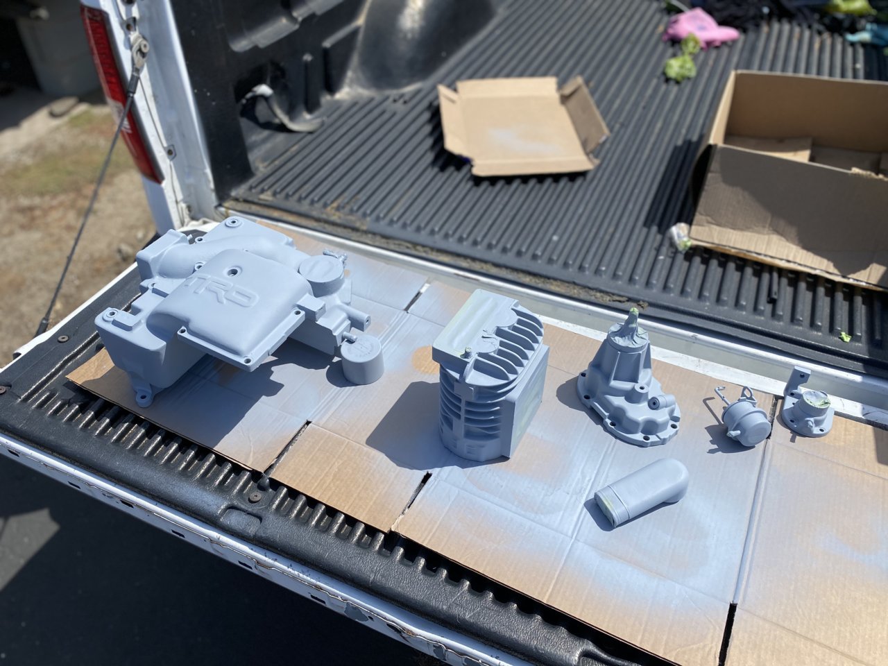

    Going to send the supercharger off to have it rebuilt, it looks OK, but there are a few areas that are less than ideal and I don’t want to put it on and wonder how long it’ll be ok for. Much like I did with the truck when I got it and freshened everything up, I want to know for certain that the supercharger is in top shape and ready for a full service interval.

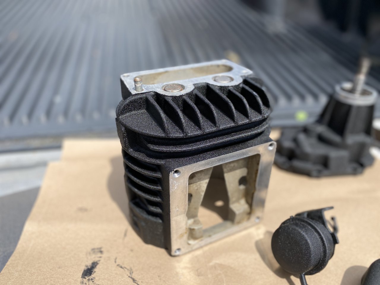

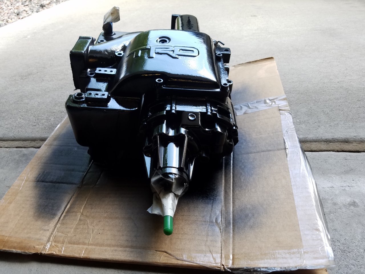

    With that update out of the way, I’ll post on what I did this weekend. The previous owner of the supercharger had it painted, or maybe did it himself, in a gunmetal. I wasn’t too thrilled with it, didn’t match anything else on the truck or in the engine bay, and it wasn’t fully covered, so it was likely just sprayed while fully assembled. I’m kind of a stickler for details, so I couldn’t hang with that. Here’s what it looked like.E0D9B2F9-2A4C-4DA0-A016-68DD5177282B.jpg
    I had considered having it powder coated while it was being rebuilt, but at 400 dollars and with a push in the right direction from @1997tacomav6 , I decided to refinish it myself.
    I started off with disassembling things and taping off internals and other components I wanted to keep out of harms way.
    Once I had everything ready to go I went at it with some paint stripper. Pretty fun to watch what this stuff does.
    After waiting a good while for the chemicals to put in work I took everything to my local DIY car wash and used the pressure washer to blast away as much as possible. The paint stripper and pressure washer combination absolutely rocked! I’d say about 95% clean after one round. I also blasted my arm by accident, only took a split second to do this
    I then used the dryer and made sure everything was bone dry, and came back home to continue prepping. I re-taped everything and smoothed out the remaining areas with some 220grit sand paper.
    After everything was ready I took it outside to lay down some primer. I used VHT products for this due to their heat tolerances. A couple layers of primer had things looking like this
    About 30 minutes later I started laying down some VHT Wrinkle Plus in black. It’s a pretty cool product, you have to lay it down thick with at least three coats in a cross hatch pattern (first coat vertical, second coat horizontal, etc), it looks somewhat regular at first, but as it starts to dry it begins to “wrinkle” and the final outcome is similar to the appearance of powder coat. Here is a picture of what it looks like freshly applied
    It is a very slow drying product, 24-48 hours, so it should continue to wrinkle and become more uniform as the day moves along, but here are some pictures of what it looks like about an hour or two after application.
    4D8C1F56-3AA5-41BA-BE5E-9AC943E24899.jpg F961CB39-4D74-438D-A839-F6D8C0C1B026.jpg BF777FA6-82EF-45A4-AA2A-D44308AAFE3D.jpg 6E5B8311-EA4B-4868-96FC-5A3015304D7B.jpg 389B51F2-74A5-4118-811D-88020498D9AE.jpg 35302164-4367-4C83-8CED-D39D608FDB3F.jpg
    Now I’ll wait a day or two, send off the main unit to have it rebuilt, and when everything comes back I’ll be able to slap in a nice looking supercharger that I don’t have to worry about for the next 100,000 miles or so :thumbsup:

    I like that texture look. It gives it an industrial feeling.
    StevenP[OP] likes this.

    The paint definitely looks great, hopefully it doesn’t get damaged when it’s rebuilt.

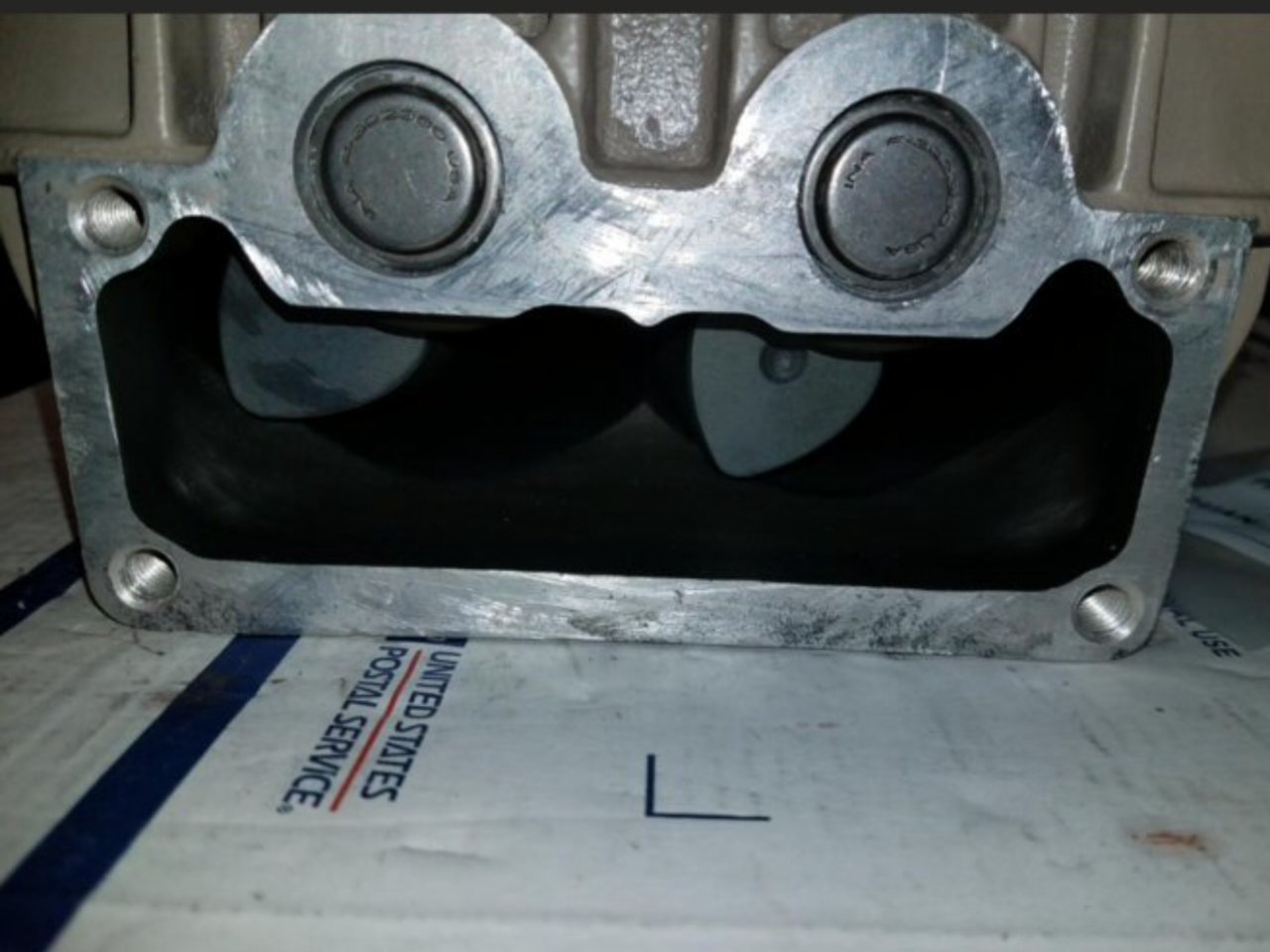

    Also if your getting the supercharger rebuilt nows you’re time to port it.
    Your gain will be about the same as headers maybe a little more and cheaper

    Thanks, it came out pretty good. If it does get dinged it should be pretty easy to touch up, not too worried.

    Unfortunately their porting service (and rotor bore coating service) is unavailable at the moment due to COVID. They said if it becomes available while they have the supercharger they’ll send it off, but as things stand presently those options are unavailable :(
    I’m using The High Speed Lab to do the work. I really contemplated doing it myself, but I just don’t have the right tools or space at the moment to do this sort of thing. Hopefully by the time the next rebuild comes around I’ll have a real shop and the right stuff to do it myself, but after reading about the options and discussing things with a couple different members I decided The High Speed Lab was the best place to send it. They also have a TON of different pricing options for various levels of work, so you can pick and choose what you want and keep costs down.

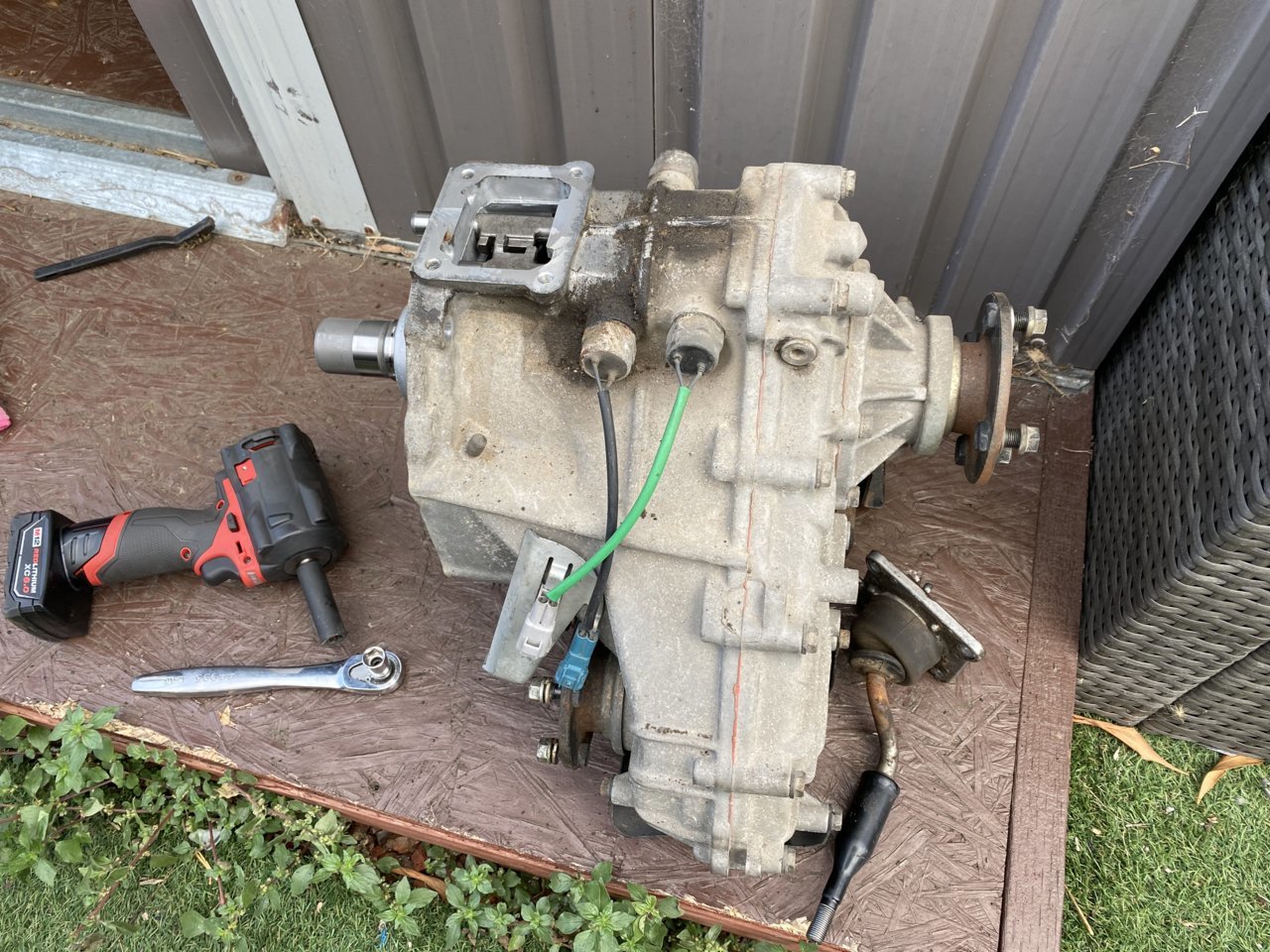

    Working on my dual case set up, got a late start yesterday so I didn’t get too far into it, just kind of got things off the truck and ready to work on today.
    C2814AE7-347E-45AD-95C1-6F3992F03A77.jpg 11D67D11-9388-4C5F-B5F2-7E7A37A2B185.jpg
    I am doing triple sticks from RAD Designs, and trying to find some information. I know I have to grind the nub down on the driver side shift rail, but I can’t seem to find anything definitive on wether or not there is an interlock pin/pill between the two rails that needs to come out as well. Most of the information I come across is about the FJ case and I’m not sure if its the same or not for the 1st gen taco case. Feel free to chime in if you’ve done this before or know about it, I’m going to get back out there and into it soon, if I don’t have to rip to far into it that’d be great.
