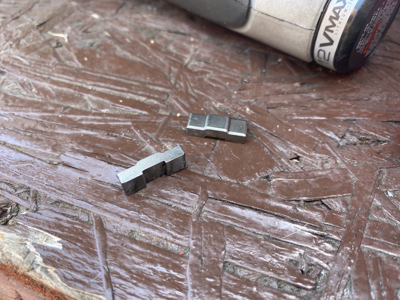

    These fell out.. any idea where they go? Totally fumbling my way through this lolimage.jpg

    02hilux
    02hilux What do you mean there’s no road, I’m here
    Sep 14, 2016
    #197244
    6,193
    Planet: EARTH
    Look like they belong in the tcase. Should be 3 total id that's where they fell from.
    StevenP[QUOTED][OP] likes this.

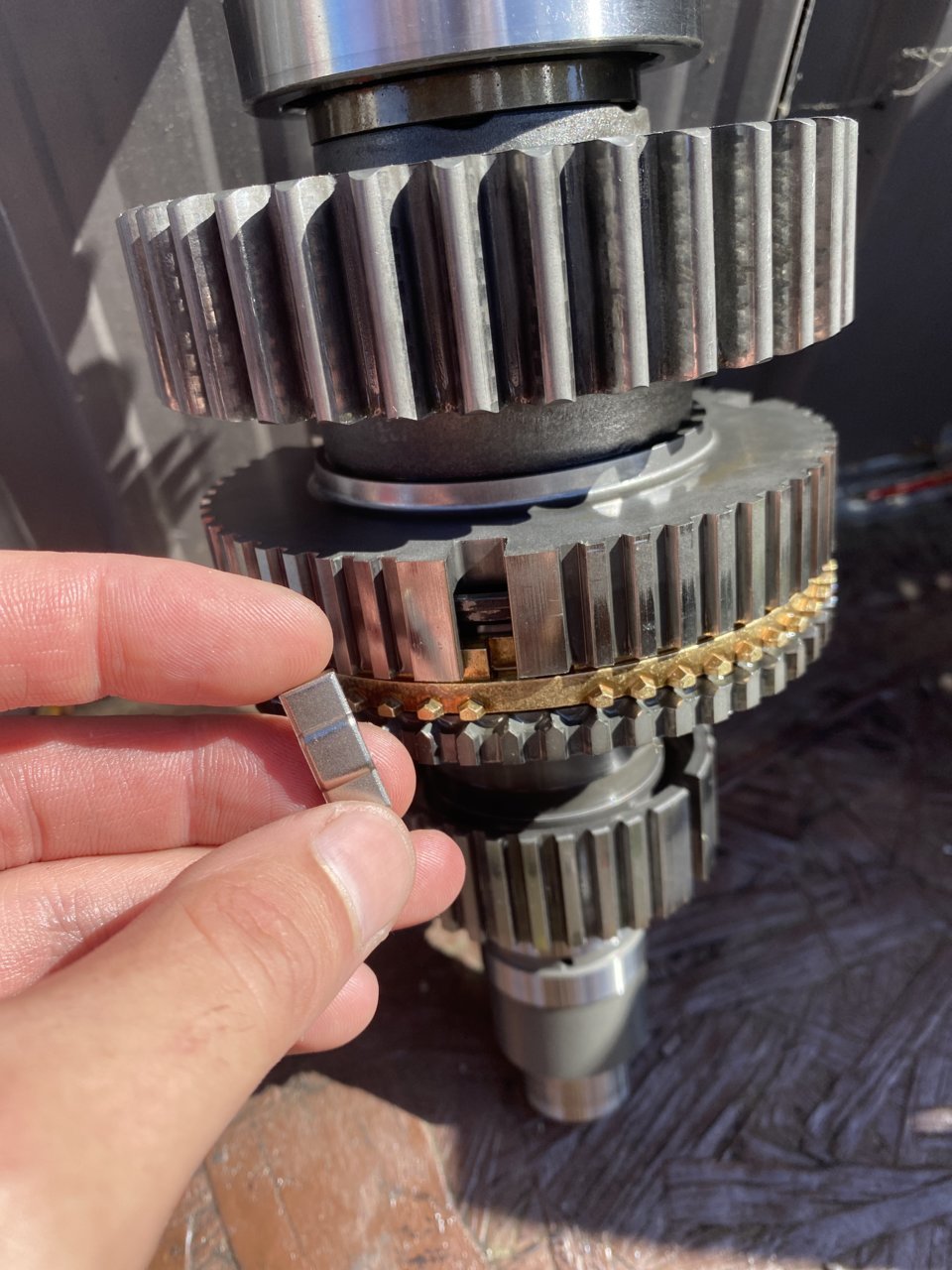

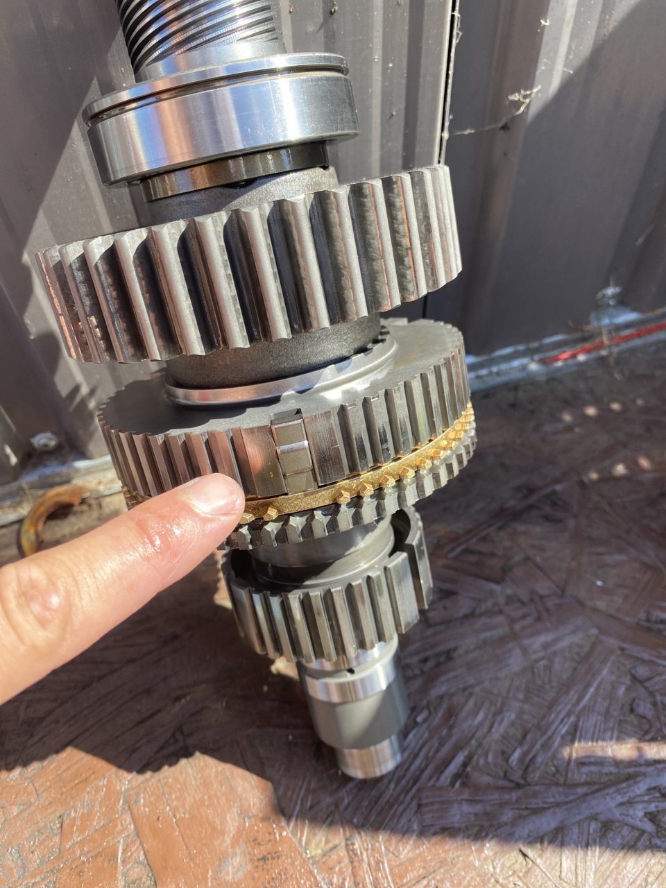

    Well I totally opened it up, and thanks to the help of @theesotericone and @slander I was able to figure out what they are and where they go. Now the issue is that there should be three of them and I for the life of me can only find two.. I’ve looked in every nook and cranny like 20 times and am losing my mind trying to find the third one. At this point I’m wondering if two out of three will do, or if I should abandon them completely. I’ve killed the last several hours on this and need to move forward

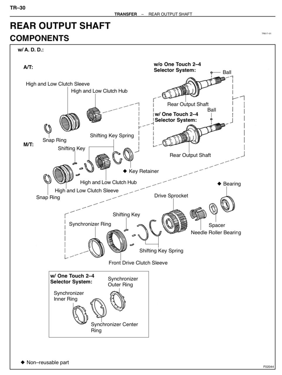

    Here you can see them in a diagram/blow up

    I like the challenge and reward of these sorts of jobs, and have the patience to jump in most of the time, however, it really does suck when you run into something like this.. I mean I’m beginning to wonder if it only ever had two, if the third wasn’t installed at the factory, I’ve looked so damn hard.

    12,357
    Bishop CA
    Mine where never replaced. I can't shift on the fly anymore. Other then that no ill effects. I'm pretty sure 2 of 3 would still allow the planetary gears to align for on the fly shifting. It might just not be as smooth as when you have all 3.

    I’m thinking it’ll work with two as well, I’ve got the clutch sleeve over it and it has good solid function, clicks up into and down into position.. I’m gonna go spend another 15 minutes looking some more and if I don’t find it I’m just going to go ahead with two.
    Pretty familiar with this thing now, if I have any issues I’ll just pull it and take the other two out.
