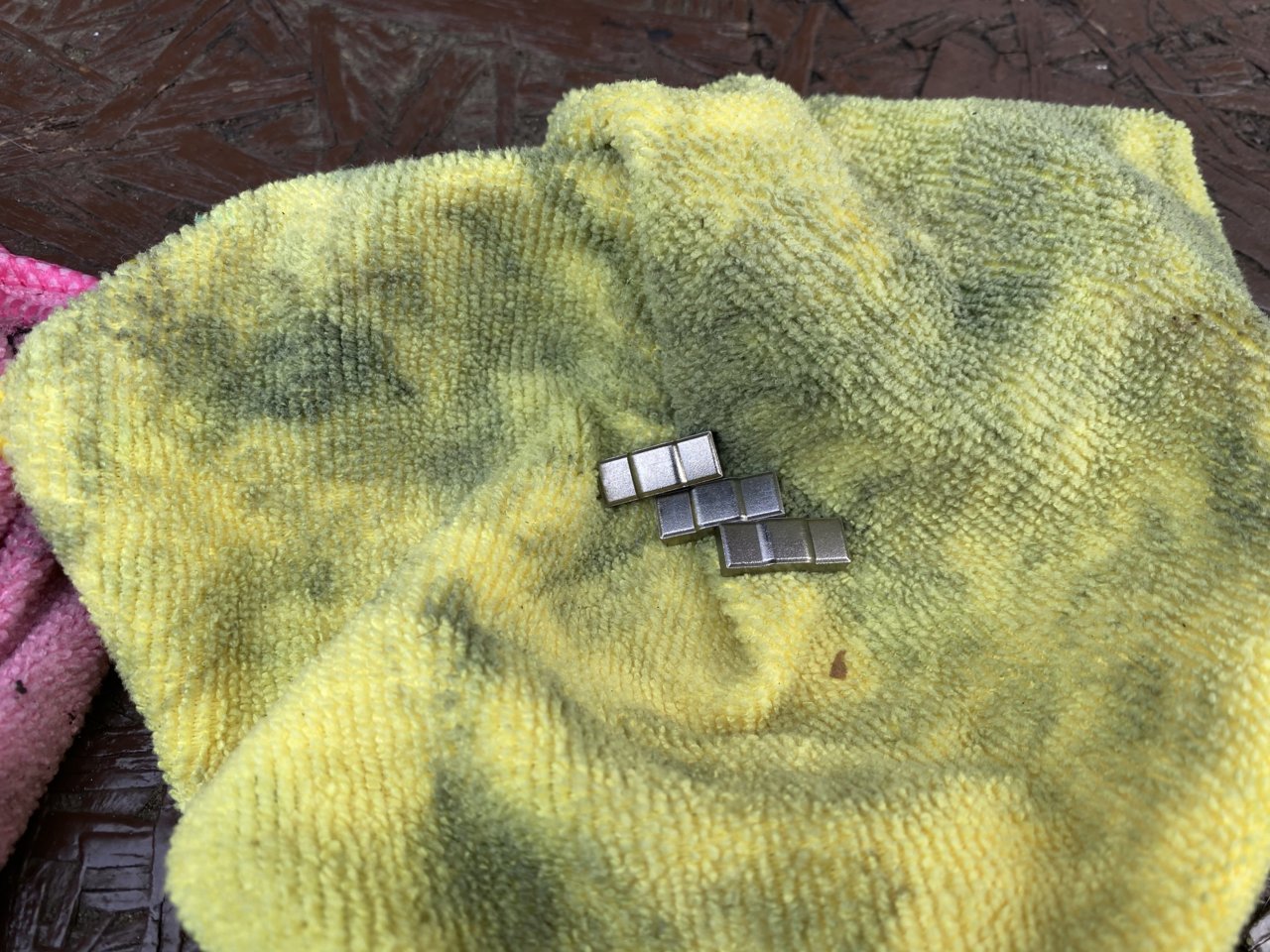

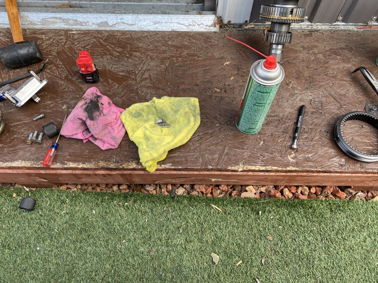

    Haaaaa!!!! Found it after one last try.. now mind you I’ve already sifted through this area at least 4 times, with a magnetic pick up tool as well..
    51B25A36-F973-46D1-A7AD-128F80058AC6.jpg BFD0A1B5-F57B-4EAA-8113-A6D62C60952B.jpg
    see the little gap between fake lawn and shed base floor.. for lack of any actual bench space I usually work here on stuff like this.. it has gobbled things before, but usually they remain on top and are easily found.. I guess this must have found some space between rocks and when I was sifting dug itself even deeper. Glad I decided to give it one more go!
    anyways, many hours later, I can continue with peace of mind.

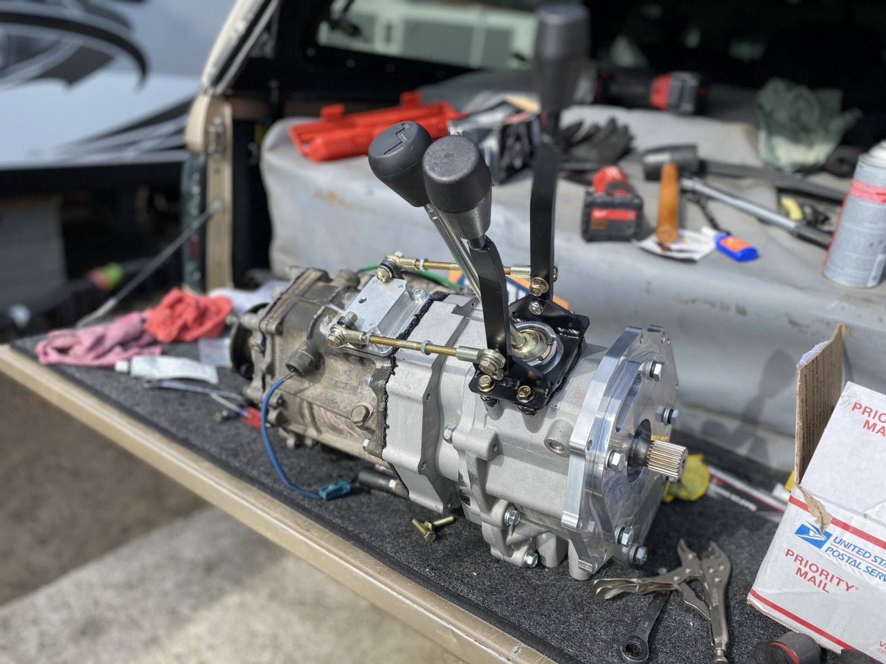

    Made good progress today, didn’t take very many pictures though, my apologies.
    Got everything together, sealed, and ready to reinstall. Everything functions as it should, although there is one strange attribute..
    When I was “bench” testing functionality it was really hard to spin the cases from the crawl box spline, particularly with everything passing through 1:1. I found it easier to spin them with reduction (perhaps that’s the gearing at work?), or I had to spin them from the drive shaft flange. I saw one video on YouTube and the guy seemed to spin his with no trouble, so that did give me pause.. but everything feels smooth and sounds smooth, it’s just hard to spin from the output shaft, but everything functions, all gears, and reductions, in 2wd and in 4wd, so I thiiiiiink I did it right.. :notsure: lol
    Next hurdle will be actually getting it back up and bolted to the transmission. Shit is heavy! I believe @slander mentioned in the crawl box thread something like “use a transmission jack, don’t be an idiot”... yeah.. I can see why. I tried to belly this bastard up there, managed to get it about level, but only having two hands it was pretty pointless - couldn’t align it and slide it home, nor get a bolt in to help hold it. I don’t have a transmission jack, but I think what I’m going to do is run two ratchet straps from frame to frame so that they cradle the front and back of the dual cases, and ratchet it up, I’m thinking this will help not only bring it up to the height it needs to be, but also allow me a little forward and backward motion so I can slide it into the transmission coupler when aligned. If that fails then I’ll wise up and get a transmission jack :homer:
    I’ll need to put in some serious work on the triple stick setup.. all the levers need to be shifted driver side and forward a considerable amount, and I have no vice to put them in for bending, nor a bench to buy a vice for, so I’ll have to get creative there as well. Suggestions are welcome!

    It's going to be hard to spin because you have a bunch of new parts in that crawl box!
    Instead of bending the triple stick shifters, I just bent the crawl box shifter more vertical. I stuck it in a vice and yanked it. DO NOT HEAT IT, it will melt and fall apart.

    I’m going to attempt to get them all into the stock j shift location and save my cup holders and center console run. I was looking at the bends on the stock shifter for a baseline and it’s far from straight lol. I may take them all up to my pops since he has a bench and a vice and go to war with them there, unless I can come up with a way to hold them steady here at my spot with no bench or vice.
    I think if I made the crawl box shifter more vertical they would all pop up through the cutout in the floor, but I’m not sure they’d get to the spot I’m hoping or have enough movement to shift.. have to get the cases bolted up first to see exactly what needs to be done. I’d be thrilled if it worked out with just straightening the crawlbox shifter!

    Curious on what exactly you do to the shifters to make it work, cause i'll be going the same route with the triple sticks and trying to stuff them in the factory spot.
    From what I've read, you might also have to clearance the tunnel with a BFH or something make room for the shift linkage.

    Thanks @betterbuckleup , I kind of dropped the ball yesterday on pictures, fortunately the stuff that went down yesterday is pretty straight forward and documented well by other folks.
    I’ll do better with the sticks, because I think it’d be nice for those like you who are going triples and want them in the stock location to have a little more information. There are a handful of pictures from other members who have done it, and that’s been enough to give me a rough idea of what I need to do, but I’ll try get a bunch of photos and post a more step by step walk through on it.
    As far as the clearance issue goes for the shifter linkages, I’m hoping that my 1” body lift will provide enough room, but even if it doesn’t I doubt I’ll have to go too crazy with a hammer. I’ll try and get some good images of that as well :thumbsup:

    basically it's keeping the stock crawlbox shifter (which goes between the t-case and transmission), and converting the stock t-case to a twin stick and moving the shifters up to where the crawlbox shifter is. So that you have "triple sticks" all in one place.
    Twin stick is this: one stick is 2wd & 4wd, and the other is high range & low range.
