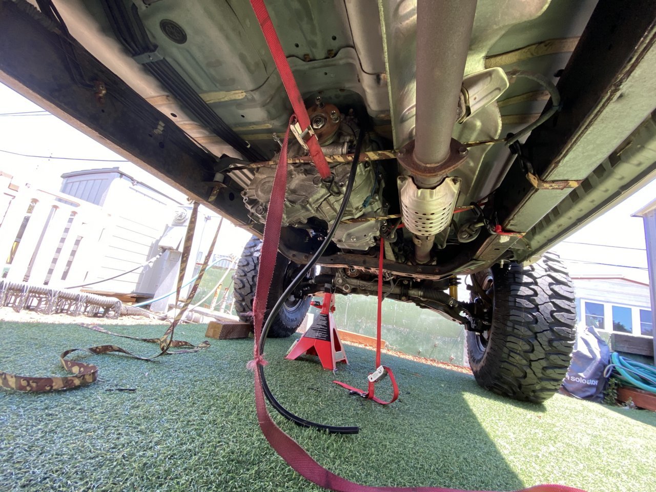

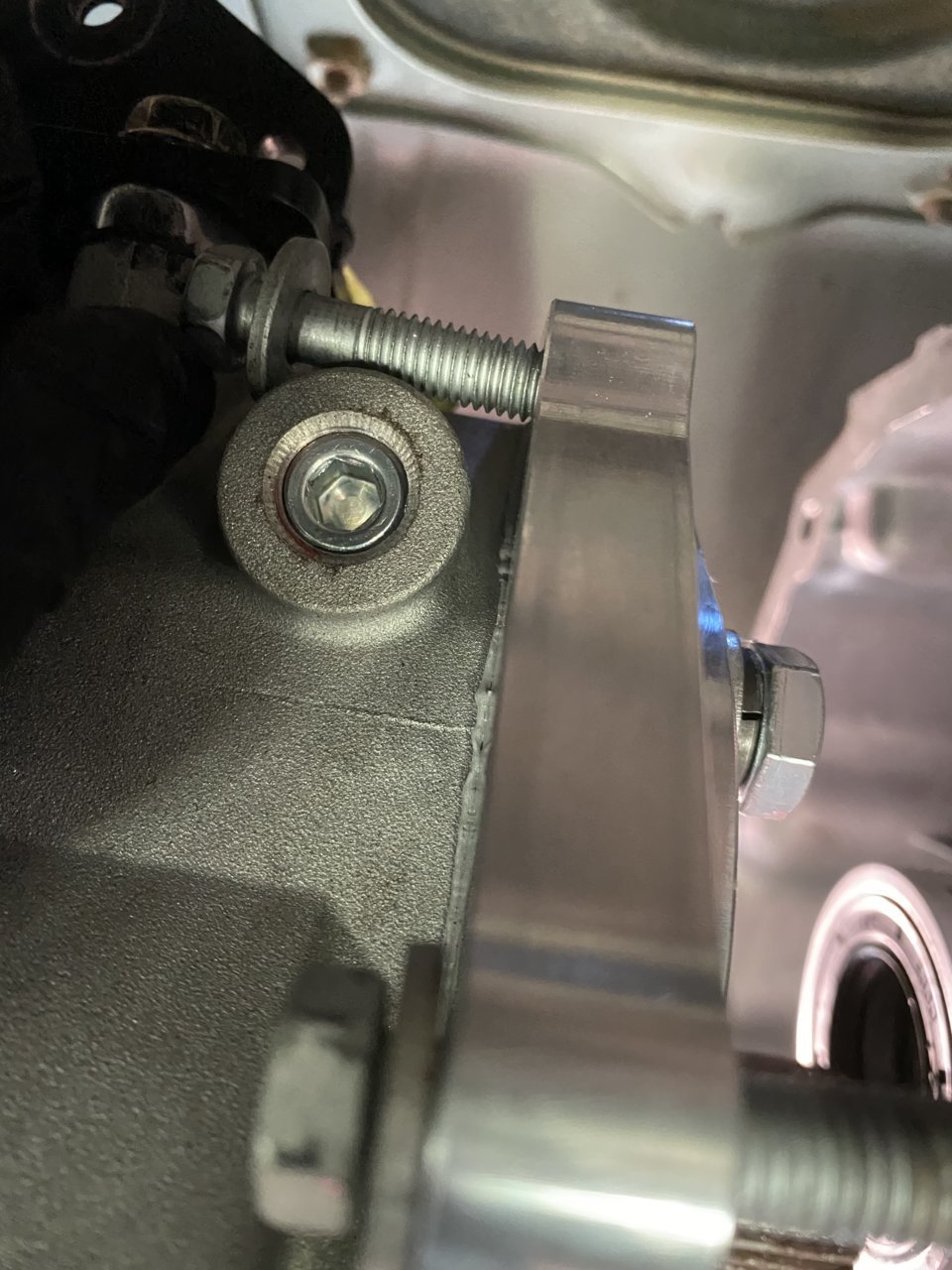

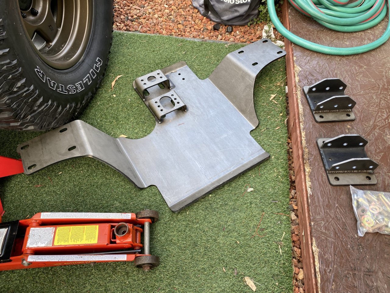

    I unboxed the Trail Gear Crossmember.. good lord, this thing is insanely beefy.. 91 lbs of 3/8 plate! It’s a super nice piece, but after pulling it out and pondering I’m having second thoughts. I have bud built skids, and the belly pan spans that whole region, I’m thinking I may just modify that to act as support and sell the trail gear piece. 124 lbs for the entire bud built skids from front bumper to gas tank vs 91 lbs for ultra beef under the cases. If you’re interested shoot me a PM, I got it on sale, and will give you the same price :thumbsup:

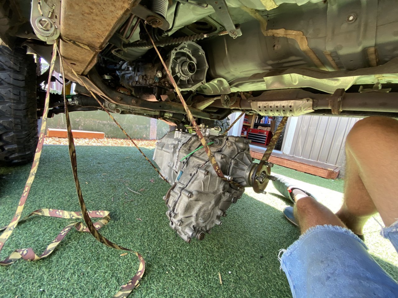

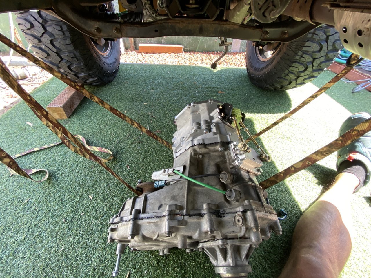

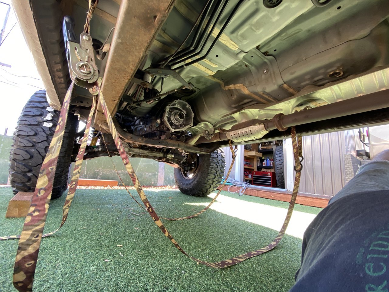

    I then started to devise a method of lifting the dual cases up the transmission. I figured I would use a couple ratcheting straps at the front and rear of the case and try to lift it up evenly. Eyeballed the positioning, and laid them down.
    Then I dragged the cases over and tried to find decent placement for the straps on the underside. Once I had things relatively set, I began.
    It got a little tospy turvy at times, and I had to reposition it a ton of times along the way.
    Once I was closing in on the transmission I realized I need a way to keep it off the tail housing, so the splines didn’t put in work on the mating surfaces or the seal. So I busted out a few more straps lol
    This all went down relatively quickly, and I was feeling pretty good, patting myself on the back, thinking “ok, just gotta bolt this sucker up”. But I began to look at things and had to stop and pause and search out some answers.

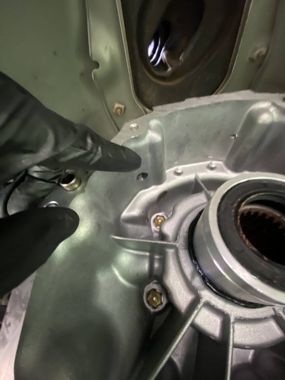

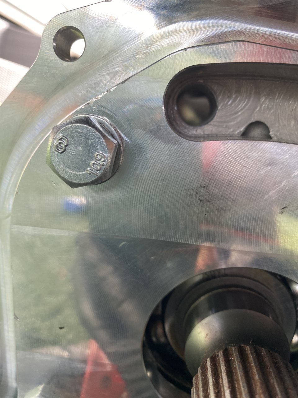

    I wasn’t sure whether or not the tail housing to crawl box was supposed to be sealed. It didn’t say anything in the installation instructions, and the stock set up doesn’t have any gasket or sealant there between the trans and the t case.. I had a feeling it would need sealant, but wanted to double check.
    I also wasn’t sure about how the crawl box vented to atmosphere. The stock Tcase has a breather thanks to the RAD Designs Triple Stick set up providing a 1/8th NPT port on the shifter base (the stock shifter base also has a vent.. now had I paid more attention when pulling things a few days ago I would’ve known the answer...). But the Trail Gear shifter base that goes on the crawl box does not have a port for vent so I was concerned.
    I called Trail Gear and they told me that the tail housing to crawl box definitely needs sealant, and not to worry about the crawl box, that the units would vent together. I posted that up with a bit of skepticism, and @wrmathis confirmed that there would indeed be no joint venting between the tcase and the crawl box since the tcase is a sealed unit.
    I forgot to ask Trail Gear about this issue.. there was no way in hell the stock hardware was going to get past that hump for reassembly.
    I scratched my head for a while, and dropped the cases back down to the ground. I took the stock hardware and cut it down into a stud and put that into the tail housing and found an appropriate nut to use on install. Then I took off the crawl box shift plate and looked for a reasonable place to drill and tap a port. There wasn’t a lot of room, so I grabbed the old stock tcase shift plate thinking I’ll just clean this up.. cleaned it up, went to check that it worked with the triple stick plate, all good.. but my dumbass forgot that the crawl box is from an older truck. None of the holes lined up.
    Thats when I started looking a little closer, and if you’ve been reading my ramblings to this point, this is where paying attention while I pulled the stock Tcase on day 1 would’ve saved me a lot of time! The stock Tcase, with that damn vent port on the shifter plate, connects to the tail housing, which has a vent!
    So I just needed to to see if there was a channel up high between the crawl box and tail housing, and sure enough there is, thanks to the empty slot for the passenger side shift rail
    With all that wasted time out of the way I filled up the cases to do a little leak test, so far so good, and ratcheted them back up, applied FIPG to the tail housing, and bolted it up. The light wasn’t very good, and my hands were a disaster, so I didn’t grab my phone for any more pictures.
    Tomorrow I’m going to work on the triple sticks and getting them where I want them, so I’ll take some pictures of things then.
    OH, I should mention.. I have a 1” body lift from Roger at 4crawler, and it gave me plenty of room for the shift linkages, absolutely no need to hammer the tunnel.

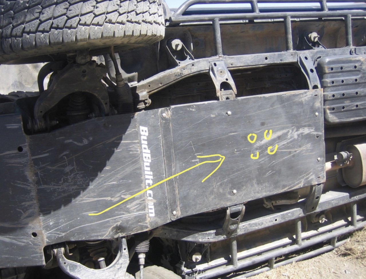

    And I think I did what you are asking about.. I’m hoping we’re just calling things different names, a bit scared now lol.. I put FIPG on the new seal at the tail housing because there was only an actual seal at the crawl box side, and a slathered the coupler with anti seize. Here’s a picture. Please tell me this what ya mean lol
    And I like your support for the crawl box, certainly lighter!! I have the bud built skids and I think I’m just gonna modify the belly skid to accept the mount. Here’s a pic of what I’m thinking..

    I had the same thought about using my Savage skids to attach the mount to. I decided the factory cross member was a better choice. If you use the skids it's 4 more bolts that have to come off to drop the skids. There's a very good chance those bolts get beat up pretty bad and are hard to remove. Any hard hits to the skids transfer that force directly to the crawlbox. The mount I made took less then an hour from cardboard temp to full welded up. I used 1/4" steel scrap that was laying around.
    Yes, that's exactly what I was talking about in regard to the coupling. I used RTV on the seal and the coupling but tons of guys have used anti-seize on the coupling with the same results.
