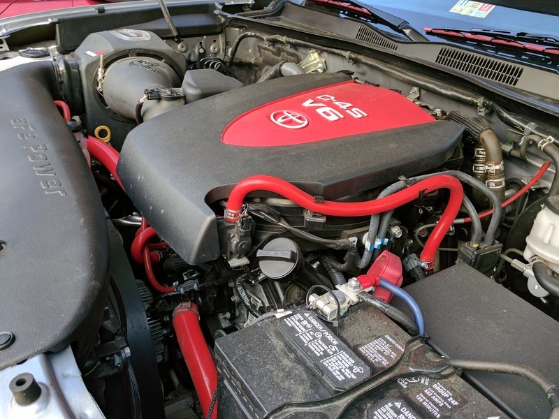

    So I have been busy working on my truck lately but haven't had time to post yet! Recent mods include:
    Red silicone radiator hoses,
    Made new fender splash guards out of 1/4" silicone,
    Painted my valve cover,
    Installed dynamat and hoodliner,
    TRD pro taillight housings,
    Timbren front bumpstops installed,
    Fixed CEL from cat removal,
    Several coats of 3M professional rubberized undercoat.
    Overall, couldn't be happier with where my truck is rn. Have been having a great time with this project and it's starting to really add up now if you ask me!

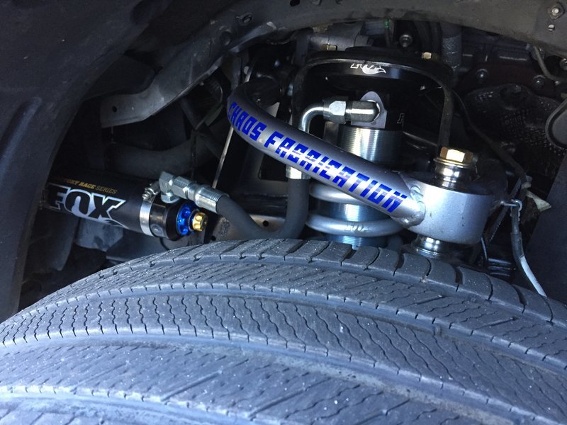

    Sorry for the confusion bro! I had the Tundra Racing Lowering kit, but eventually I ended up selling that to a buddy and going with a Fox lift instead. I like the look of lowered trucks but had never experienced owning one before. Mine made a lot of pretty loud loading/unloading noises over bumps and also could never get rid of several odd vibrations. After putting my lift kit on I'm much happier with the truck overall, big increases in ride quality and performance both on and off road

    Actually if you look closely in this picture, this is after I had the fabrication done on the front end and had the lift installed, but before I did the lift in the rear :rofl:

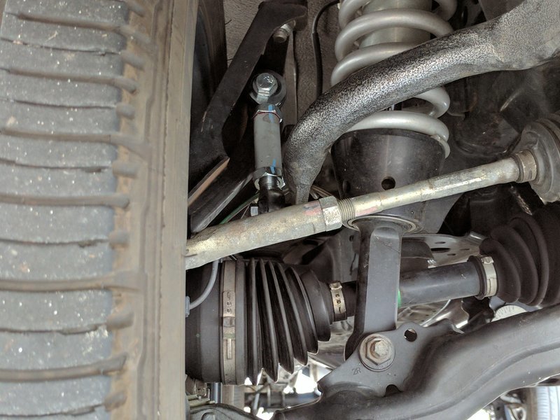

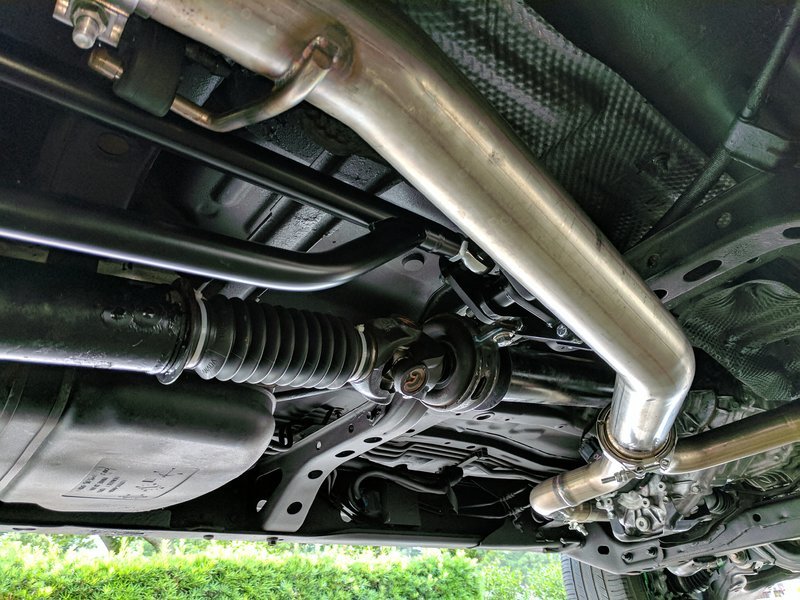

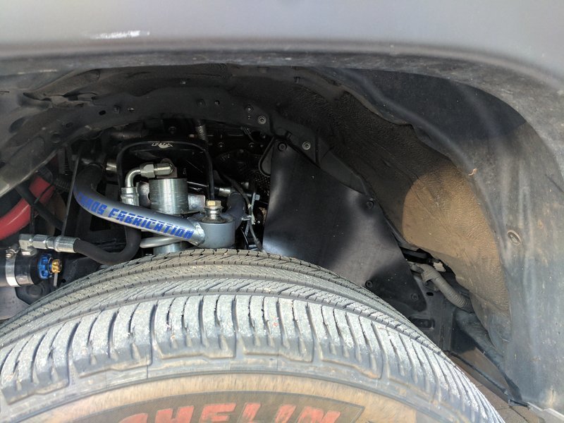

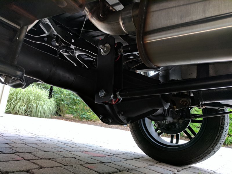

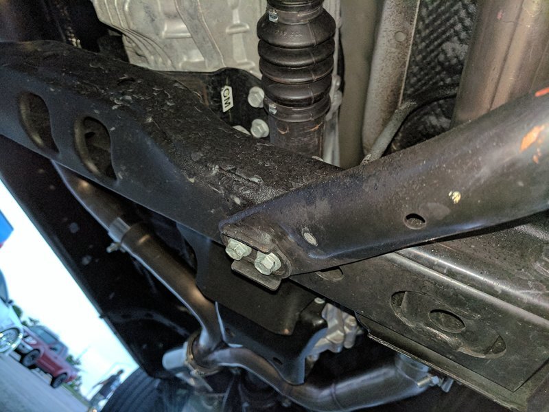

    On to my update for today: June 7th 2017

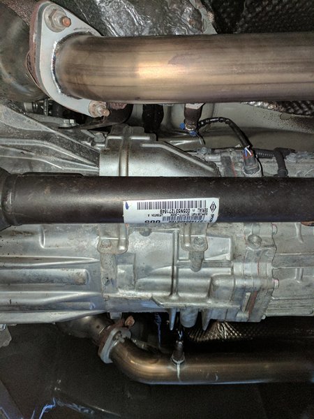

    Been busy getting some shit done on my truck finally. Got the new URD spec U full exhaust installed in the garage the other day. Its really dope, and if you haven't bought an exhaust yet and have been wondering about which one will 'do something', this is the exhaust for you: IMG_20170615_153317.jpgIMG_20170615_153252.jpg
    It manages to delete the rear cats without tripping the check engine light without an O2 sim or spacers or anything. Incredible piece of engineering, this pipe.
    You can also clearly see the Budbuilt weld on traction bar setup as well. Lets just say I'm a happy customer, FINALLY. Amazing product, not so much on the delivery time but win some lose some. In this case I accept the better-late-than-never approach, worth it.
    Also installed All-Pro sway bar end links as well:IMG_20170615_153507.jpg
    They are beefy as S#!T to match the hellwig sway bar up front, and gusseted spindles.
    Also spent a good amount of time retuning the suspension after all the mentioned upgrades. Still working on getting everything perfect, but making big improvements.

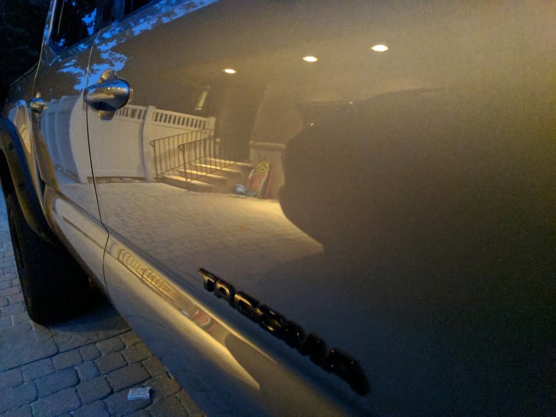

    Finally got around to a good old fashioned wash and wax too :eek:IMG_20170613_205353.jpg
    THAT SHINE!:cool:IMG_20170613_205410.jpg

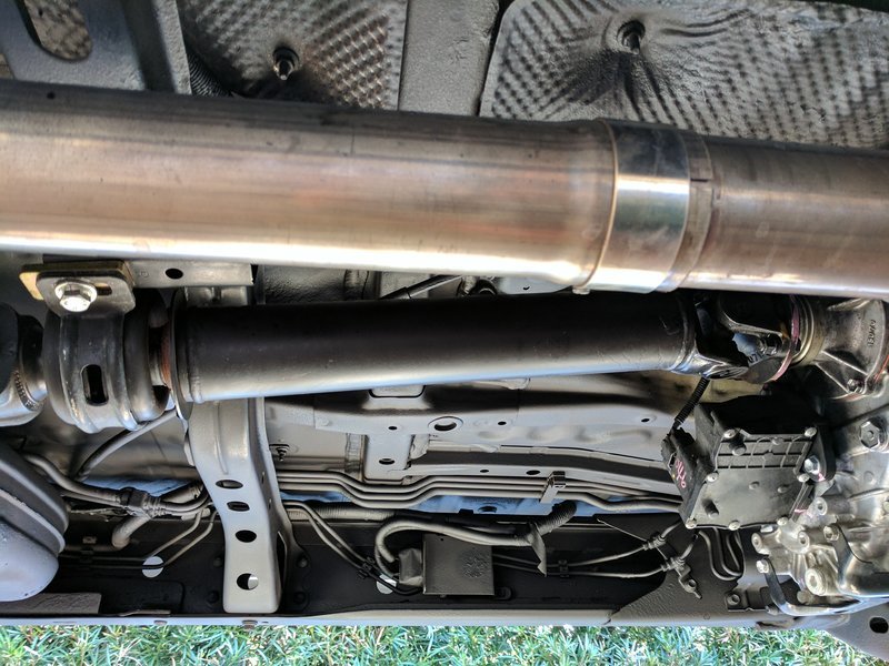

    Any more pics of the URD pipe?
    I would like to see the routing in front of the cross member. The pic on the web site is just a stock photo of an X-runner pipe...lame.
    Magnaflo muffler on yours?

    Magna flow muffler comes with the URD pipe system! And yeah man I got you! IMG_20170617_200611.jpg IMG_20170617_200600.jpg
    Sorry about the terrible focus. Literally saw your post and jumped under the truck! Haha first picture is frame cross member back and then second picture is from where the rear cats once were to that crossmember

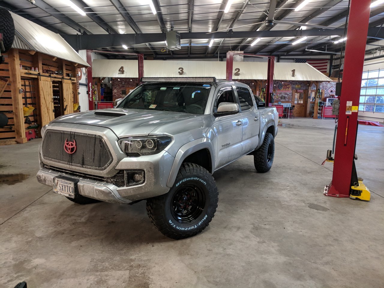

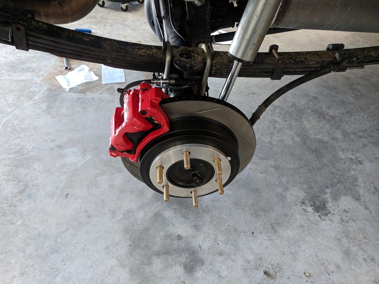

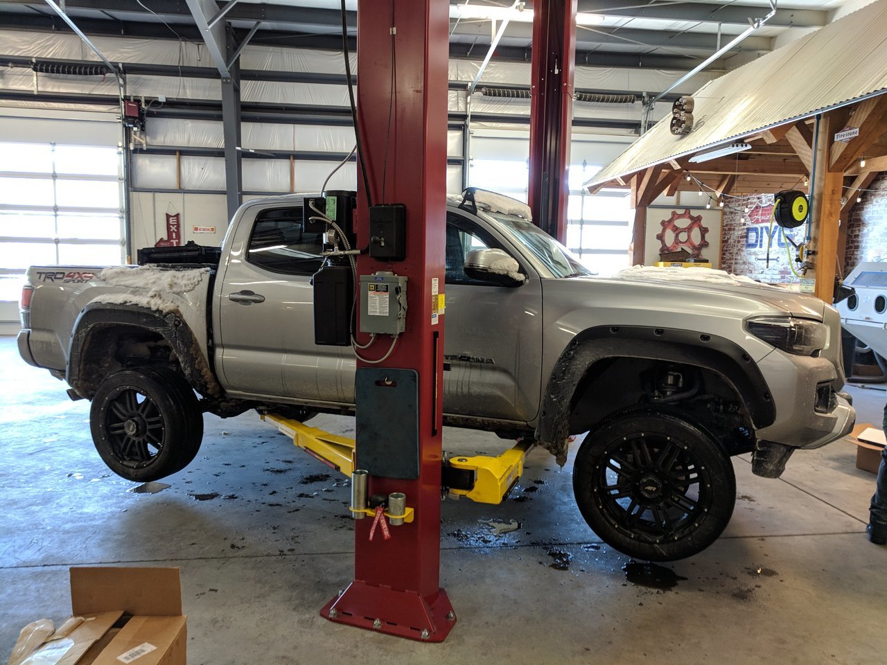

    Finally! Here is the update after going to the DIYG with my good buddy Jack to install the wheels, tires, spacers to clear the front brakes, and the rear disc brake conversion kit! Here are some shots we took at the DIYG of Gert up on the lift :thumbsup:
    How she came in that day:IMG_20180106_091601.jpg
    After we successfully put together one of the rear brakes. It was a super PITA if anyone is considering doing this or a similar mod I can give some valuable insight into putting together drum brakes now that I did it about 10-15 times total. Every time there would be one step out of order which would warrant taking the whole thing apart and restarting! IMG_20180107_125742.jpg
    Finally here are two shots taken as I was leaving after taking off my old fender flares and trimming a tiny bit of plastic and metal out of the wheel wells. It didn't help, still rubbed a lot but oh well I tried haha. CMC coming soonIMG_20180107_170023.jpg

    Nice. Which rear disk conversion did you go with?
