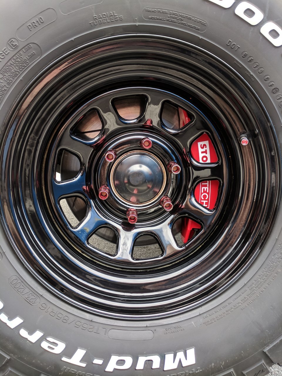

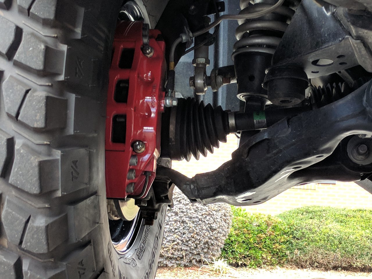

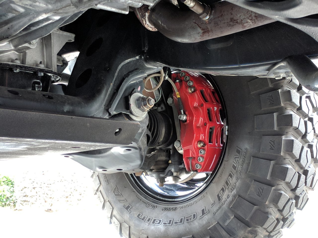

    Another day another project here! Today I finally got around to deep cleaning my front wheels and brakes after install. A little brake fluid was spilled during install/break in and I finally got around to scrubbing that shit off the wheels and giving the calipers a good clean with brake clean and microfibers :rolleyes: got her up on some jackstands, pulled both wheels off, and cleaned everything off nice and then polished with some chemical guys max wheel polish and protectant IMG_20180214_121425.jpg IMG_20180214_121419.jpg IMG_20180214_121346.jpg 15186422776635199143167645767343.jpg

    9,869
    looking so nice.
    so, what's your 10 second review on the rear disc conversion? in terms of reliability, quality, performance..
    stevotivo12[OP] likes this.

    Thanks @St.Germain! Appreciate it brother.
    So as far as reliability is concerned I can't say much yet because I've only had them in for a couple weeks now, but quality I'd give a solid 9/10, the rear disc conversion isn't quite race car level brakes like my front kit, BUT, the powder coat is nice and thick and shiny like the fronts, uses all OEM Toyota components for the caliper, and install was pretty straightforward. Time consuming, but I didn't have to do a whole lot of making things up as I go and things fit the way they were intended to, so that's a big plus. Solid overall kit, components from SOS performance such as the brackets and backing plate all fit perfectly so no dings on the quality far as I am concerned.
    Performance is subjectively speaking greatly improved. I feel much more in control of the vehicle pushing the brakes to the limit, and stopping power is without a doubt increased according to the ole butt dyno. Initial bite is harder, while modulation is much more linear and gives more accurate feedback through the pedal. Objectively speaking, I probably still have a lot to gain from a proportioning valve and master cylinder upgrade. Looking into utilizing the Sequoia brake MC for increased fluid movement to pedal travel as well as adding a simple in line proportioning valve in place of the brass 'spacer' in between the hard line coming off the MC and the actual chassis hard line in the future. I'm really happy with the performance so far, but when I really lay into it I can feel the rears brake loose, and I'm sure I could work my fronts harder without hurting anything as I am not getting much weight transfer during braking... Lots to think about but it's been a blast driving around recently, can't freaking wait for 1.03c as well especially with @OVTune taunting us on the Dev. thread

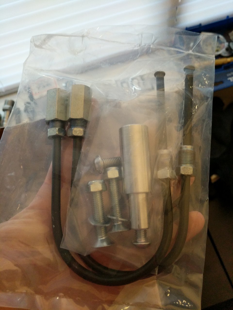

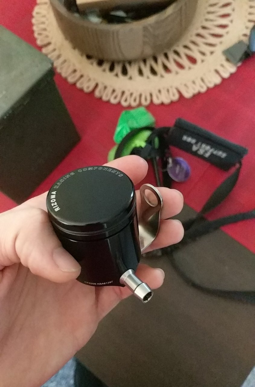

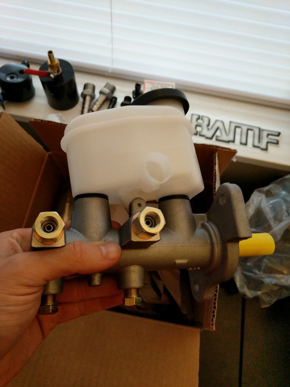

    Just received the parts to do my M/C upgrade from SOS Performance. Also purchased a Rizoma reservoir for the clutch fluid since the Sequoia MC does not have an additional hose barb for the clutch fluid. Install write up to come next week. Will also attempt to get a stopping distance test before and after. Here are some shots of the new goods: 15198552519935797826053253410891.jpgAnd here are the Hardline extensions and MC piston extension: 15198553928003473585656577373531.jpg new mounting plate with o-ring seal: 15198555057787181372026850917540.jpg
    And of course my little clutch fluid reservoir: IMG_20180228_170828_01.jpg write up will be up by next week hopefully!

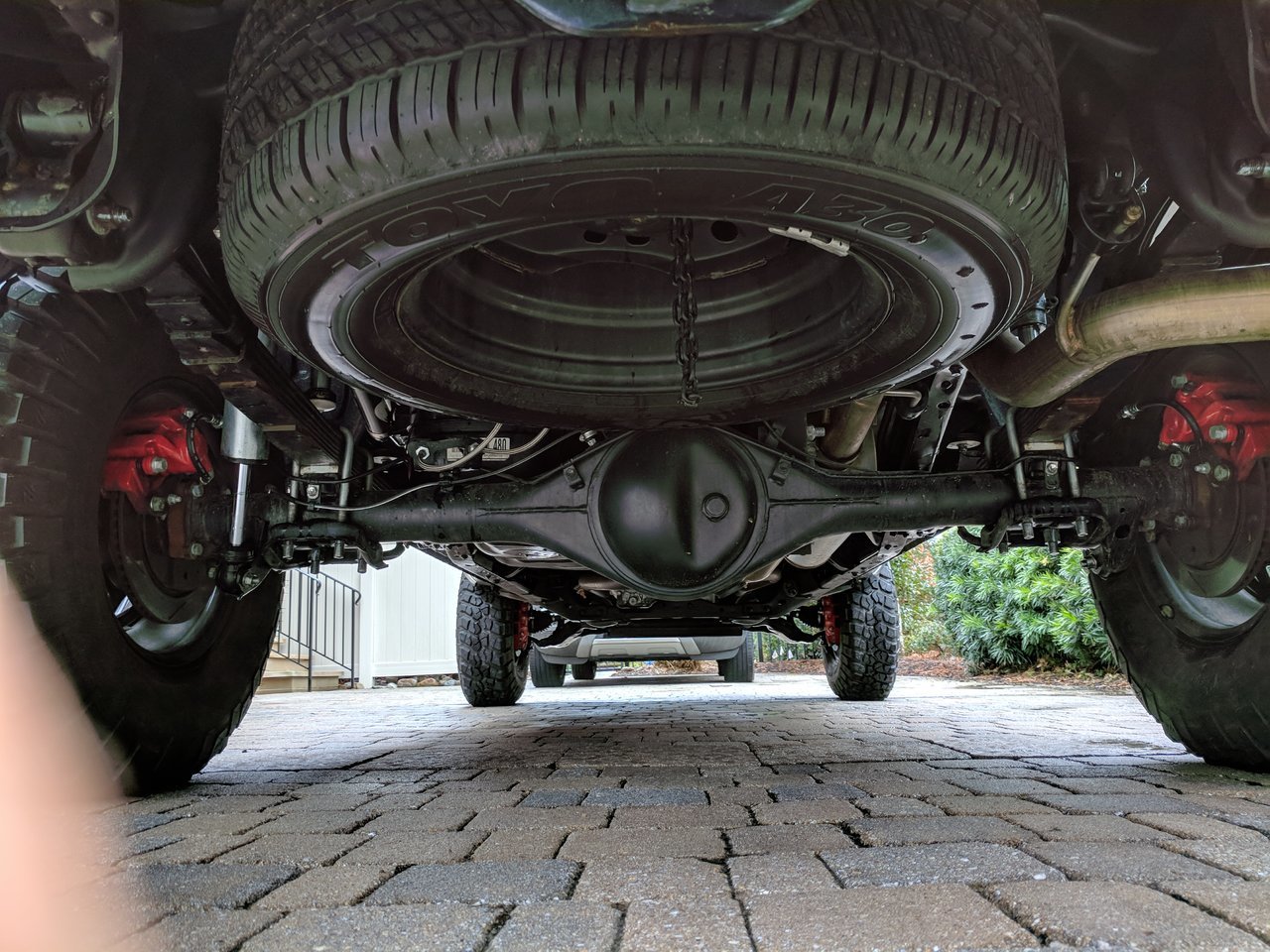

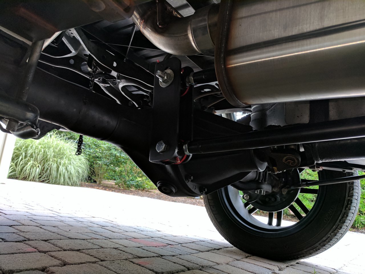

    We tried to get the trac bar install going today, and there was fitment issues... the weld-on bracket blocked the pumpkin and we were thinking about fab work to correct it... but then i had an idea to refer back to your photos... this one in particular.
    so....
    you rotated the muffler 90deg to provide clearance i see. that's a perfect solution, thanks for posting it. i just wished i looked closer before. so back to square one for now, next week repositioning the muffler and the week after try for bar install again. :kona:

    I am glad you like my solution! It was the only thing I could think of to get a tiny bit more clearance for the trac bar, but I think it should work for you seeing as my muffler is about as big as they come, its massive! Lol

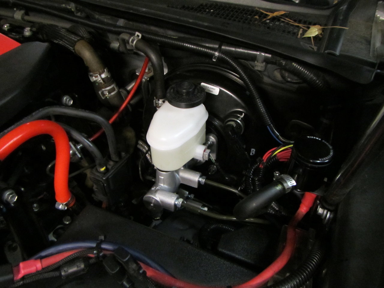

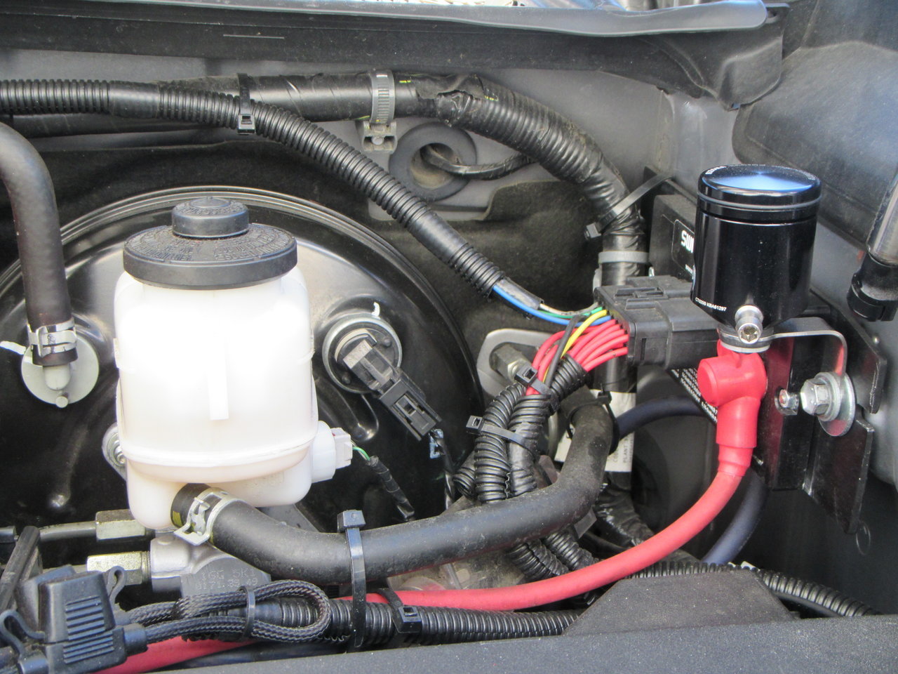

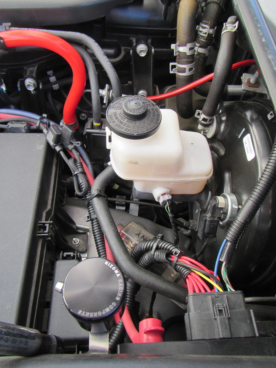

    So today I got a chance to do the Sequoia MC swap kit provided by SOS performance. This was yet another significant upgrade to the braking system, and definitely gives a much firmer pedal as promised. It is much to early to tell about the performance as I was gentle with her on the way home for the most part just to test everything out but tomorrow I plan to go out and romp on it now that I have seen everything work properly. Here are some pictures of the install! stock MC with new clutch reservoir (Rizoma aluminum resi from an Aprilia sport bike) mounted:IMG_0010.jpg
    And this is the new Sequoia MC with the new clutch resi fully installed

    what muffler do you have? i have the TRD that came with the Pro. this one looks close but doable.

    Magnaflow that came with the URD spec U! It's really tall, and long so I would think just about any muffler could fit if it can, except maybe the largest round mufflers
