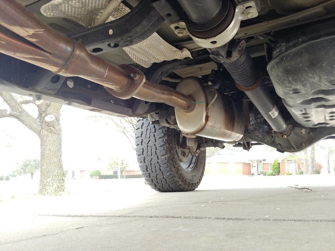

    i think the next consideration is to remove the rear cats. do you have any suggestions about it?
    i'm heading to have my exhaust worked over to reposition the muffler next week. i may want to remove the cats at some point after that. Pablo at Tandem, one of the Tacoma builders out here with a good shop in Ft. Worth is considering doing some exhaust package, so i may work with him to remove the cats and replace with clean pipe. sorry if i missed a mention of that... i'm slammed at work and doing the internet half-assed right now. :rolleyes:

    Yeah! When youre trying to pull out the factory y section of pipe, be sure to use PLENTY of PB blaster, mine were rusted together and ended up costing me a trip to an exhaust shop because I had one break trying to tq it off. Oh that and on the driver's side you can slide the cat straight through the frame section it rests in, but I am pretty sure the only way it fits through is with the aluminum exhaust hoop in there removed. There is a bolt on either side of it! Im pretty sure those are the only tricky parts IIRC

    got the trac bar installed yesterday.
    Bud is a nice guy it seems. he's also full of shit regarding fitment. but no problem... just that others should know. his trac bar is a second gen item and the people need to know. just say it's modifiable for 3g, then everyone can be happy!
    after turning the muffler and gaining clearance issues from that (just a step in the plan, not a major issue), Pablo at Tandem had to modify the bracket and fit the front a bit off from its intended/designed location. again, not a huge issue but not as nature exactly intended.
    Tandem is developing their own exhaust kit with rear cat removal, and I'm looking to be the test mule for that, so we'll take care of all the exhaust stuff by the Fall hopefully.
    for now the trac bar sits well, has a tick of preload, and seems to be working right. the truck feels different right away, the steering is a bit more responsive (a little crazy and i need to get used to it), and i can definitely get on the throttle earlier than before. kinda cool.
    thanks again for your write up... been taking inspiration where i can get it.

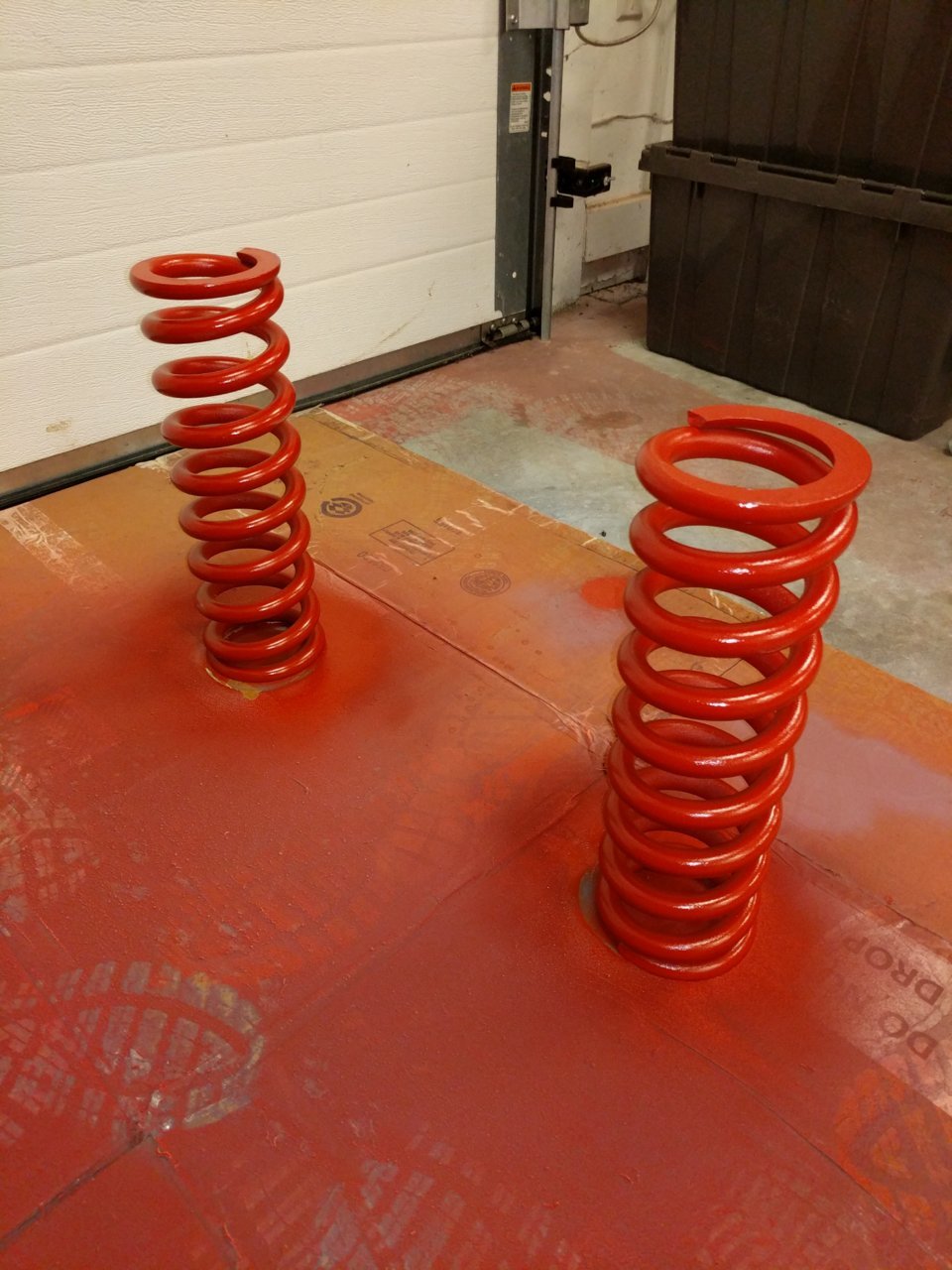

    At last! A real update to my thread! So this week, I have been working hard on a new project for Gurt... Her coils have started to sag lately seeing as I have the fox 620 lb/in coils and my truck is heavier than stock... So I am working on painting my eibach 700 lb coils and getting them ready to install. I will update with pictures of the products I used and the final results in a few days when the clear coat finally finishes curing and I can polish it up. They look pretty decent now though even with the clear coat still foggy in some places and definitely still wet

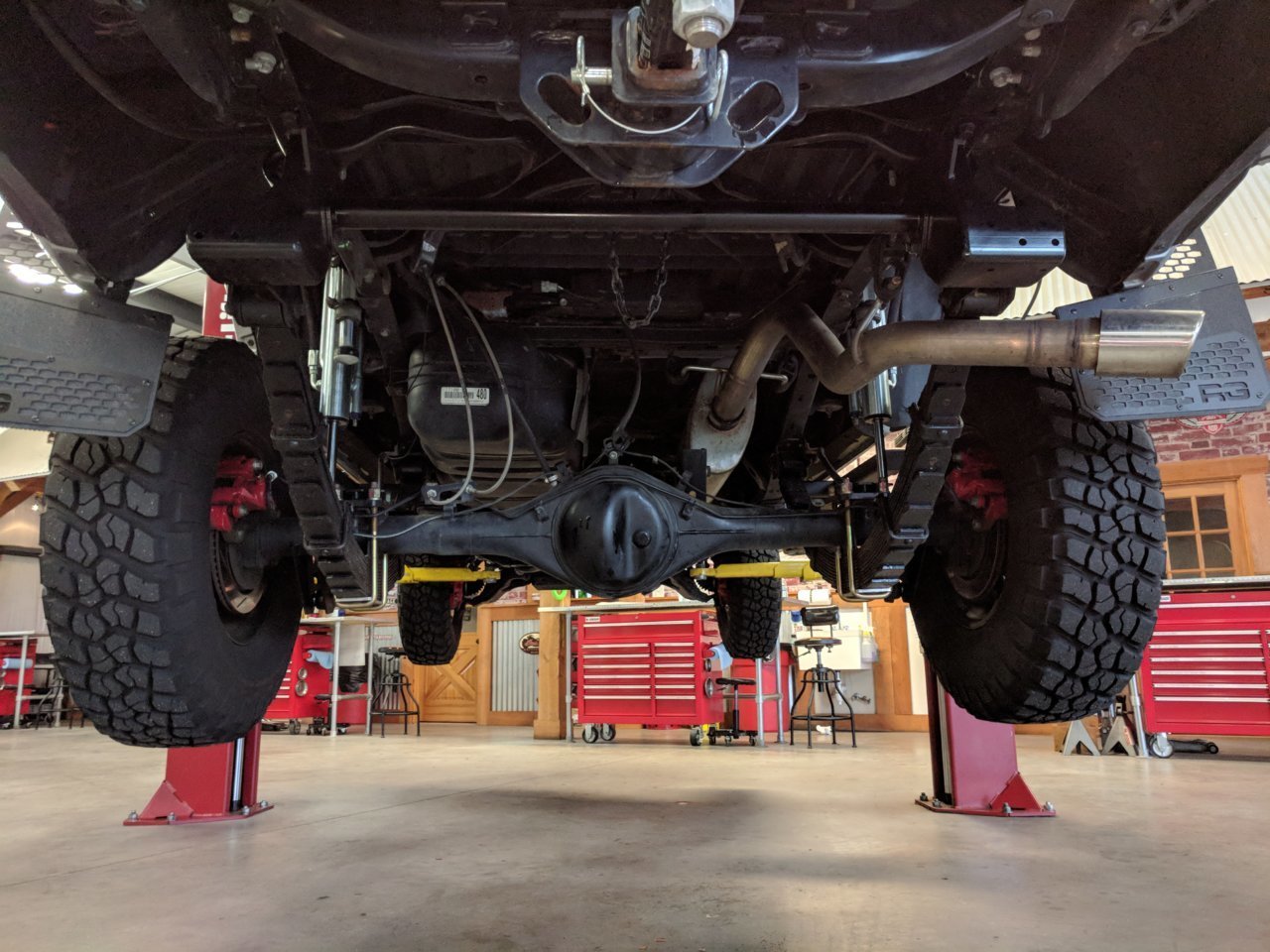

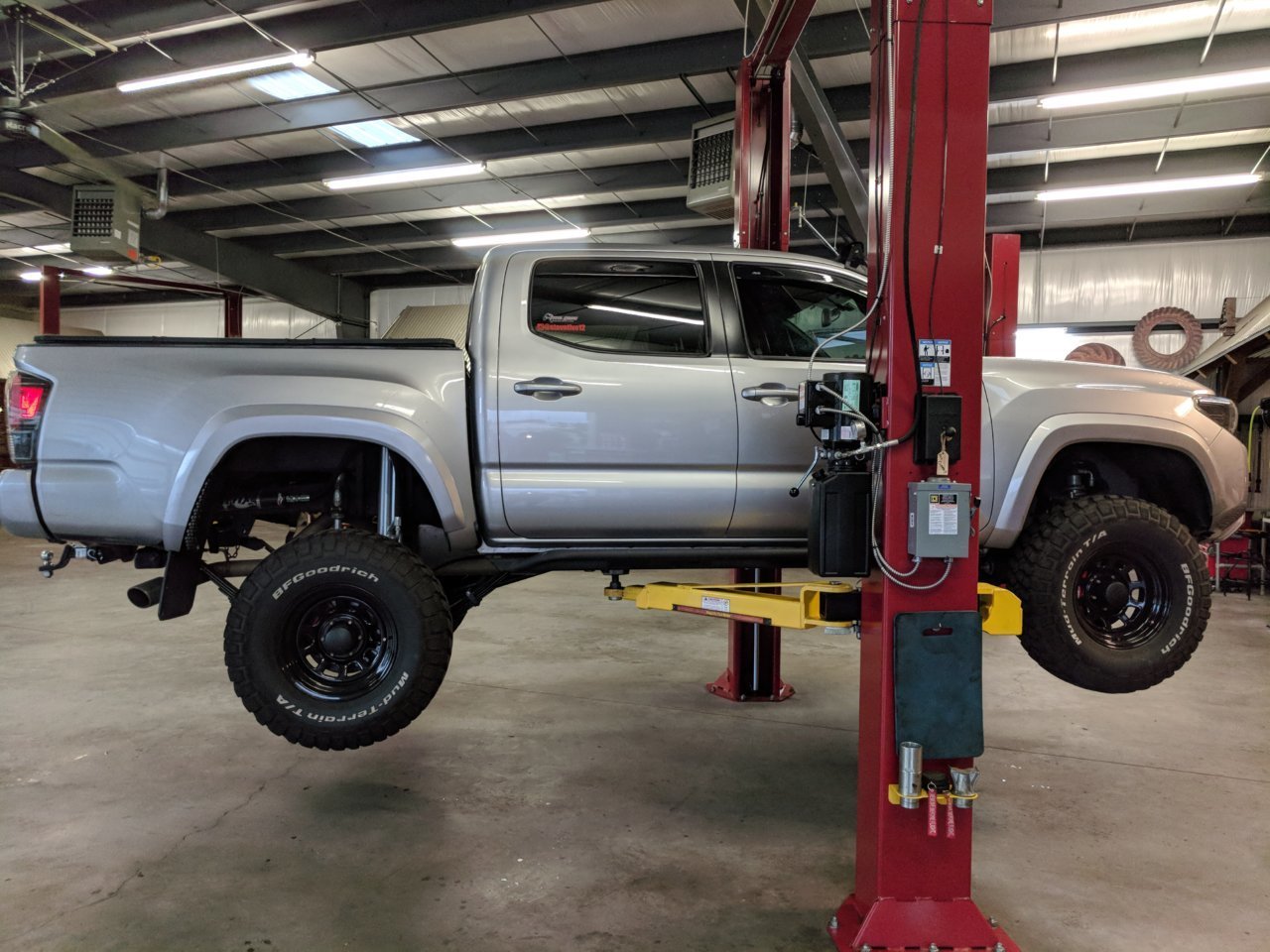

    So about a month ago my truck went in and got by far its most significant suspension upgrade to date.. Because I can't weld, my good friends at the local off-road truck accessory shop got the bid for this one and Im glad I took it to them because they pulled this off perfectly, really did a great job. All told, they:
    -removed old, sagging leaf springs and Icon AAL
    -grind off axle perches, and both shock mounts
    -reset pinion angle based upon manufacturer of the parts' recommendations
    -weld in new axle perches for the leaf springs to go under the axle
    -weld in new upper and lower shock mounts, uppers extended approx 10" or so above frame to the top of the wheelwell while lowers are moved slightly below the axle to accept a 14" bypass shock
    -installed new deaver leaf springs and fox bypass shocks
    -painted everything with black chassis paint to match
