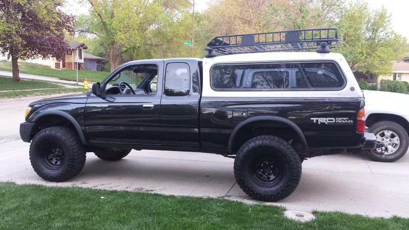

    Hey everyone, just bought a 2000 TRD Tacoma with 5100 blistein shocks and 33 inch 12.5 Goodyear wrangler with I believe 15 inch rims. I just took it camping this weekend and obviously it's a truck so highway driving in it is whatever ( I've had a 99 outback for years so I'm comparing ride comfort to that) and I was noticing the stick shift shakes a lot in high 4th gear and 5th. I don't know if it's bad for it but I wanna fix it if it's bad. Tha ks

    Ok...and this seller had wheel bearings done when we threw on the lift and tires and suspension. So in your eyes would you start with a simple balance and re mount of tires? What about road force balancing?20170427_195909.jpg
