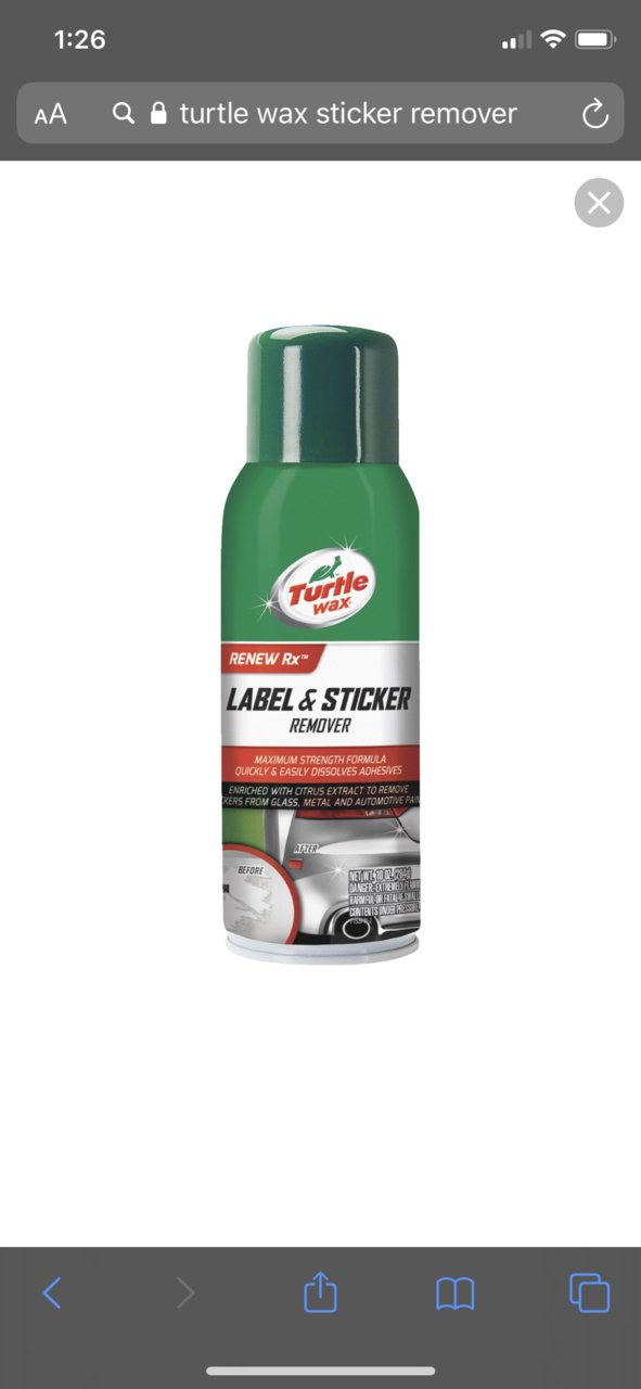

    Only need 3 things bro- only thing you need to buy is this turtle wax spray!
    1. turtle wax adhesive remover
    2. Blow dryer
    3. Dental floss- the tuff kind that will get beef out between your teeth ! Haha
    I used this on my 2020 Tacoma to deflower (debadge) and using tonight on my wife’s new 2020 Rav . Plenty of YouTube vids to show you process . Once emblem removed - spray turtle wax- let it sit for 30-60 seconds and wipe off with clean rag . Might need few passes. Last, I always hit up with wax - than wash truck/ car. Nice clean end result.
