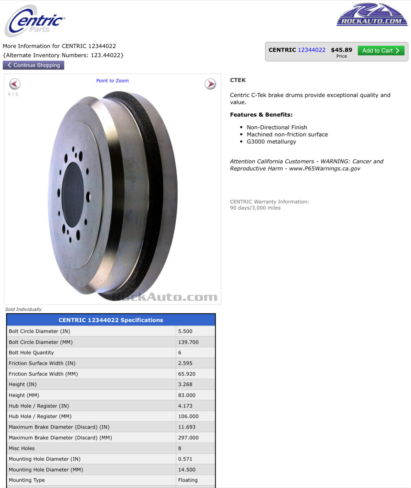

    Umbrella Corporation, flood backup lights
    The Ctek Centric brake drums at Rockauto is now $45.89
