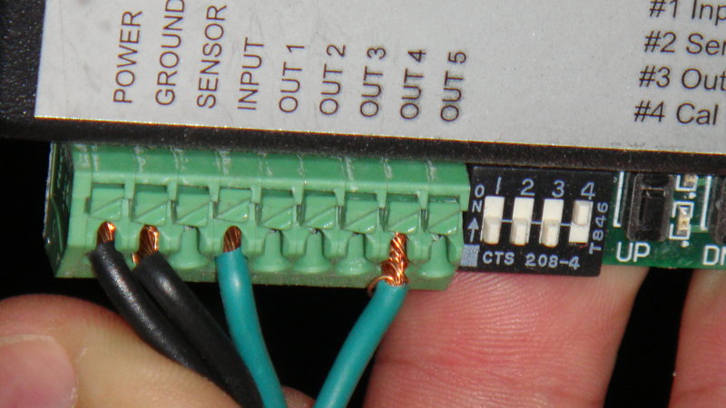

    I went with Dakota Digital for my speedo.
    Here is what I did for the speedo adjustment. I cleaned up the wiring since these pics were taken. I had to move them around while out driving to get the correct pins chosen.

    Man I was thinking like back in the 60s' of just swapping a plastic gear! Thx!

    Yeah... right! Not like it was after installing 4.56's into your 69 Z/28. Too easy.
    For my '03, this was the only way to get it dialed in.
    Good luck
