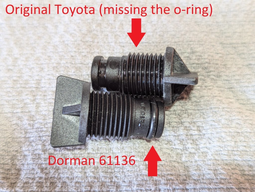

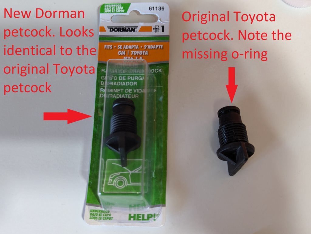

    I can confirm the Dorman 61136 fits my 2006 V6 Tacoma radiator (original radiator). I just bought it today and used it since my original petcock o-ring broke. It was easier to just buy a new petcock then try and find the correct o-ring. Just remember to put a little grease on the o-ring before you put the petcock in.
