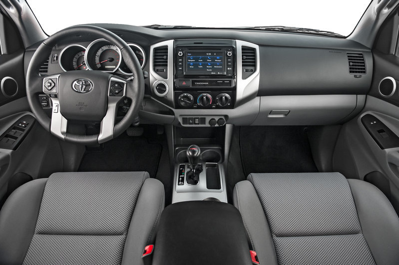

    Please Help. I have an Automatic 2015 TACO and I spilled a significant amount of soda into the PRND4321 gear stick area. Now transitioning from certain gears is sticky. How can I clean out that area is it possible? I attached a photo of my interior... Thanks in Advance!

    unscrew shifter, grab a hold of the shift bezel and it will pop up with enough force. You can remove the front 2 cup holders to make it easier, but you don't have to. Now you have access under the shifter
