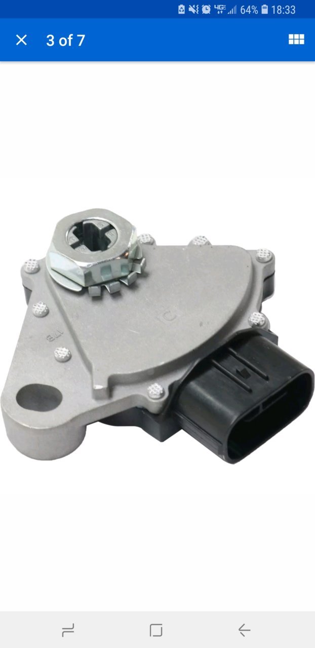

    My sticky shifter has been slowly getting worse, and this past week I actually had the truck refuse to start. It did start after I pushed on the shift lever. So it appeared the problem was the truck thought it wasn't in park. I was in for an oil change yesterday and it happened for the mechanic. He diagnosed the faulty park neutral safety switch to be the problem. Installed the new switch assembly part # 84540-04010 ($258) and tada the problem is gone. Shifting is smooth as silk now. :)
    I should also note that my truck did occasionally throw the PO705 code which I believe does point towards the park neutral switch being the problem.

    How did you get the new one on there? Mine new one will not fit over the spindle. Do I take the middle part out where the nut is attached?

    Do you know if this is the same part and will fit? https://www.amazon.com/dp/B07BSCPGHR/ref=cm_sw_r_em_apa_i_uYZ1BbYSZJN4K
