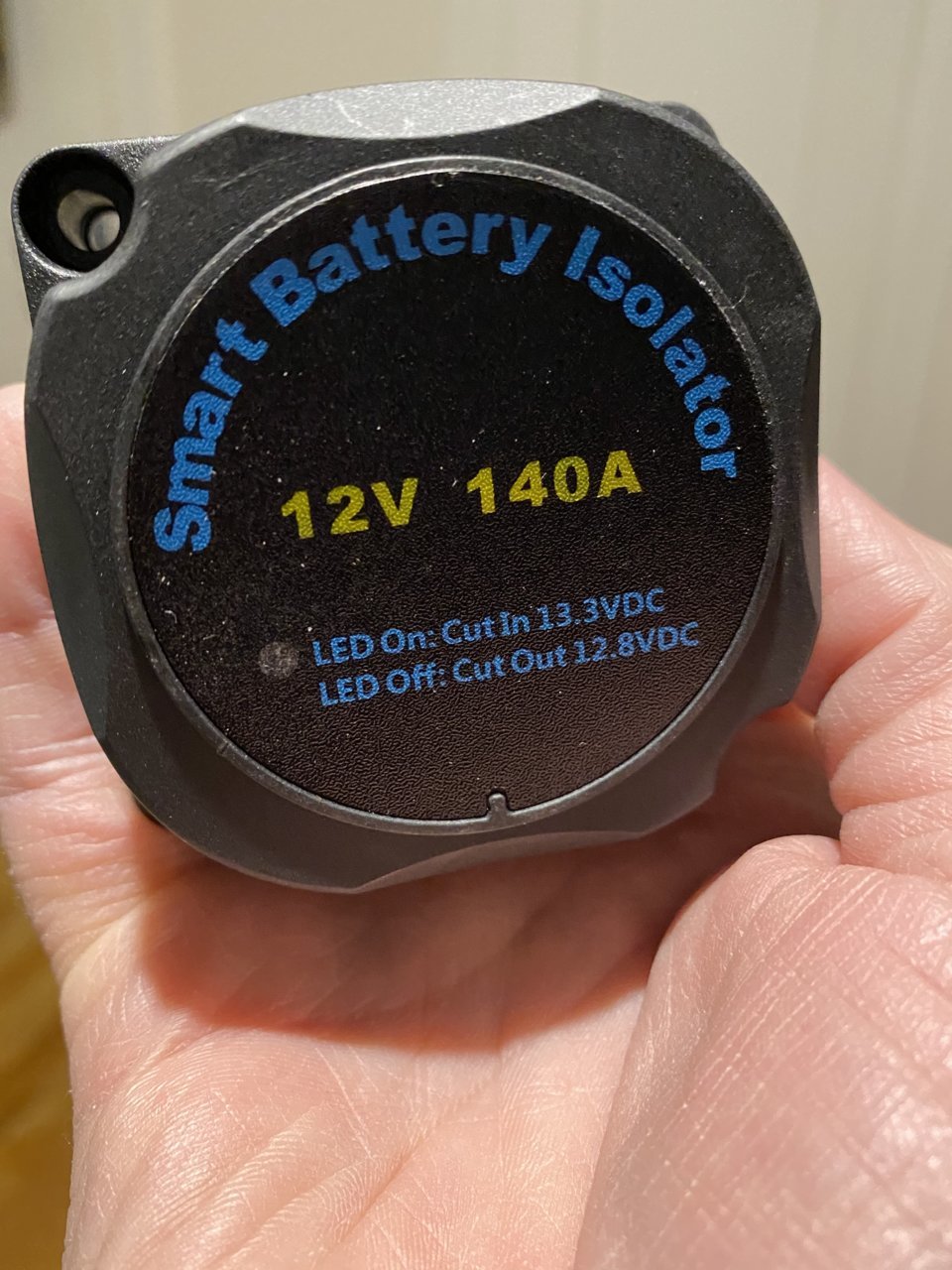

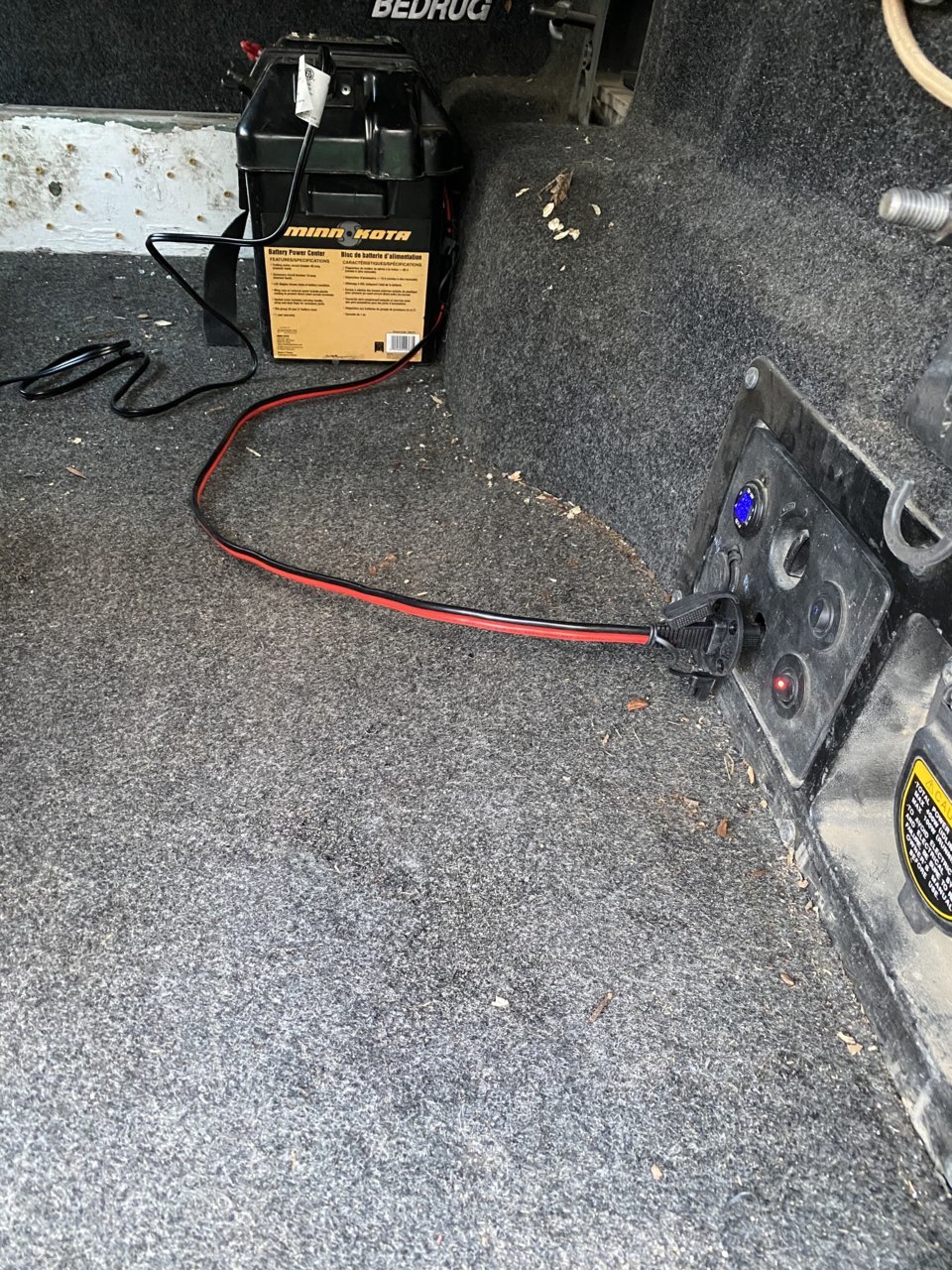

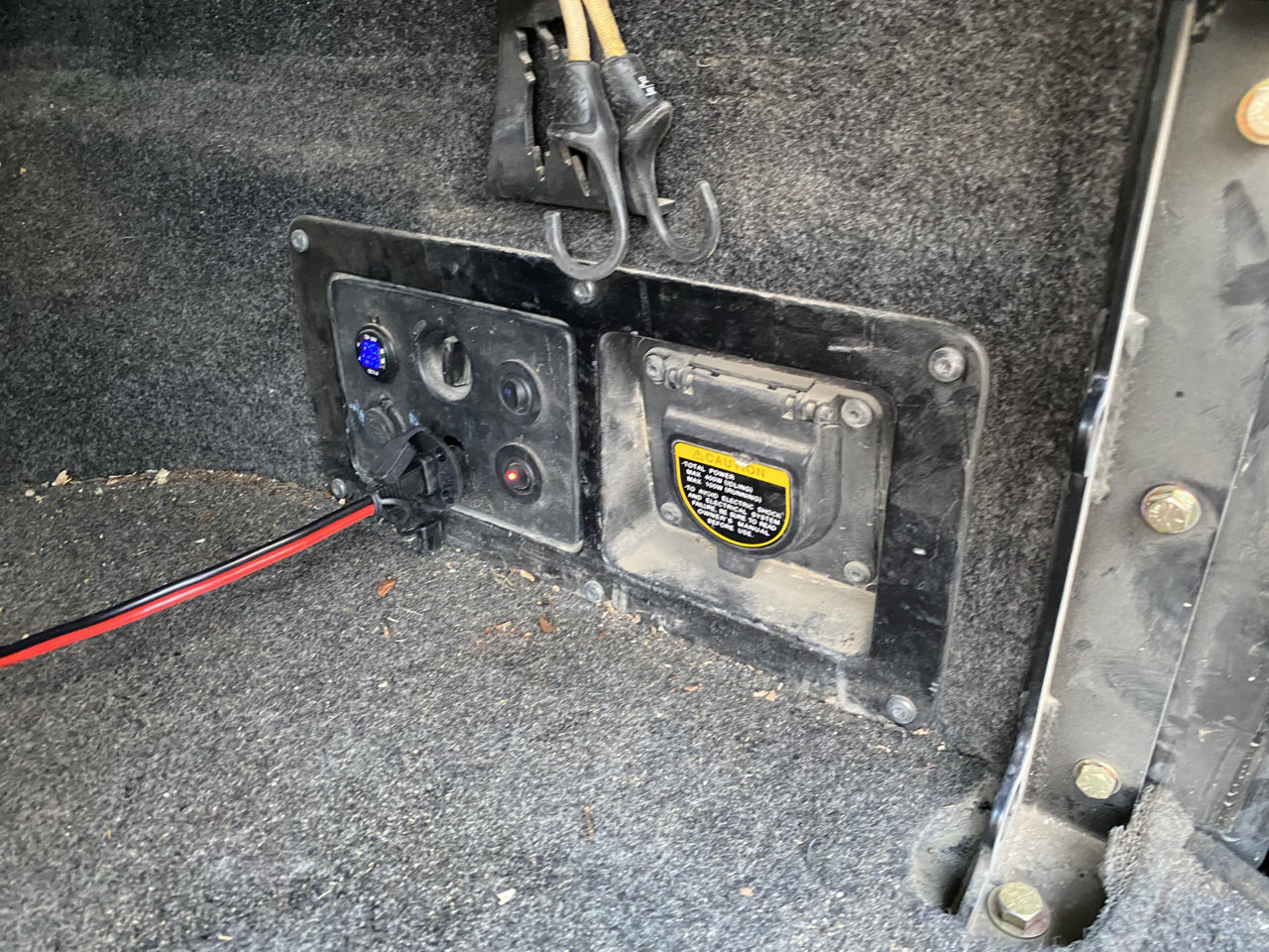

    Dual batteries are running now. Hooked up a 107Ah deep cycle using the battery isolator.
    I test fit everything today. Tomorrow I need to tidy up the wiring behind the cubby lid and screw down the plug for the house battery. Then I need to work on a mount to secure the battery. I already ran wiring to the bed and installed a fuse panel in the cubby from a previous mod so this was pretty quick.
    The isolator charges the house battery when it gets more than 13.3v and cuts off when the power from the starting battery/alternator drops below 12.8v.
