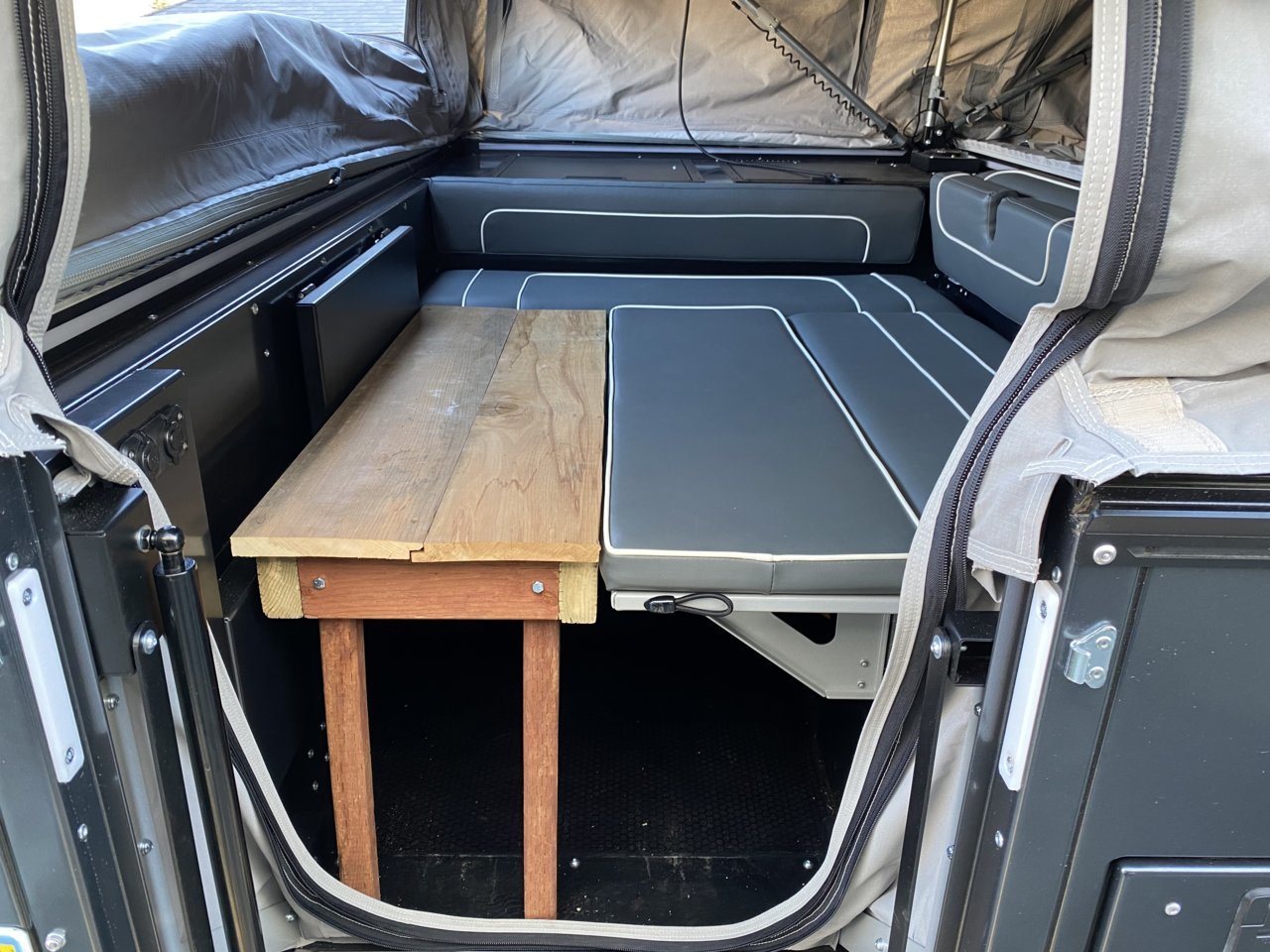

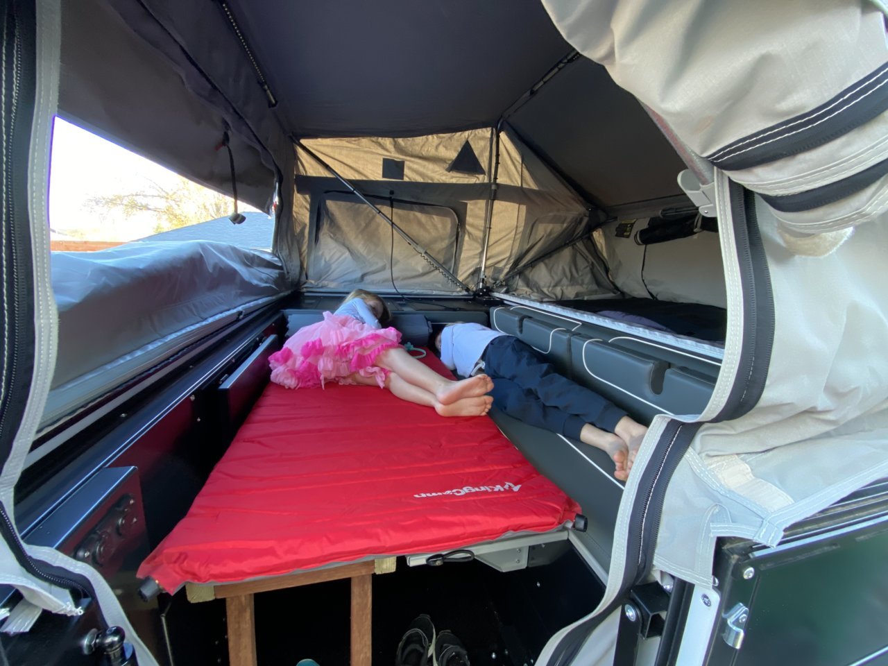

    We could have ordered it with a second bunk but the plan is as soon as the kids are a bit older we will be kicking them out into their own tent and with the second bunk you lose the fold out table which I wanted for a workspace when we take longer trips. Today I threw together a platform with scrap wood from our fence project to get the youngest out of our bed. The legs are attached with wing nuts so it doesn't take up much room when not in use.

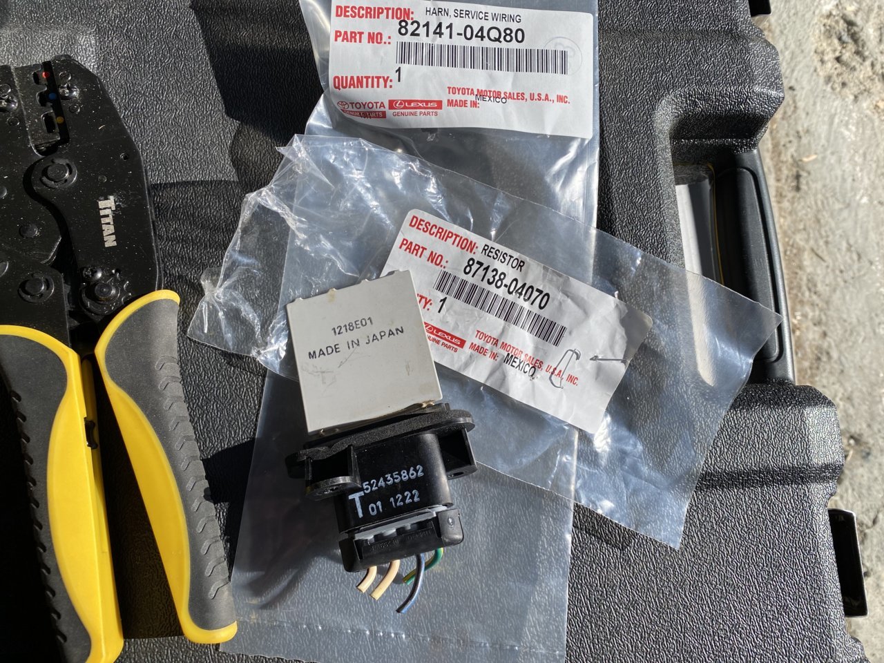

    Fan switch on the HVAC was only giving me Off or Hi at the end of our trip home with the trailer. Replaced the blower motor resistor and harness...truck is a bit less Japanese and a bit more taco now but everything is working as it should again.
