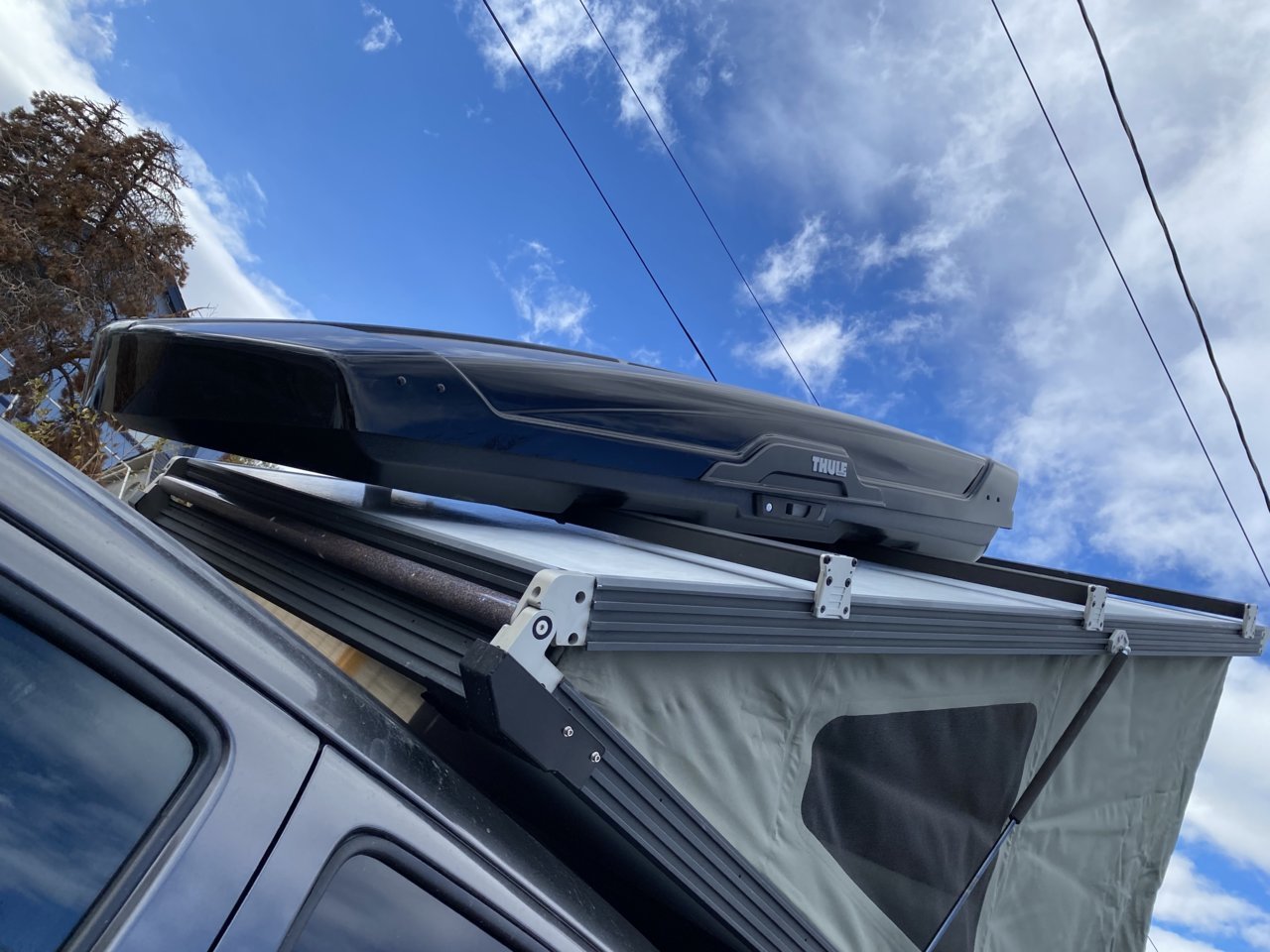

    Getting winter mode sorted. I'm going to look into a small diesel heater if I actually get out and spend more time in the backcountry this winter.
    Last week I mounted the cargo box and the was happy to see that tent can still open with the existing struts.

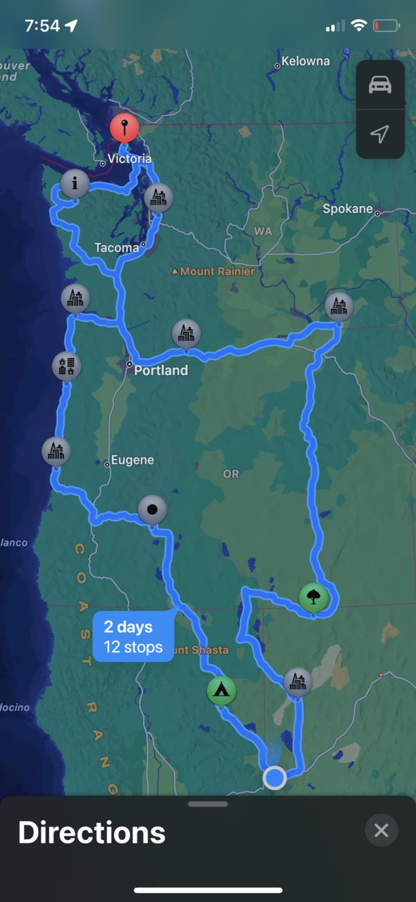

    Dialing in the 2023 road-trip plan

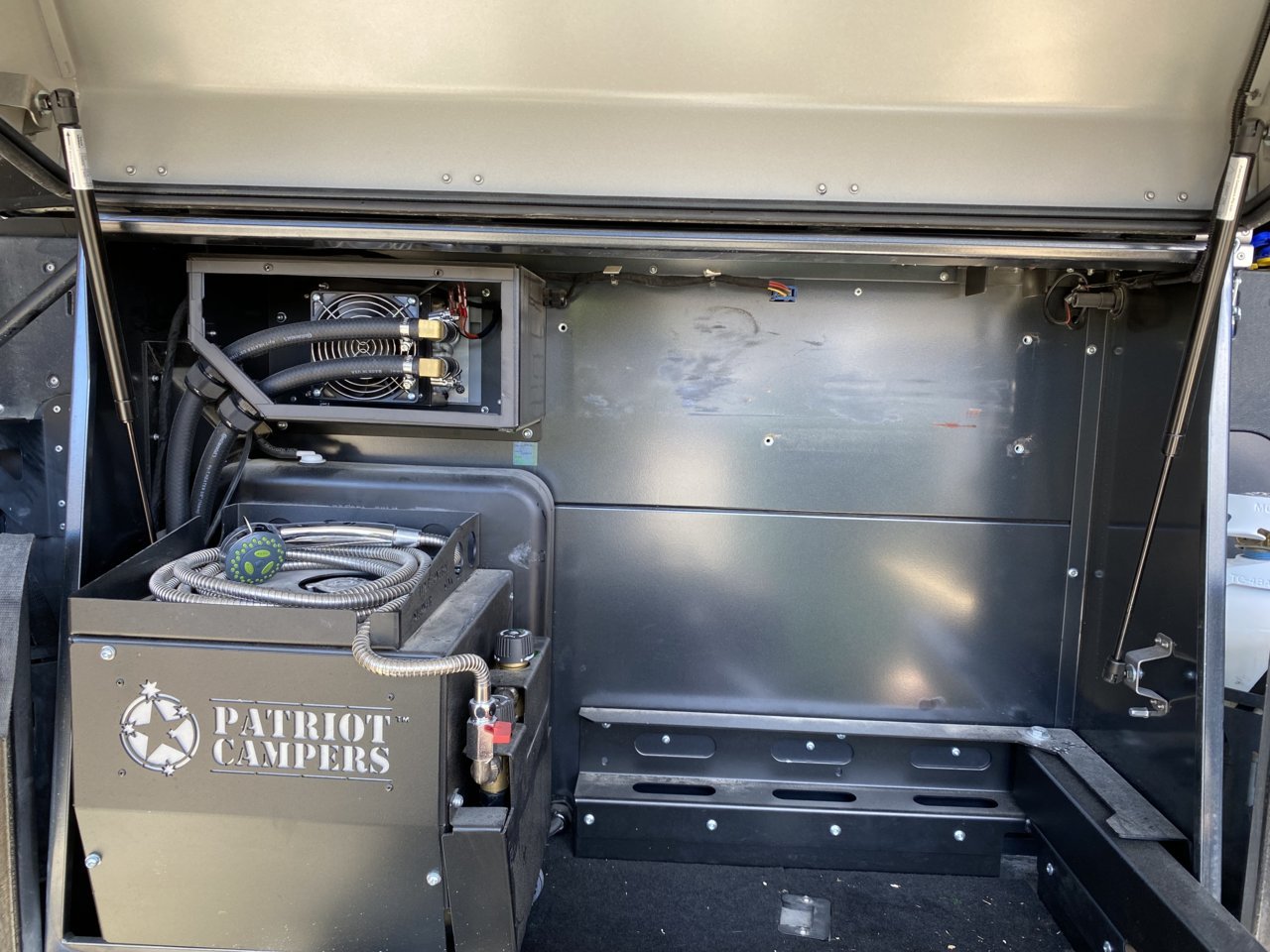

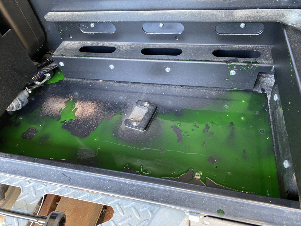

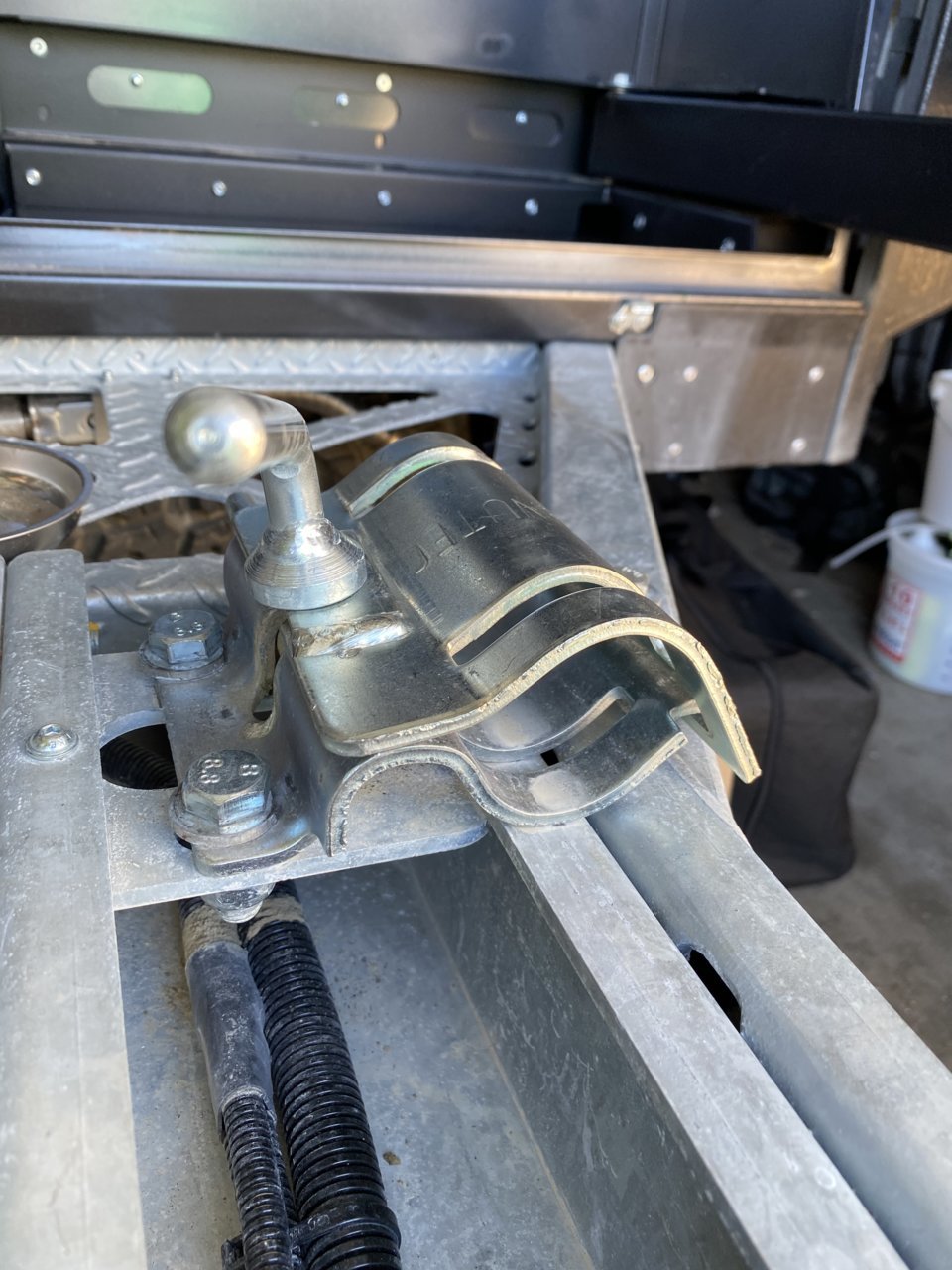

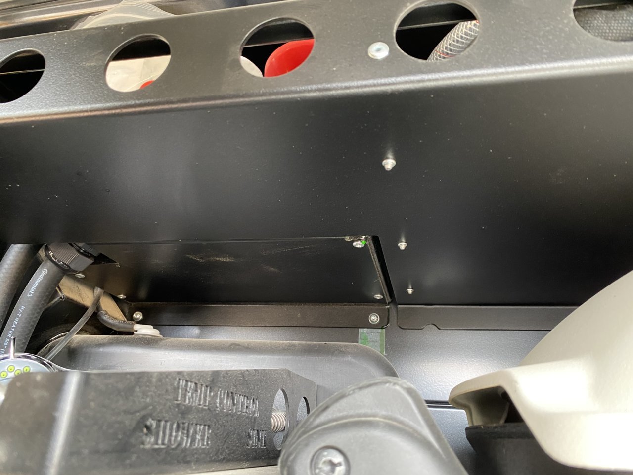

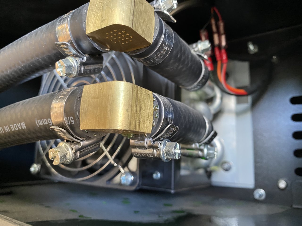

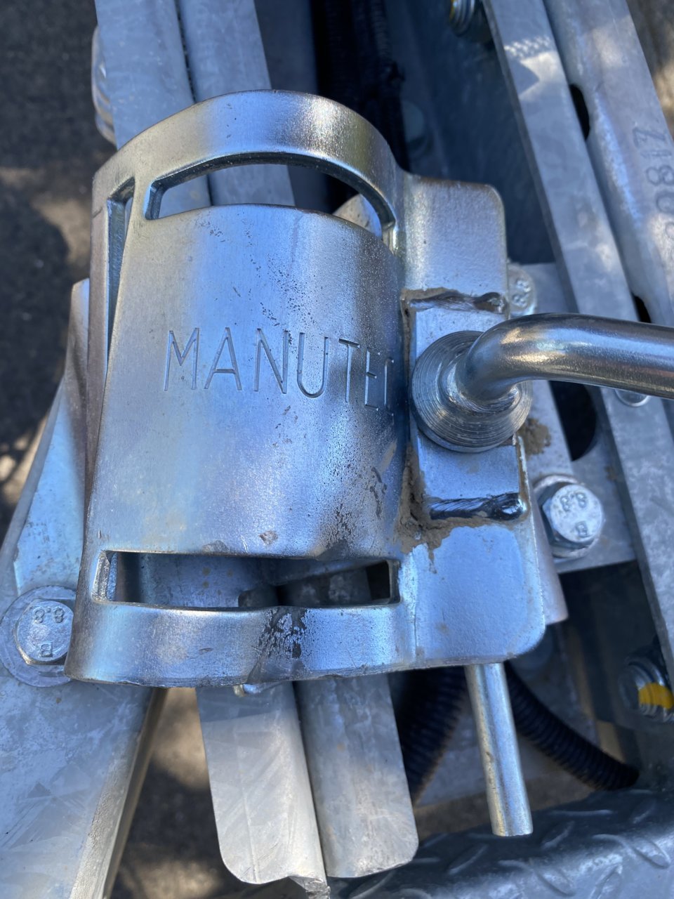

    Tracked down a glycol leak in the webasto today and replaced the crushed jockey wheel mount (I crushed it jackknifing the trailer to turn around on a shelf road in Death Valley that was washed out).
    Took me longer to empty the shelf and clean the glycol out of the mats than it did to fix the leak...definitely glad it wasn't worse.
    The 2 clamps in the front were snug but the other 4 clamps took at least 2 full turns to tighten with the leaker taking over 3 turns.
    I originally swapped the jockey wheel travel mount with the mount on the drawbar so I could unhitch the trailer after I crushed it and just put the jockey wheel in the bed of the truck when hitched. Ended up buying a couple used off someone that swapped their jockey wheel for an ARK setup. Got 2 mounts for the price of 1 so now I have a spare incase we find ourselves in a similar predicament where we have to jackknife it to turn around.

    The leak at the webasto is a common issue. If it leaks again I'll replace the hose clamps. I have a pending warranty request but it is all related to parts Patriot sources...the plastic clips that hold down the coffee bar suck and one has broken, the plastic piece in one of the awning poles broke so it will not lock in an extended position, and the zipper they use on the awning bag it trash so they are sending me a new/redesigned bag. The only thing I feel is on them is the design of the awning support is not strong enough and has begun dropping after off-road use. They've designed supports for that and I'll be adding them to the trailer.
    Overall I'm still happy with it and feel it's the best off-road trailer on the market.

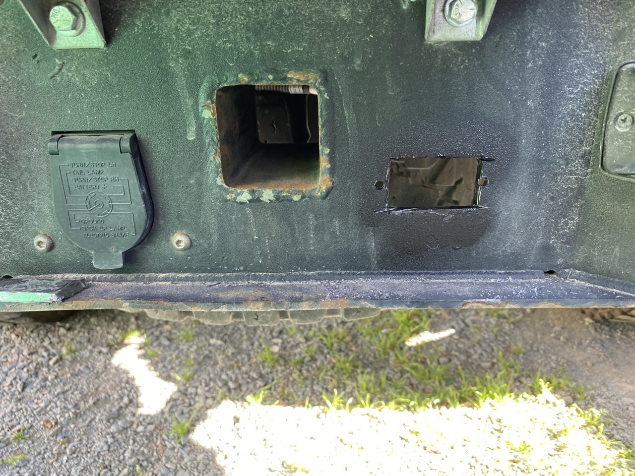

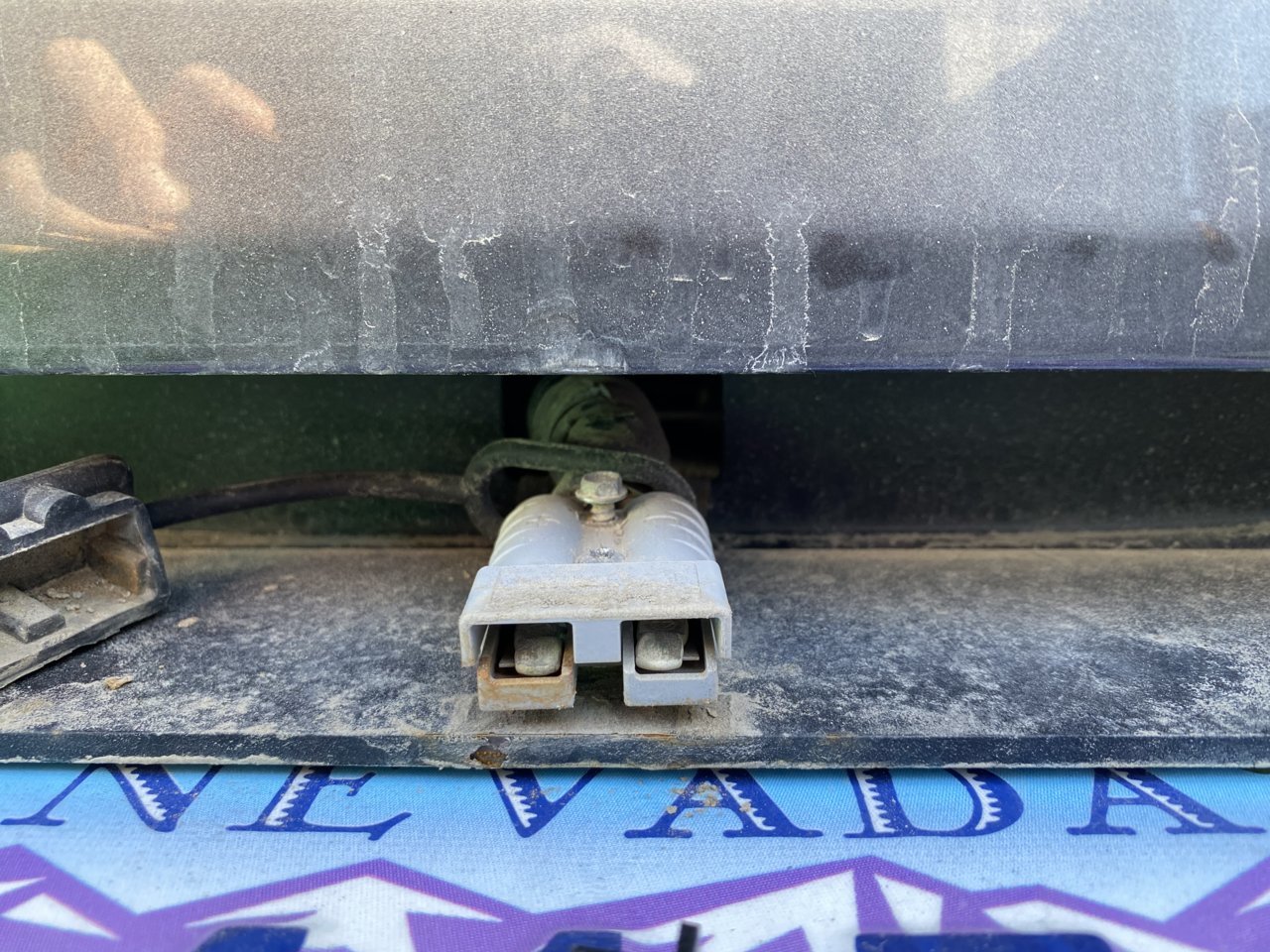

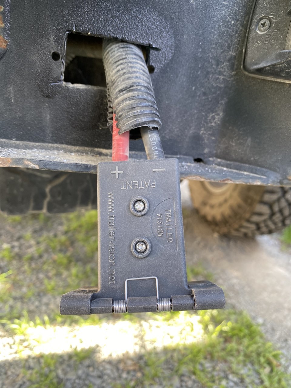

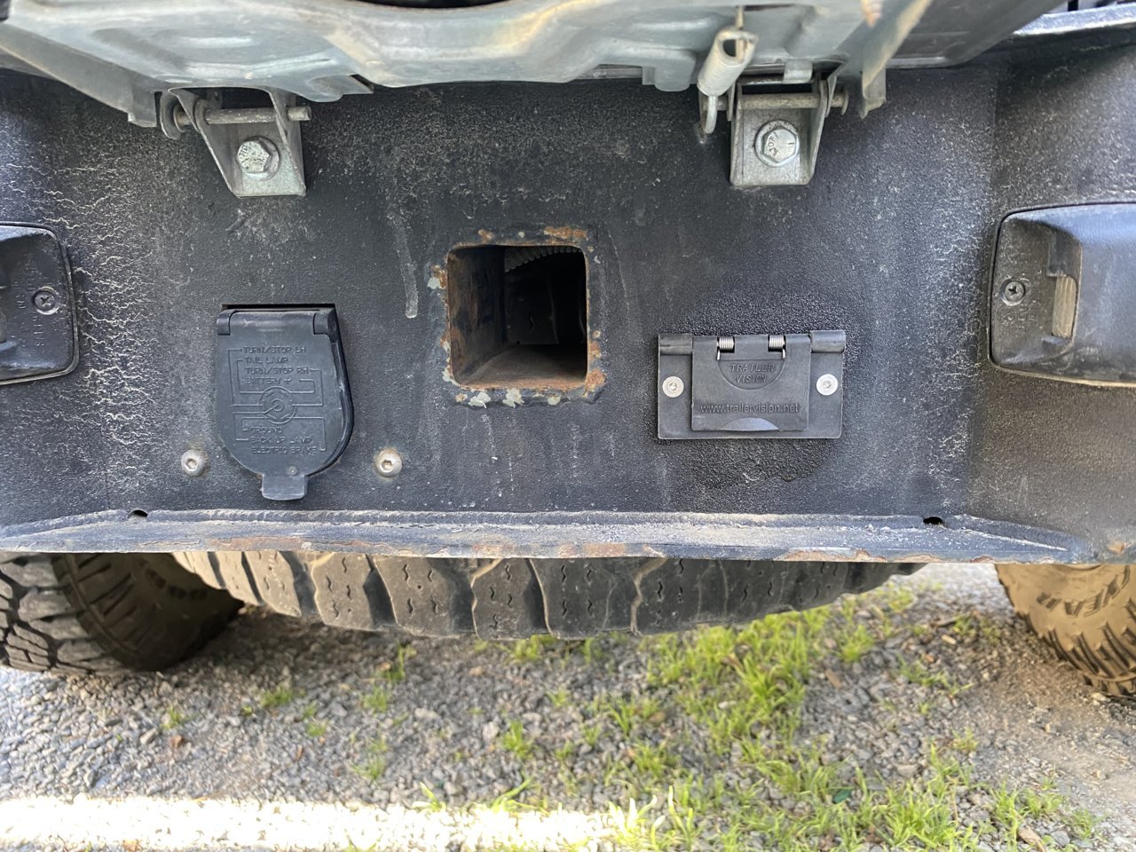

    Relocated the anderson plug from the top of the bumper to behind the license plate. Hacked it up a bit but function over form I suppose. Once the plug is installed you can't even see my sloppy work. One more reason to replace it with a @RelentlessFab high clearance rear at some point I suppose.
    It is a Trailer Vision plug cover that I ordered direct. The regular anderson plug is sandwiched in the housing and there's a rubber gasket where the wires enter. I finished it off with some electrical tape after snapping the pic.
    Not proud of this hack job but whatever. I used a dremel for the verticals cuts but there wasn't room to use it for the horizontal cuts so I had to use a 4" angle grinder. I was going to use a hacksaw to finish the cuts and get clean corners but it wa slow going and I got impatient so I cut a bit more with the angle grinder knowing that it would be covered with the completed install.
    When I picked up the trailer in Oklahoma I didn't know that it only charged via an anderson plug when towing and not off the 7-pin so I had them install an anderson. They fished the plug through the opening to lower the under-bed spare, blocking access so you had to get under the truck to lower the tire, and it was a pain to plug in.
