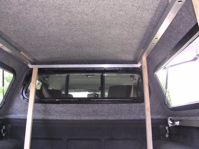

    Trying to visualize it all but it seems that supports going to the bed floor (instead of bed rails as I've seen others do) is the best option to keep the weight off the bedsides. Not sure what material I should use either but weight is a factor for me.
    As much as I'd like to tackle this myself, I may be better off seeing if this is something @RelentlessFab could put together for me if I do move forward with an RTT.

    80/20 bar would be a super easy option for a no weld sorta build. IMG_0663.jpgIMG_0664.jpgVertical supports as close to bed bolts as possible with a good thick mounting plate. Tied to bed rail track only for lateral stability. But yes, I'm sure relentless could whip something up.

    Extruded aluminum. Stand by for more info.

    Yep. https://www.tslots.com/ This is the best site I've come across for purchasing. image.jpgIt's the same stuff as the crossbars in a Prinsu rack.

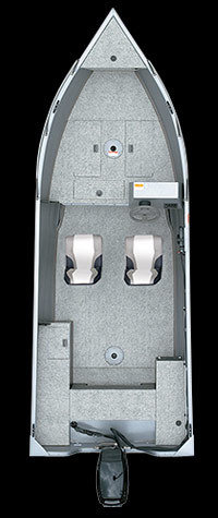

    Started stacking cash for a supercharger and went and spent it again on something else.....at least it wasn't a furnace this time and it'll add another 30hp to the fleet
    Stoked to be picking up the new to me Crestliner in a week or two. All I have is the manufacturer product shot...didn't take any pics when I was looking at it and the ad has already been deleted.

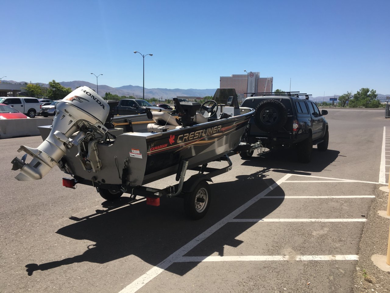

    Visually it has way more effect than the supercharger would have, but not quite the same power wise.
