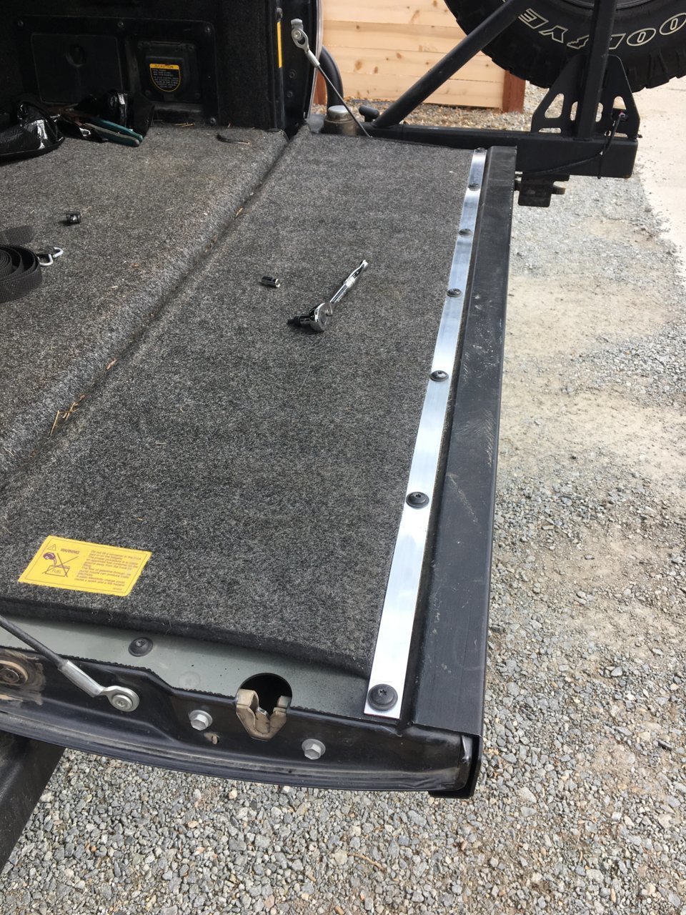

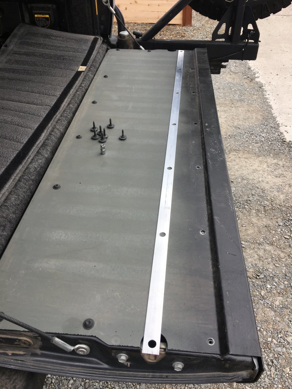

    With a little bit of aluminum and a few minutes at the drill press, I was finally able to clean up the way the bedrug sits with the @RelentlessFab tailgate skin. The plastic tailgate cap that I removed used to cover the edge of the bedrug so I needed a solution to keep the rug from getting snagged on things when sliding them in and out of the bed and this seems to do the trick.
    When the weather warms up I'll have to pull the tailgate skin and get some bedliner on the sections of exposed primer.

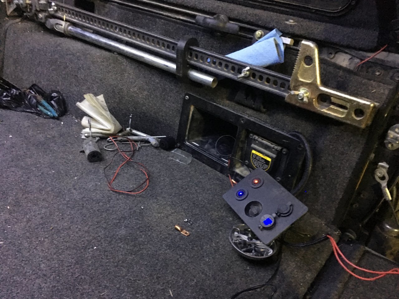

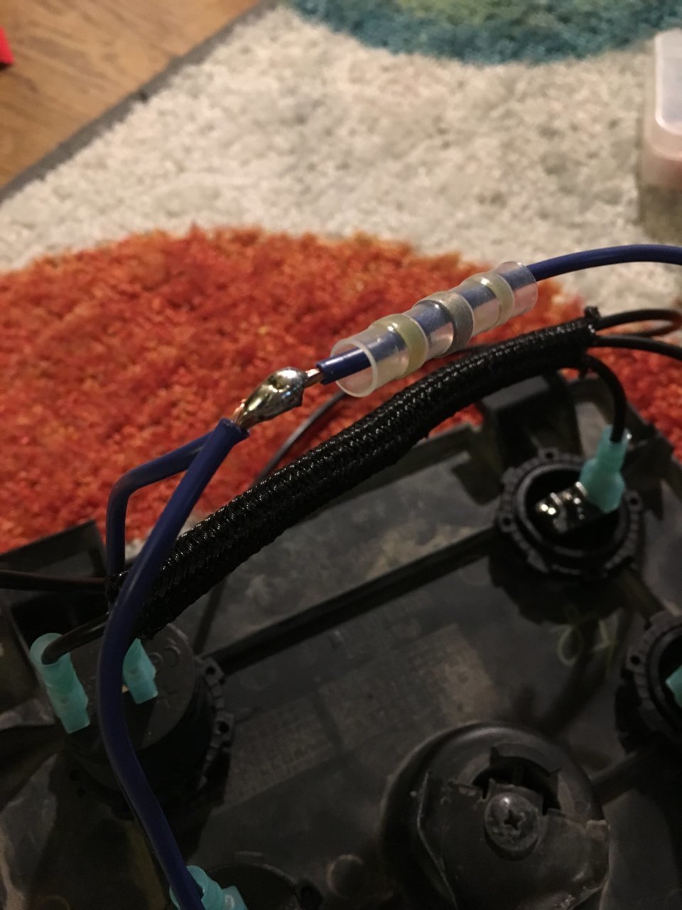

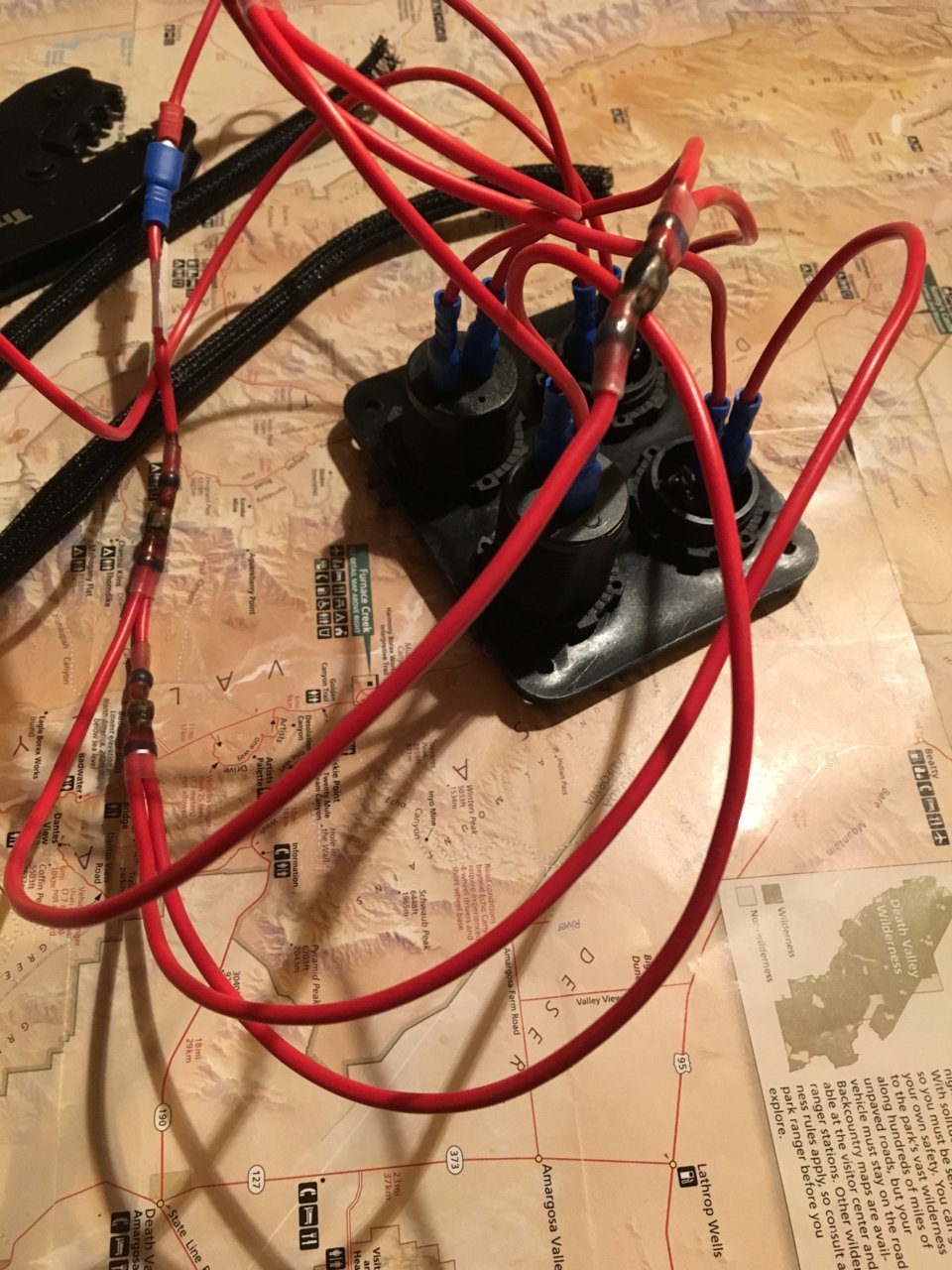

    Soon to have always hot power to the bed. Will run a second fuse panel in the bed that will get constant power with a main switch. The main switch will get power to bed lights (on a second switch), 12v cig plug, a high output USB charger, and a volt/amp meter.
    Only had enough red wire and didn't feel like running out to get other wire colors. Odds that I burn it to the ground?

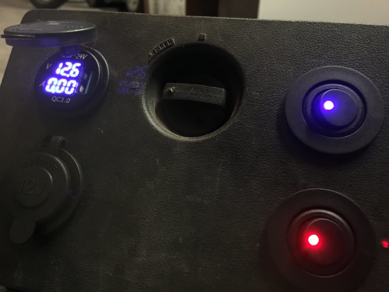

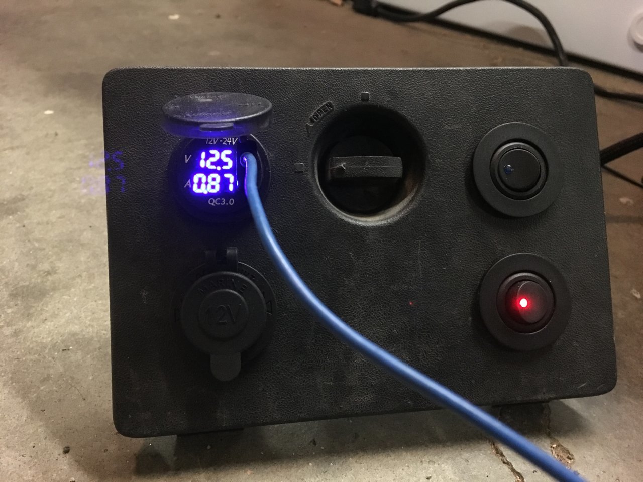

    Worked as intended so I cleaned everything up tonight. Just need to run the power back to the bed this weekend.

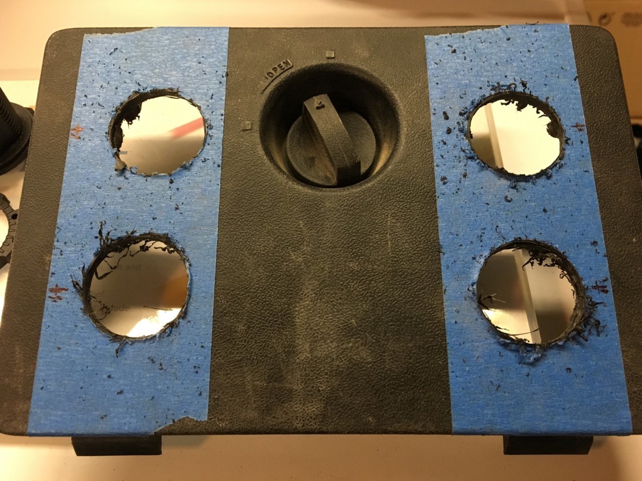

    Cutting holes in your vehicle is easier when you know you can replace the part easily if you fuck up and you can tell I don't solder much but it's easy enough to hide that.

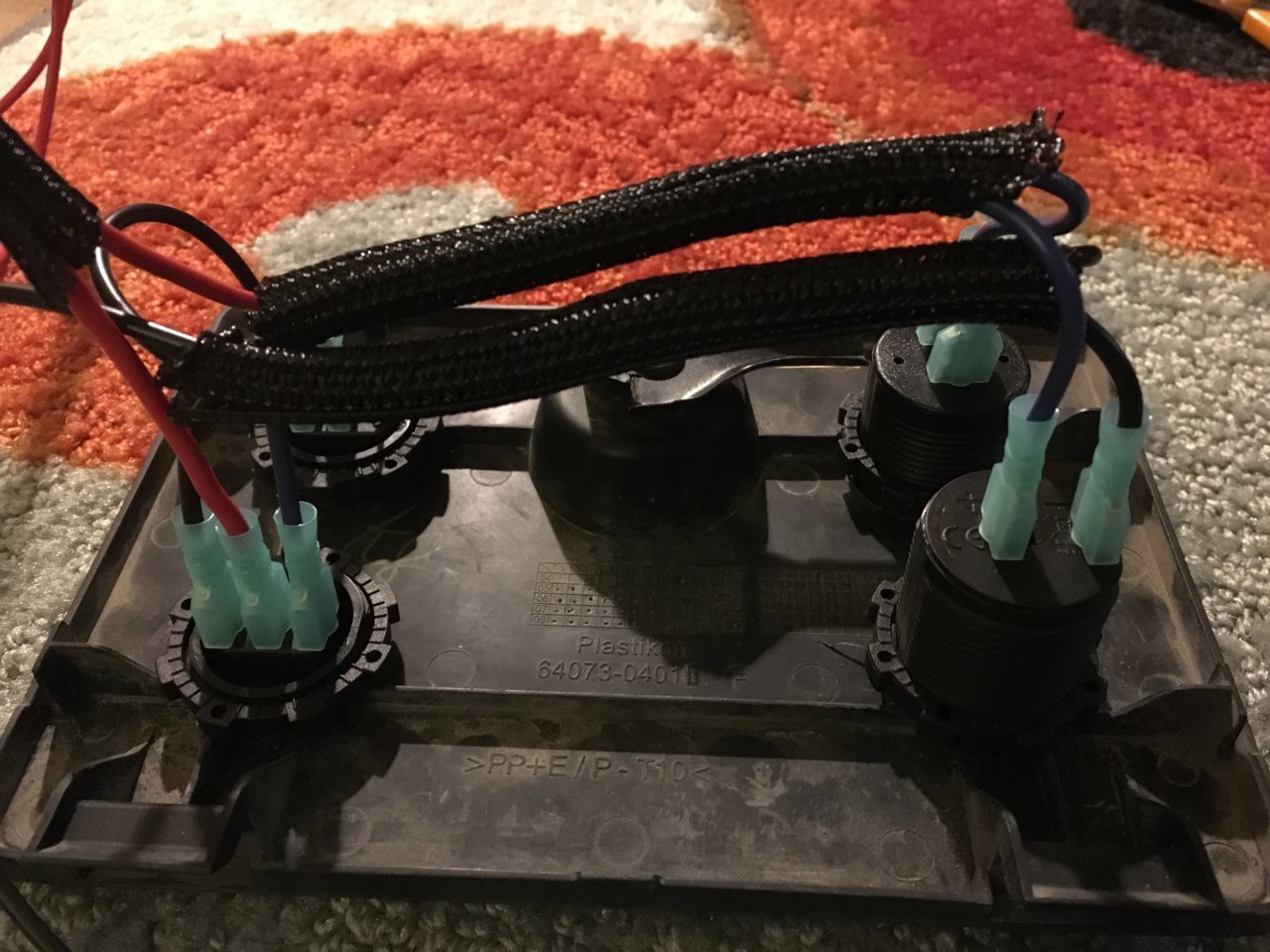

    Fuse panel will be mounted in the cubby behind this cover. The 12V and usb chargers are powered by the red switch and the blue switch will power lights in the shell. I have 2 circuits left on the fuse block I bought that will power a compressor for onboard air and a fridge (I'll add a second 12V in the space under the latch when that time comes).

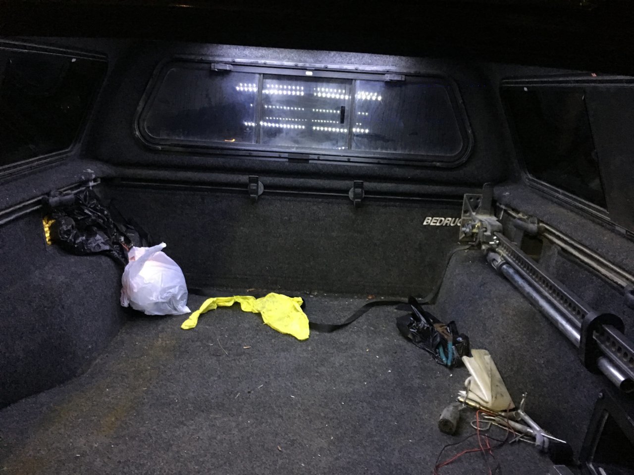

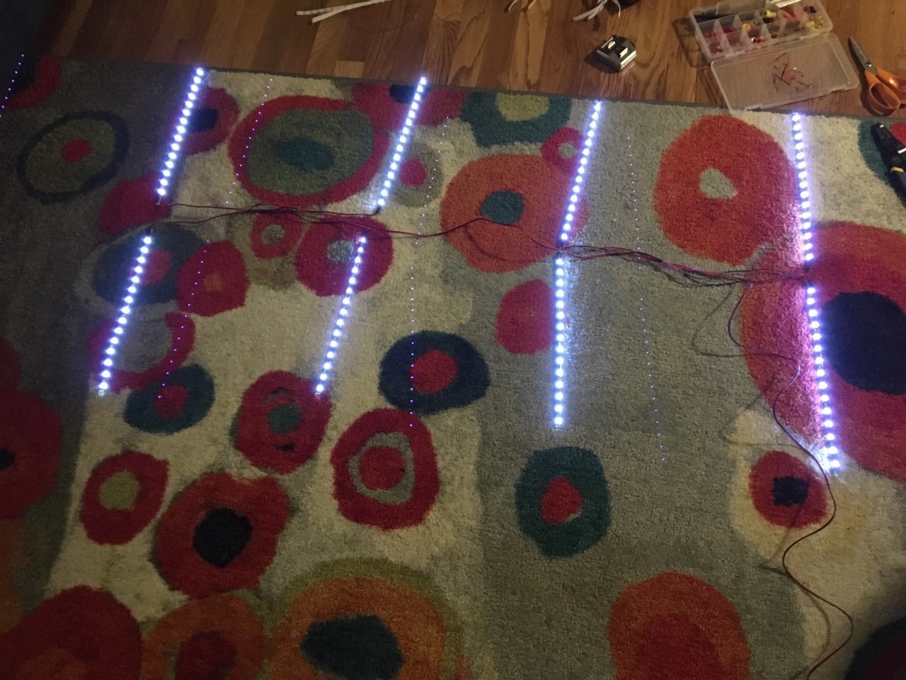

    Laid out the wiring for the LED lighting for inside the camper shell. LED strips will be attached to the headliner on the shell with adhesive backed Velcro and the wiring will be held up with dual sided Velcro.
    Now I'm just waiting for the last few pieces I need to wrap this all up...fingers crossed for delivery Saturday.

    Ran 6awg wiring to the bed and got the wiring pulled into the cubby and installed the LEDs on the headliner. While I was under the truck I greased and retorqued the u-joints and greased the ball joints on the upper control arms.
    I went nascar and used duct tape to seal the openings the cubby had in the wheel well to hopefully minimize the amount of water and dirt that gets in there.
    Then I tested everything again and it's working as planned. Tomorrow I need to install a breaker and clean up some of the crimps then get the lightbar up front sorted. I installed the lightbar but the brackets don't have enough adjustment so it is not aimed right. If I can get that aimed right I have the wrap up the wiring on it as well.
    Been slow going but I'm happy with how it's coming together. The light output is great...
    It's daytime bright back here now

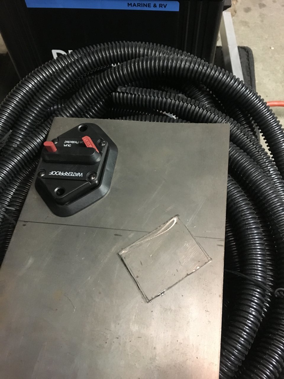

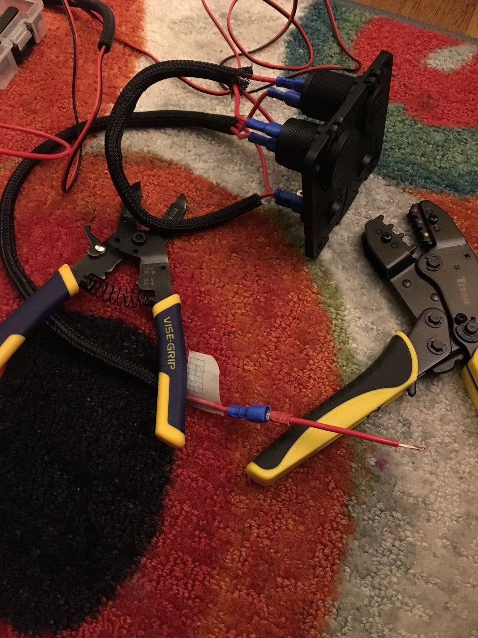

    Not as much progress tonight but had a couple "it's all about the right tool" moments.
    I'll need another project to make this $30 tool pay for itself but if you need to crimp large wire these will get it done. There were several options in the $150-200 range that are probably easier to use but for 6 crimps on 6 AWG wire these did fine.
    Also used the dremel to cut a hole in this for the rear power circuit breaker...not the right tool for the job but it worked. I burned through 2 blades. One more cut on it tomorrow then some time at the drill press setting it up to hold relays and a fuse panel along with the circuit breaker. Hope to have time to paint it tomorrow so I can mount it Thursday. This will likely be temporary and I'll see if @RelentlessFab has time to put something cleaner together.
