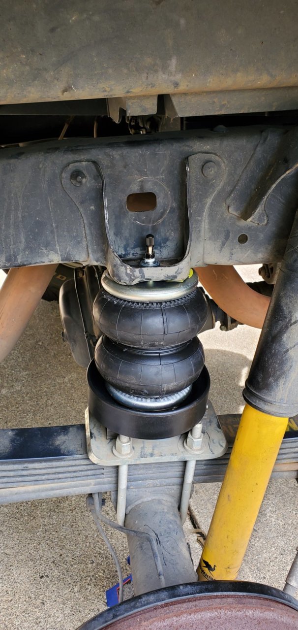

    I'll second airbags (with daystar cradles). I bought HD OME leafs and they were sagging less than a year later with less weight on the truck than they are rated for. Added airbags and the ride and load capability instantly improved. I can adjust for towing and load weights easily and the truck rides so much better.
    I went with the Riderite kit from Firestone, but should have just ordered the bags by themselves as I ended up not using any of their brackets. I mounted them to the stock bump stock landing on the frame and made a bracket to mount on top of my ubolt flip kit to hold the Daystar cradle:
